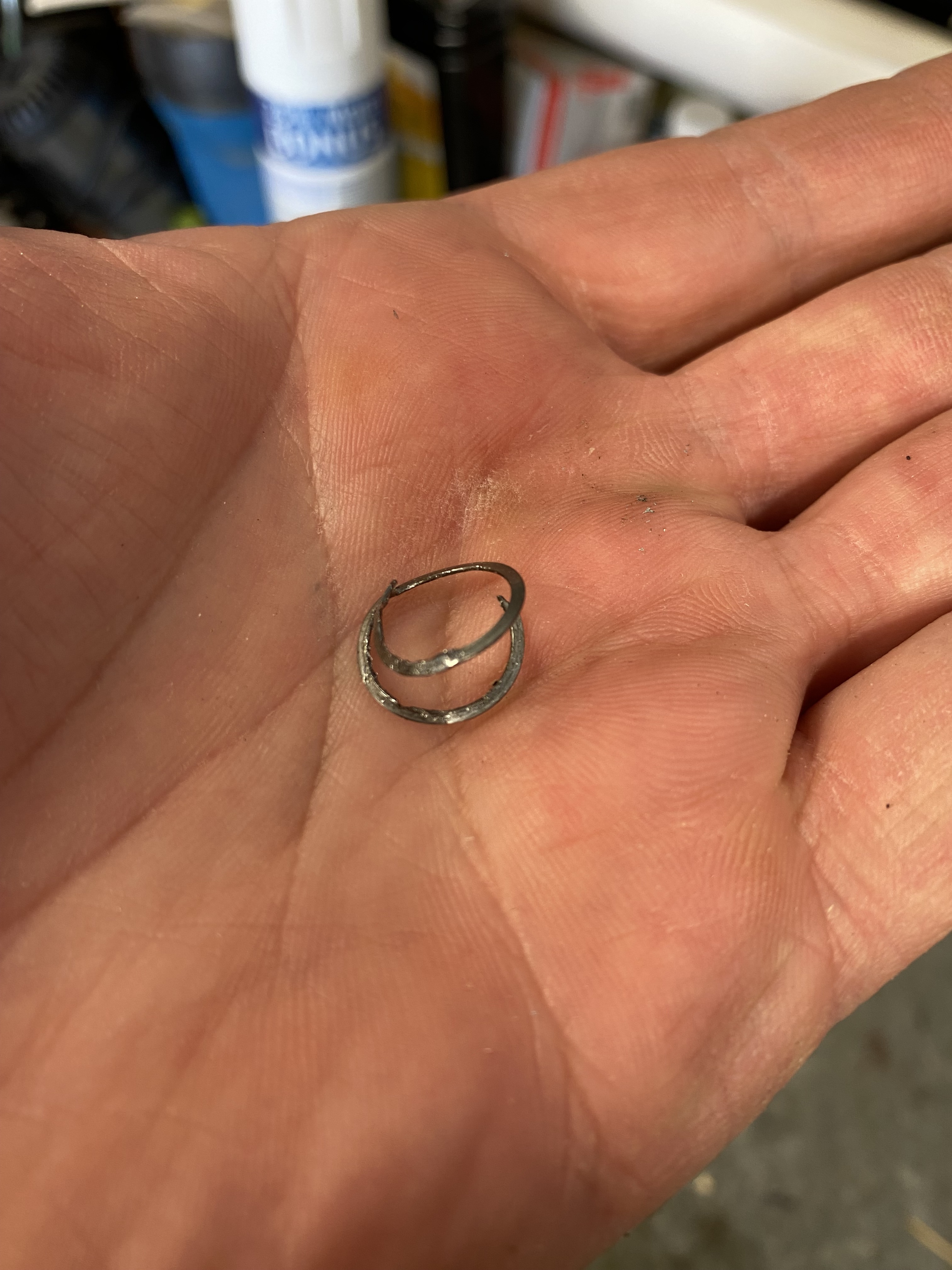

                I wrestled with the ring in the valve body and could not get that sucker out. I am putting my hope that it’s inside the valve and just ordered a complete valve body assembly to replace this one.

                  I'd expect it to be the urethane orings on the valve seat and plug, the cup seal is almost always fine unless it's an ex rental. If you use a dowel to depress the brass plug and put a toothpick in the air intake hole to hold it back it's much easier to get the ring off. Then replace with a 1/2" snap ring

                  Toestr thanks I did have it in the vise and the plug depressed but man that ring is really in there. I said a few choice words and then said F&*K it and saw a new old stock Valve assembly on EBay and bought it.

                For science I will destroy this Valve just to get inside and see what the failure is

                  You need snap-ring pliers or two picks.

                    Yeah the old flat machine springs sometimes don’t want to budge even if your technique is good. I’ve used a dremel attachment to cut them out before, maybe nicking the valve body in the process and still using it :-) Once it’s out you can use and internal snap ring and then snap ring pliers make future work easy

                      Old Tippmanns didn’t use snap rings they used a pain in the butt flat machine spring that wasn’t supposed to be user serviceable. As someone stated above, you can remove the airline, depress the valve pin, shove a toothpick in the airline port to hold the spring tension, and then try and work it out. I’ve had the best luck getting a utility blade knife (angled box cutter razor blade) under the edge of the flat spring and then working it out. If it starts spinning I’ve had to just cut them out. :-0

                        I use a small screwdriver to hold the bottom end of the ring if it starts spinning.

                        I use this method, works like a charm every time.

                      Well I wrestled that stupid thing out of there
                        Carp commented
                        I have never removed one of those without drawing my blood first....😂
