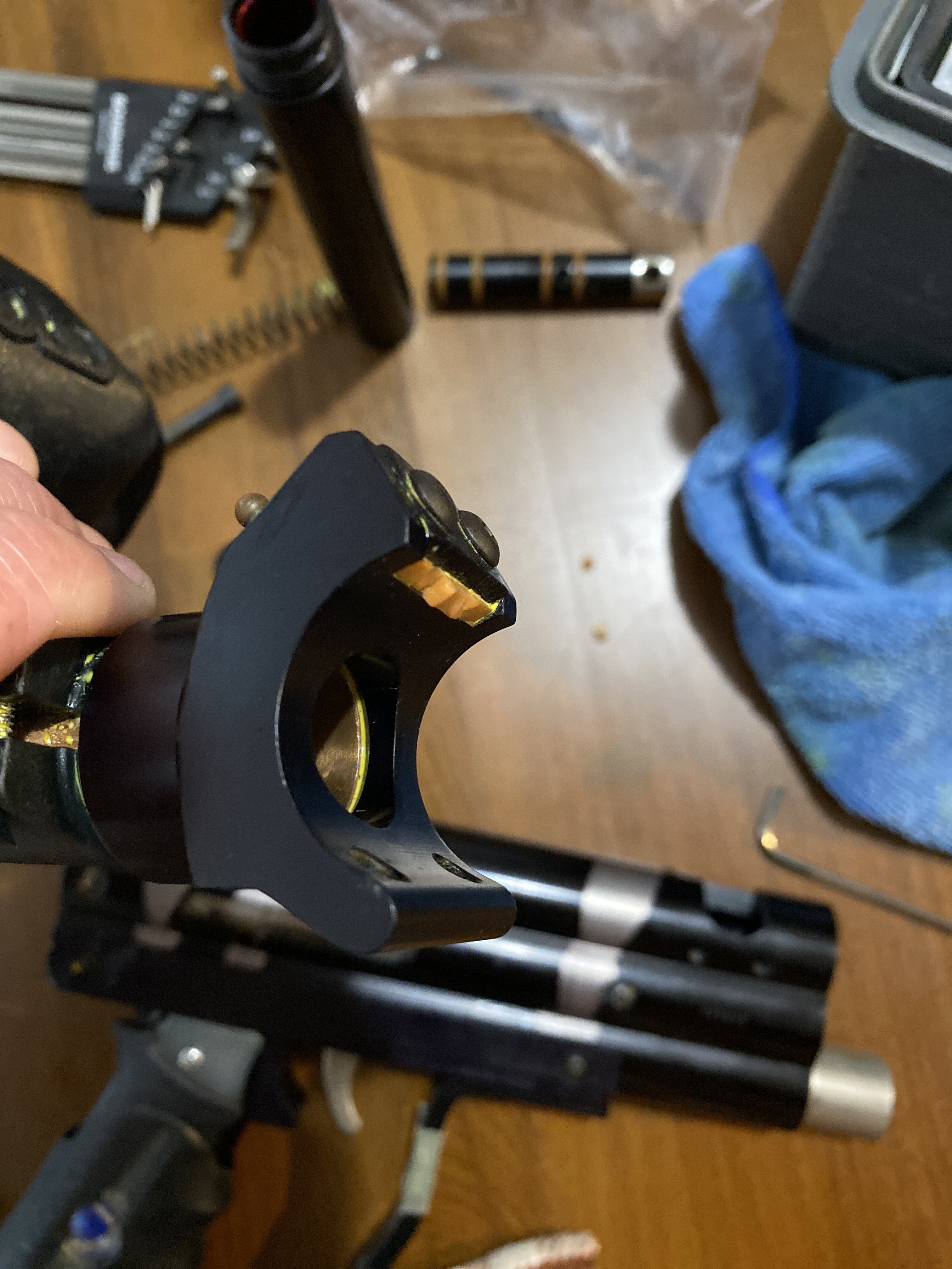

    My VM was a lil brutal on paint. Just snagged a new Venturi bolt that should help. But my detents are shot. What options do I have? I’m sure I could hand cut some but mine are so bad I don’t have the dimensions. I know some users have made some. Anyone print them with success? How do these things actually work it’s not like they enter the breach. I’m running a cocker laser cut detent between the body and barrel that worked great on my VM but I was clipping balls in the neck. Paint was a lil brittle for a blow back at the temp I was shooting it at. But I would like to enhance the performance as best I can and make it as useable as possible because it was a ton of fun to shoot.
    Also I’m thinking of adding some more volume with an expansion chamber see if I can make it a lil softer on paint.

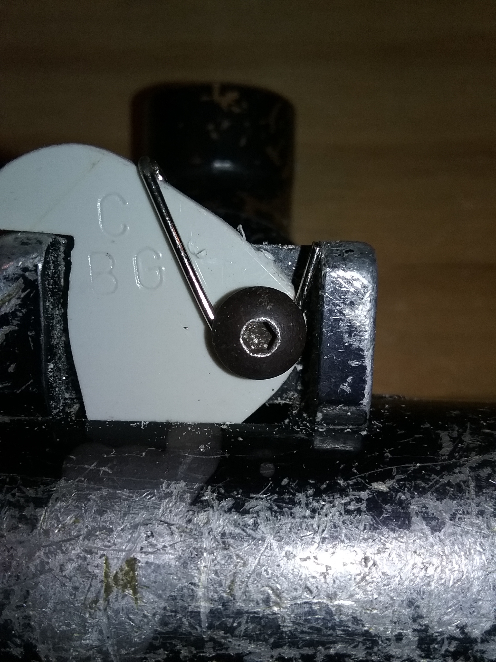

      • BretG
        • 714
        This is the Charm. They have been in use for about 5 years or so and I've sent them to people all over. They really do work perfectly as a permanent replacement for the fingers.

          The last ball detent you'll ever need for the VM

          BretG - same old story; VM68 was my first marker in ‘95, now on a mission to resurrect one. Your charm detent seems to be the hands down favorite. Would you happen to have any left? Appreciate your time; thanks!

          You can't do 3d printed ones for it, I had good luck with the Freedummy ones on here. However, I highly recommend BretG's Charm detent.... You'll never need another detent after installing one of them
