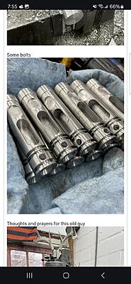

      Here's a pic from netsurferdude2 showing the space where the sliding lug sled goes on the centerfire bolts. Everything past the double o-ring setup is extra length thay isn't there on the stock bolt.

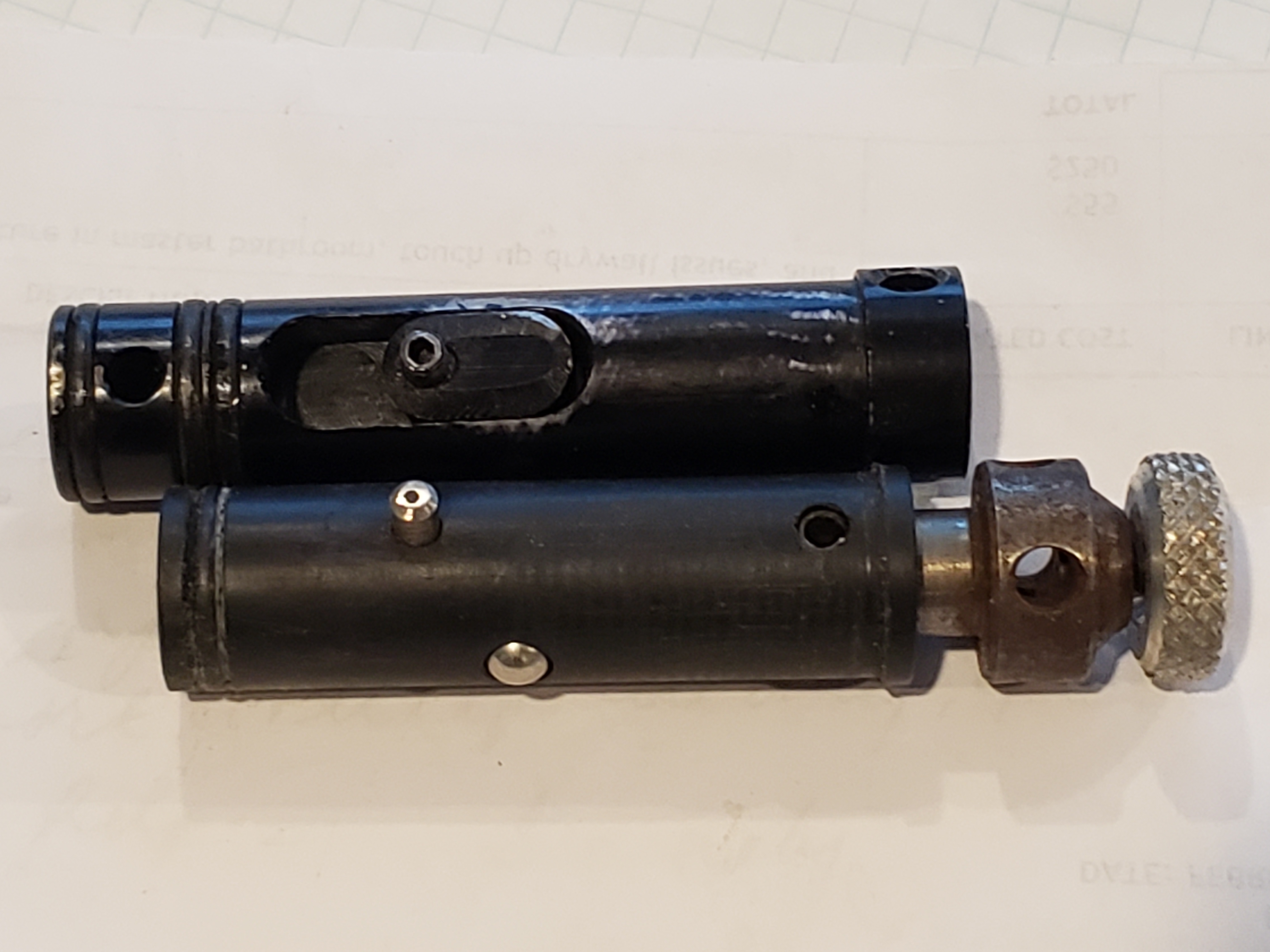

        as others have said, centerline can be easier on brittle paint vs. rimfire, here's a comparison with a general Joe's centerfire on top & cooper-t locking rimfire on the bottom
