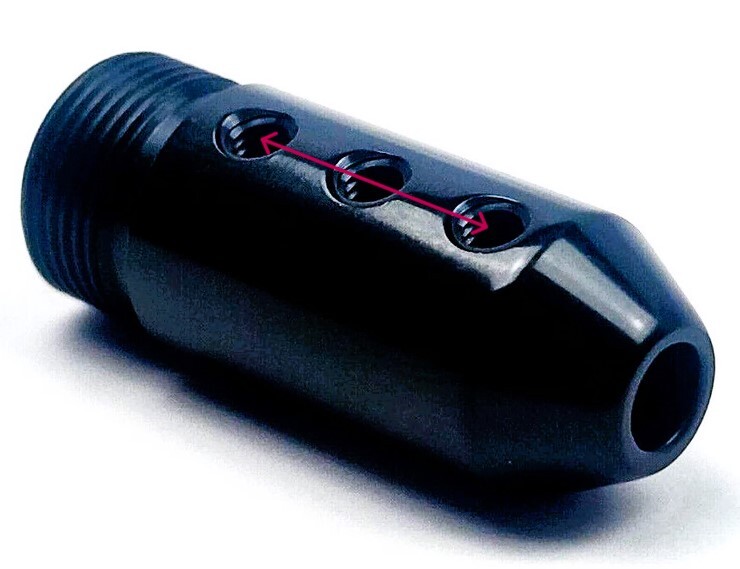

    Can an owner of a CCM/Works 3way please measure the distance between the the center of the orings on the 3way spool? It would also be appreciated you could measure the distance between the front an rear barbs as well. I'm wondering if any of my random assortment of 3way spools might work for a CCM 3way body.

      This version good sir! Unsure which it is. There are two versions listed on Pbase but I cannot tell the different between them besides the first version being gloss and the second being dust lol The tapered portion on the front of the 'new' version might be a tad longer?
      https://pbase.com/k_macocker/image/72634908
      https://pbase.com/k_macocker/image/92406361

          It's all good bud, I appreciate ya looking for me. I found the same 3way body as above for $15 and was curious if I should give it a try. But it looks like the oring spacing is somewhere between WGP 2k+ stock and Belsales, doubt it would work but figured I'd ask.. I still might buy it. Worst case scenario I gift it to a member whose Works 3way is afflicted with idiot marks lol

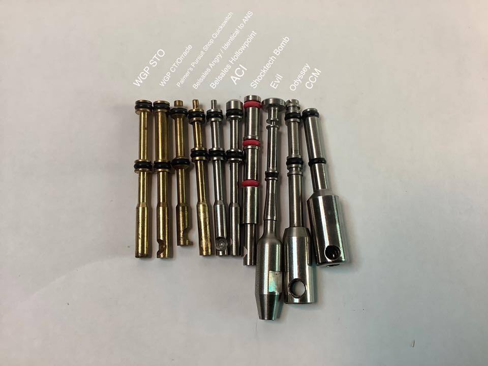

        Ans works, but reduces your timing window. the CCM is slightly wider than ANS/belsales/kapp. You could use a shocktech and take off the last oring.
        Measurement of the inner spacing between orings.
        ccm - .439”
        belsales - .334”
        ans - .334”
        kapp - .334”
        shocktech - .336”
        wgp - .531”

          ANS spacing, same as belsales. I'll go double check just in case
          Found this pic and they look different. But unsure if the stem in this pic corresponds to the 3way I posted since they could be different generations.
