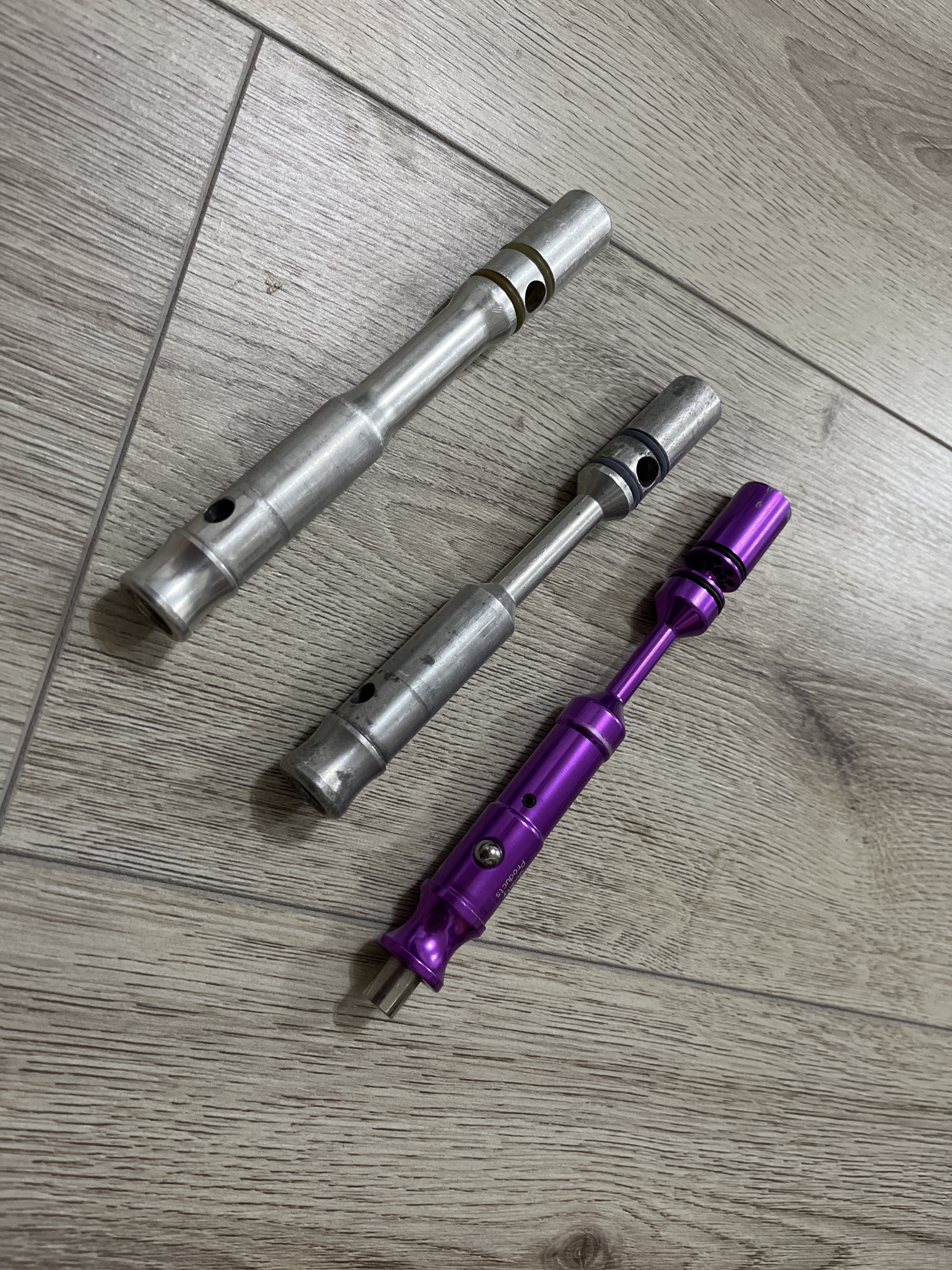

    Hello again experts,
    Just wondering if there is really a difference between a standard WGP bolt, versus something like a shocktech or inception bolt? I know weight factors, but besides that what benefits would I get out of an aftermarket bolt.

    Swap bolts at the chrono station and see for yourself, velocity change = there are differences

    Is there a difference? Yes
    Which is better? Only ask that question if you are willing to open Pandora's box, a can of worms and a barrel of monkeys at the same time.

      I think the venturi bolts tend to be quieter. Delrin with out o-rings tend to slide a bit easier and reduce cocking pressure or smooth out a pump stroke. O-rings tend to help reduce blowback up the feed tube. Ball detent groove smooths out a pump stroke. Smooth flow path helps efficiency (see chrony test listed in previous post). Lighter weight reduces "kick."
      What are you looking to gain? There may be a bolt out there that has what you are looking for.

          Of the three you got. I dont think youll see much difference. They all have o rings, so drag will be similar.
          To me, the difference comes when comparing o ring bolts vs non o ring bolts. It comes down to cycle smoothness vs efficiency. There a non o ring bolt, especially a delrin one will slide easier, offering a smooth pump stroke. This can lead to lighter lpr pressure in a mech, and or smoother pump stroke on a sniper build. I'll take the added drag for o rings on my bolts. It's just personal preference.

            The same set of o-rings will feel different in your breech depending on the bolt, not all bolts are the same size (with or without o-rings).

              kingman being kingman had some funky combinations over the years as well.
              full delrin without o-rings
              full delrin with o-rings
              half aluminum, half delrin without o-rings
              half aluminum, half delrin with o-rings.
              full delrin without o-rings but with a spring.
              and then almost each of these combination could be had with our without venturi's.
              most of these were stock but some were aftermarket
              i think it comes down to marketing and what people will buy as well as physical differences with theoretical effects.

                As k_obeastly pointed out, on my autocockers and snipers a venturi face is noticeably quieter.
                You can try chrono swapping them to see which is more efficient but as I understand it this only tells part of the story regarding efficiency

                    I think alot of that had to do with the actual bolt fit to the bore. It is much easier to control the fit when your cutting the bolt for the specific marker than producing for all markers. Perfect example is inception includes multiple orings in their kit so that the fit can be adjusted.

                  There are differences, absolutely. Everyone with a lathe in the late 90s was making some sort of special bolt. They all had to be different. There must be 200 of them.
                  Does it matter at all? No. Unless someone screwed something up really bad they’re all the same. They will produce a difference in velocity at the chrono because they have difference amounts of restriction but assuming you’re doing to adjust the final velocity by additional means that difference is meaningless.
                  The largest meaningful difference would be reliability and feel. Some shrewd o-rings more than others. The delrin ones glide nice…but so does a well broken in stock WGP bolt.
                  Look at a CCM bolt. That’s as nuts as anything needs to be.

                    Angry Paintball has done countless tests on bolts and tbh the only real big difference is seen with his modded shocktech bolts other then that they all are kinda the same once you go aftermarket

                      I've recently been doing some bolt testing in my sniper. As many have said here, o-rings definitely help. A tight fitting bolt with 3 o-rings seems to yield the highest velocity/fps. Recently I compared a CCM bolt (no o-rings/loose fit) to an Angry O-ring modded bolt and there was a 50-60fps difference between the two. Yes the pump stroked was smoother with the CCM bolt but I'll personally take the performance bump.
