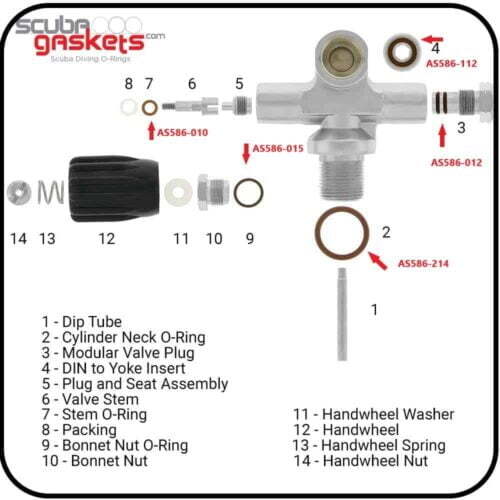

    I believe you are just missing Part #4 for a Blue Steel Valve:
      you are missing the piece that threads in that has a face seal. Looks like they make ones that the part unthreads. I bet that is pretty easy to find. see attached for reference.
      XS Scuba's Physical Vapor Deposition (PVD) Finish Pro Valve has the same type of long lasting finish you find on expensive faucets, high-end door lock sets and premium watches. PVD is not only a beautiful finish, but is also extremely durable. Before assembly the finished marine grade brass with triple bright chrome plating parts receive the PVD finish process. The parts are placed in a vacuum chamber, where a high power electric arc is discharged at the source material blasting away some into a highly ionized vapor which is deposited on the parts. XS Scuba's black colored PVD finish is accomplished with the use of Titanium Nitride. It provides the following advantages: Significantly harder exterior finish of 250 HV, a coating thickness of 0.2 to 0.3 micrometers, incredible resistance to salt water corrosion, increased scratch resistance and a very cool tech look".  Mil-Spec black PVD finish Standard yoke outlet with spin-out DIN insertconverts to 230 bar DIN outlet 3/4" - 14 NPSM standard inlet threads Clean for pre-blended Nitrox up to 40% oxygen 1.5 handwheel rotations from fully on to fully off  Dip tube included

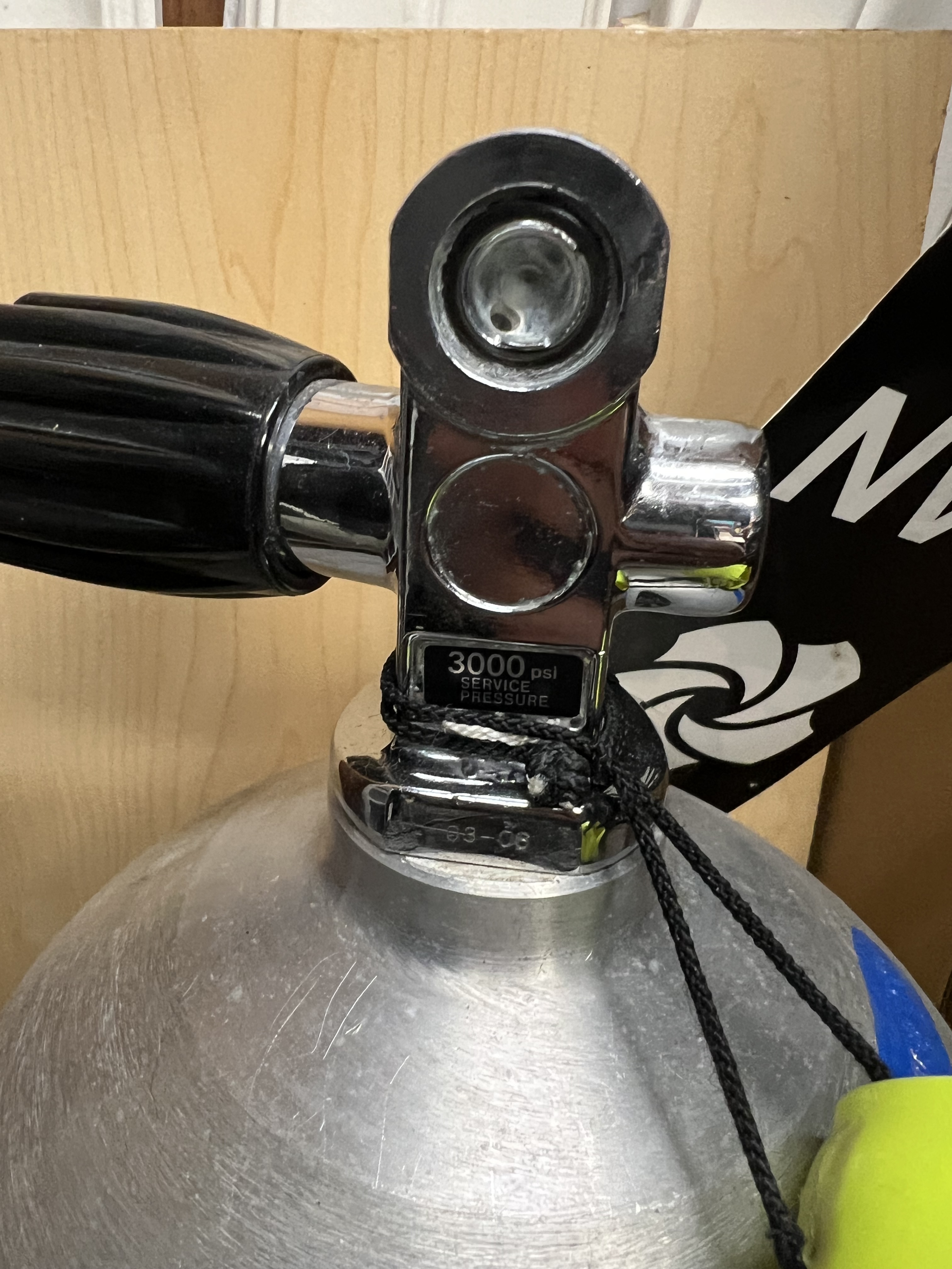

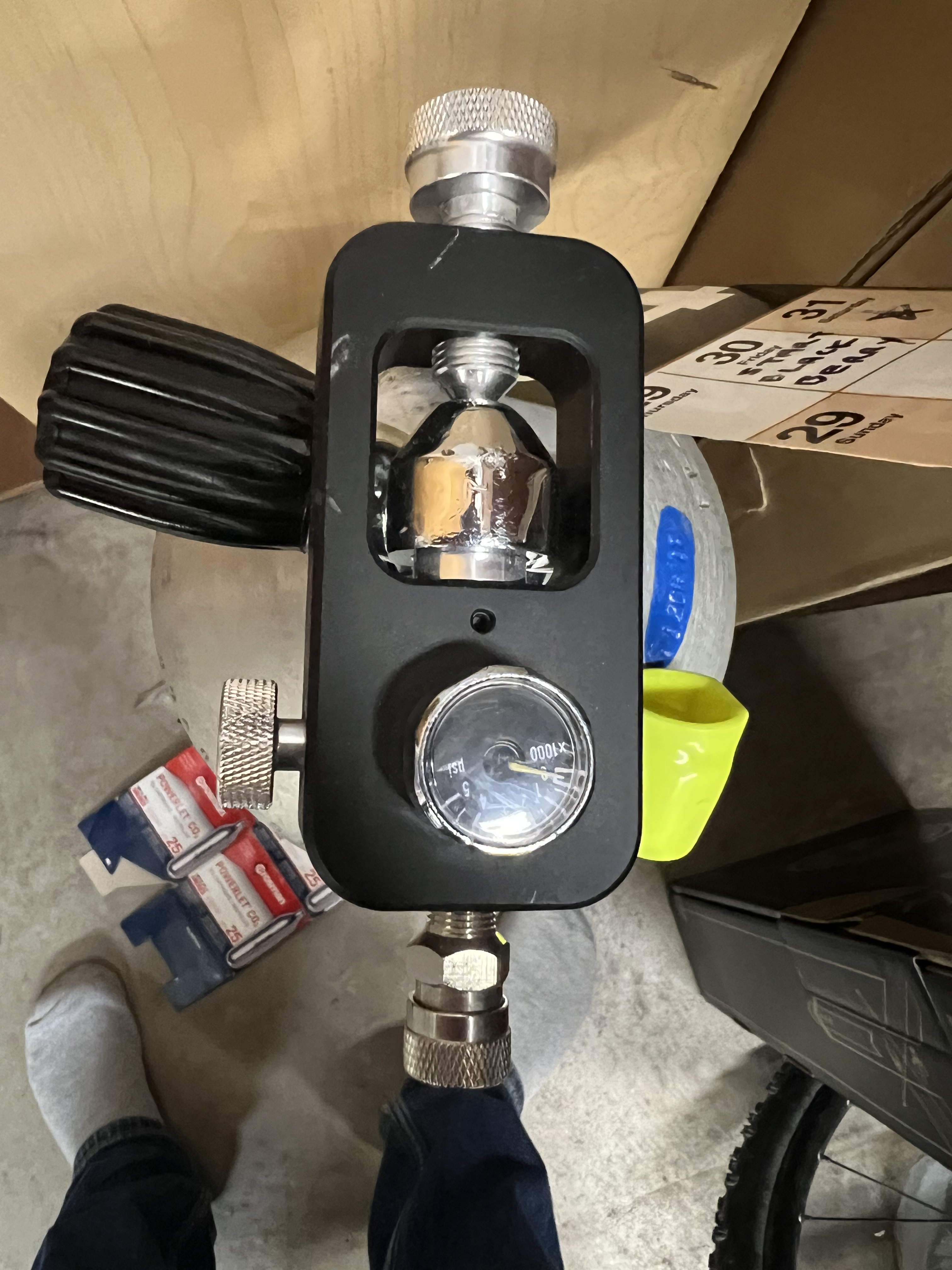

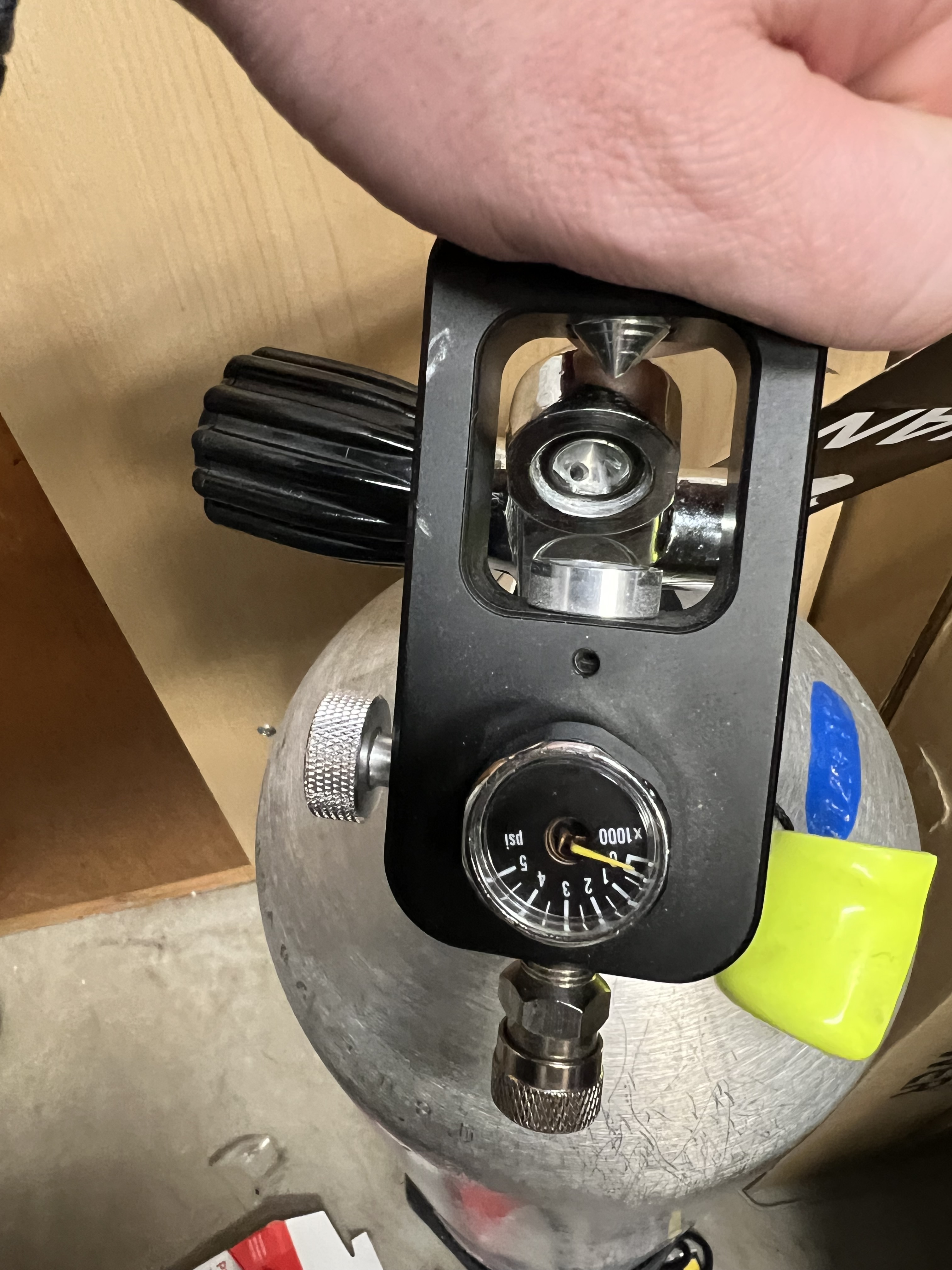

          Here’s some pictures of my setup for reference:
ID:	540712 Click image for larger version
ID:	540711 Click image for larger version
