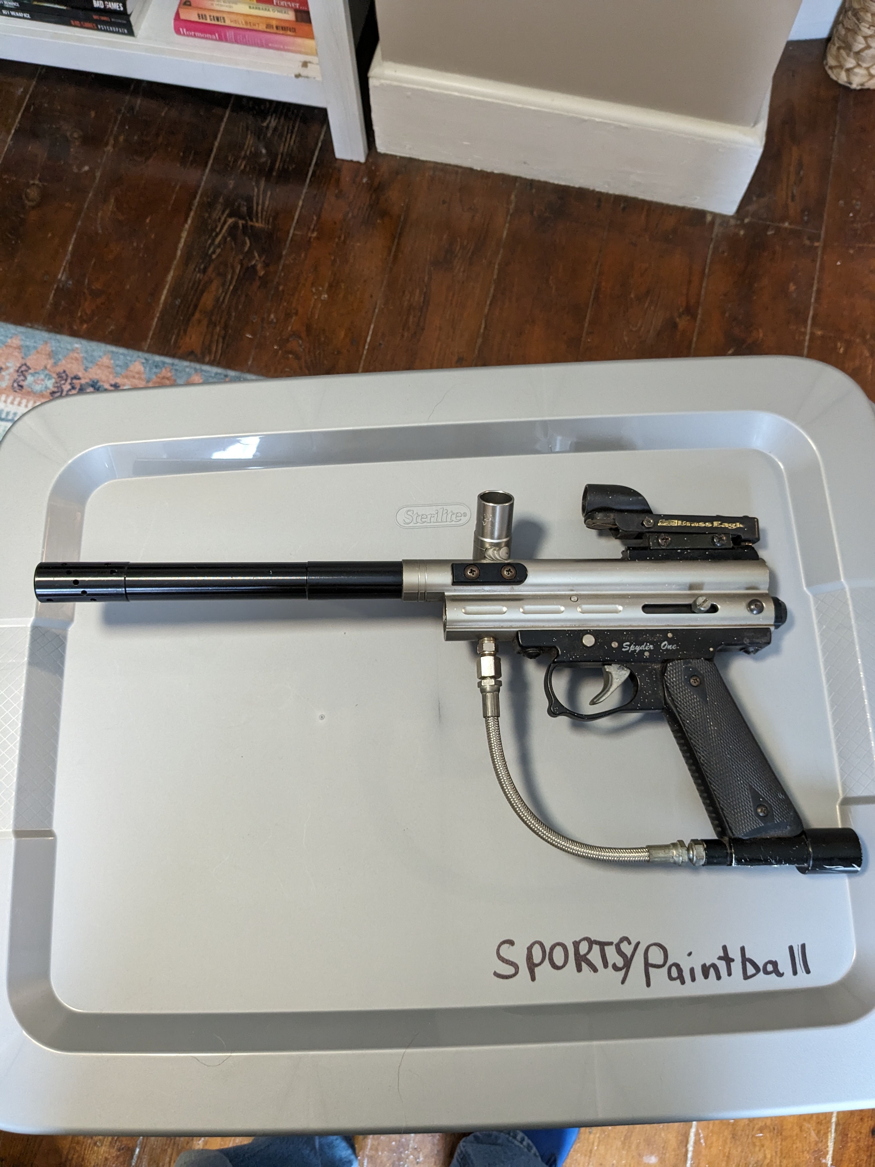

    Howdy, what universal o-ring rebuild kit do you guys recommend? Had a few oldies Spyder one, Sterling pump, and an Azodin KP3 I wanted to go through. What's a good set to buy that should have everything I need? Would rather buy 1 big kit than $10 for every specific marker for 6 o-rings a piece.
    Ps ​​Pretty sure the Spyder needs a cupseal are they pretty universal? Haven't taken one apart in a long time. Thanks in advance

    Reviewed the manuals for the 3 markers you mentioned, looks like a Spyder Deluxe Kit would handle most of the necessary o-rings. I would purchase a Spyder Kit to rebuild 5 times. All 3 of these use 015 multiple times,especially the Spyder could be 5 X 015 by itself, unless it has "Fatty" striker then it's a 016. Cup seal for the Spyder is fairly universal. your other 2 markers double up alot on specific sizes. I'd also buy a small bulk of 015 0-rings just as they would be the ones to likely fail from use over time. Review your manuals to confirm that a Spyder Deluxe o-ring kit would cover the smaller o-rings required for the KP3 and the Stirling. Hope this get you going in the right direction.

    Call me crazy but in the past if I needed an o ring or 2 I would see if I could find them in the plumbing section at Lowes, never had a problem with bad orings out if them either, but now I just order rebuild kits as I'm lazy

      Personally I would figure out what sizes/materials/hardnesses are needed and make a bulk order from theoringstore instead of buying rebuild kits at a markup.
      Cupseals will last a long time unless they're abused. Most of my oldies still have their originals.
