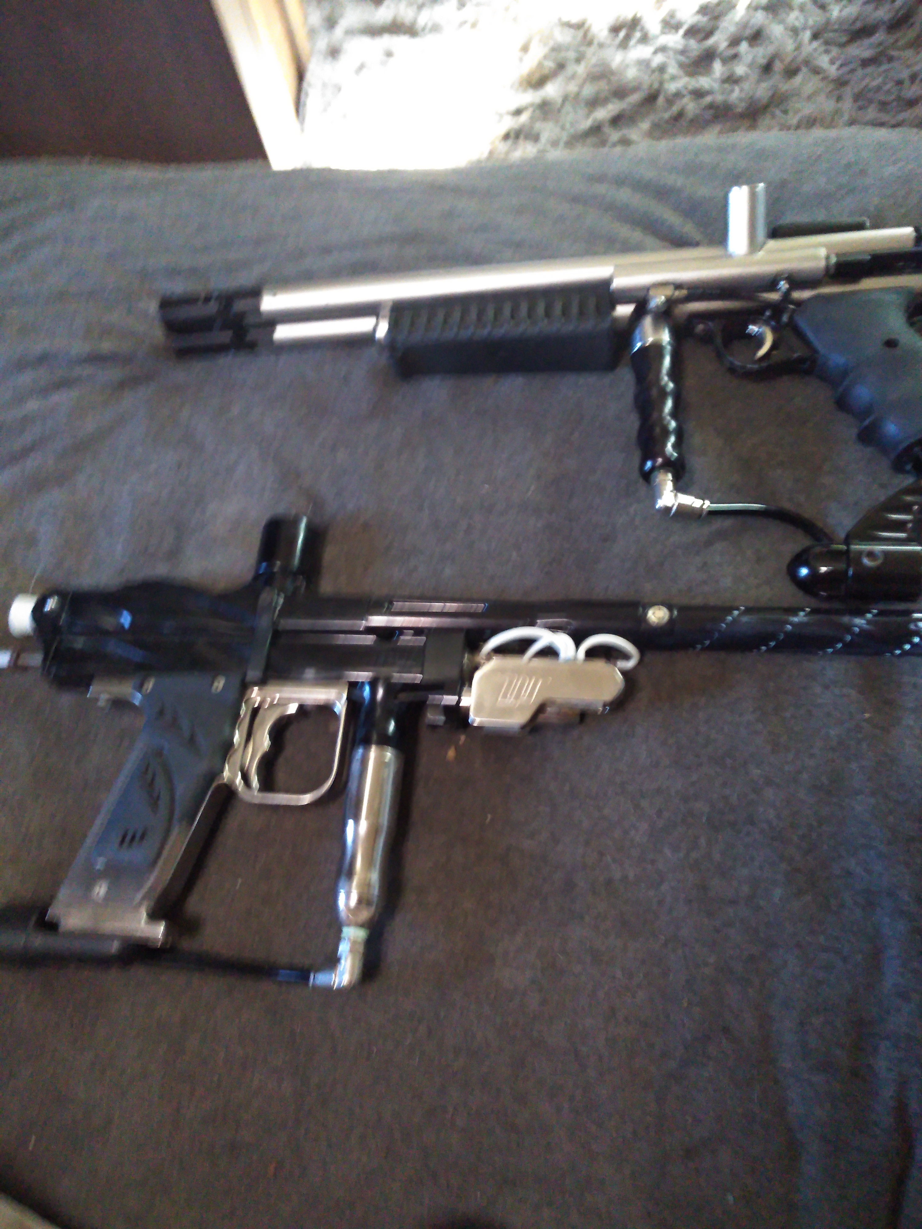

    Hey guys, Im not an autococker guy , can some one tell me if it's possible to throw an blade onto a typhoon and make her rip??? this is what I got

    Not bolt on no.... There's been a few electro typhoons but most using race frames

    I don’t see why you couldn’t get it to work. Definitely not bolt on. You will likely need two fast force fed hoppers on top of that thing to keep it fed. It won’t be easy to make it work but I’m sure you could.
      I. Am. Canadian. 🇨🇦
      • 3524
      First problem - grip frame spacing is different. Second problem - Typhoons don't have an adjustable hammer lug. Third problem - where to mount the 3way? Fourth problem - the Eblade is flat on top, the Typhoon is round on the bottom. Fifth problem - Palmer's detent setup doesn't tolerate being force-fed well.
      So, can it be done? Sure, if you have access to a machinist who knows what they're doing.

        Wow thanks man thats exactly what I wanted to hear. All the problems. Okay so since I was a little turd I always wanted one of these cause I saw a guy on you tube with one with a race frame and loaded
        Please with every ones expertise how did he build this marker like did he have to machine the bottom to make it flat to except the flat frame? Is a race frame flat? (I don't own a race fram yet...soon)
        I want to build this
        Also is it possible to freak bore then thread a cap to hold it in there?

        No, you can't freakbore it. And that Race frame Typhoon never got finished - he got it cycling ie: the ram moves back and forth, but the sear setup never got done. There was a writeup on MCB years ago on it.

        Also keep in mind you're going to be throwing a lot of money to modify something that likely will be using 20+ year old parts to make work.... Nevermind cutting up something custom that isn't mad anymore.
        You might just want to commission a double cocker body instead of cutting up a typhoon.
