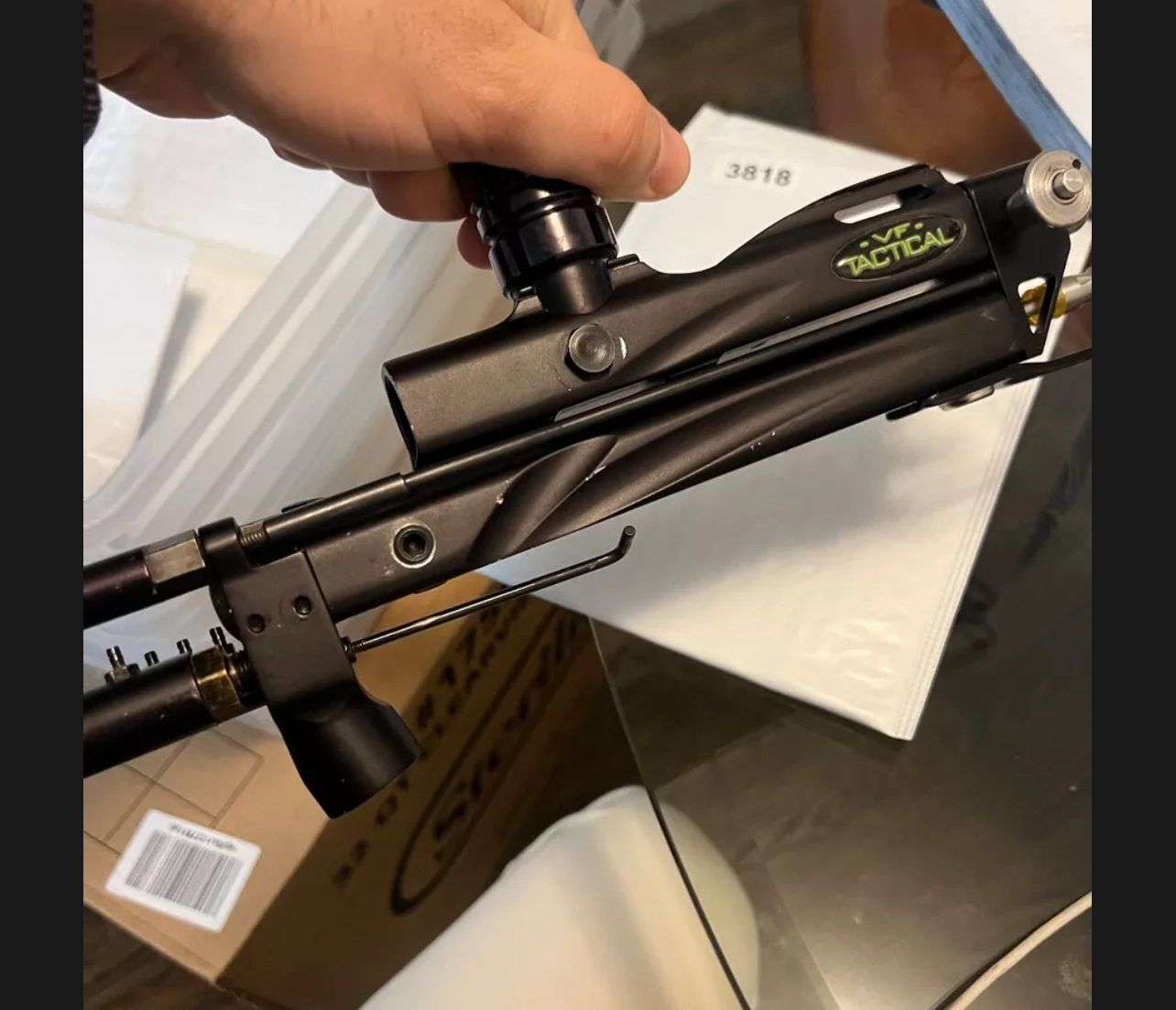

    Pump kit for wgp vf tactical.
    I’m considering doing a pump kit for a wgp vf tactical body, but I’m not entirely sure what kit I would need. Any suggestions? IMG_1518.jpg
    • 4456
    2k mini or extended reach

      2k+ extended reach

      • Reformed Boiler
        Reformed Boiler commented
        would I be able to use the front block, or would that look silly?
      • superman
        superman commented
        you will not. as the pump arm goes would go through the threads of the ram.
      • Reformed Boiler
        Oh I see the mini 2k kit replaces the front block, and I just need the extended reach because of the body type. Thanks yall.
