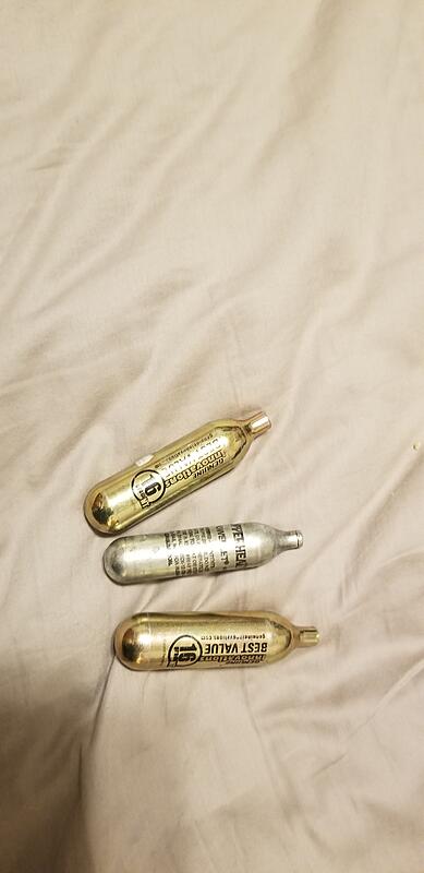

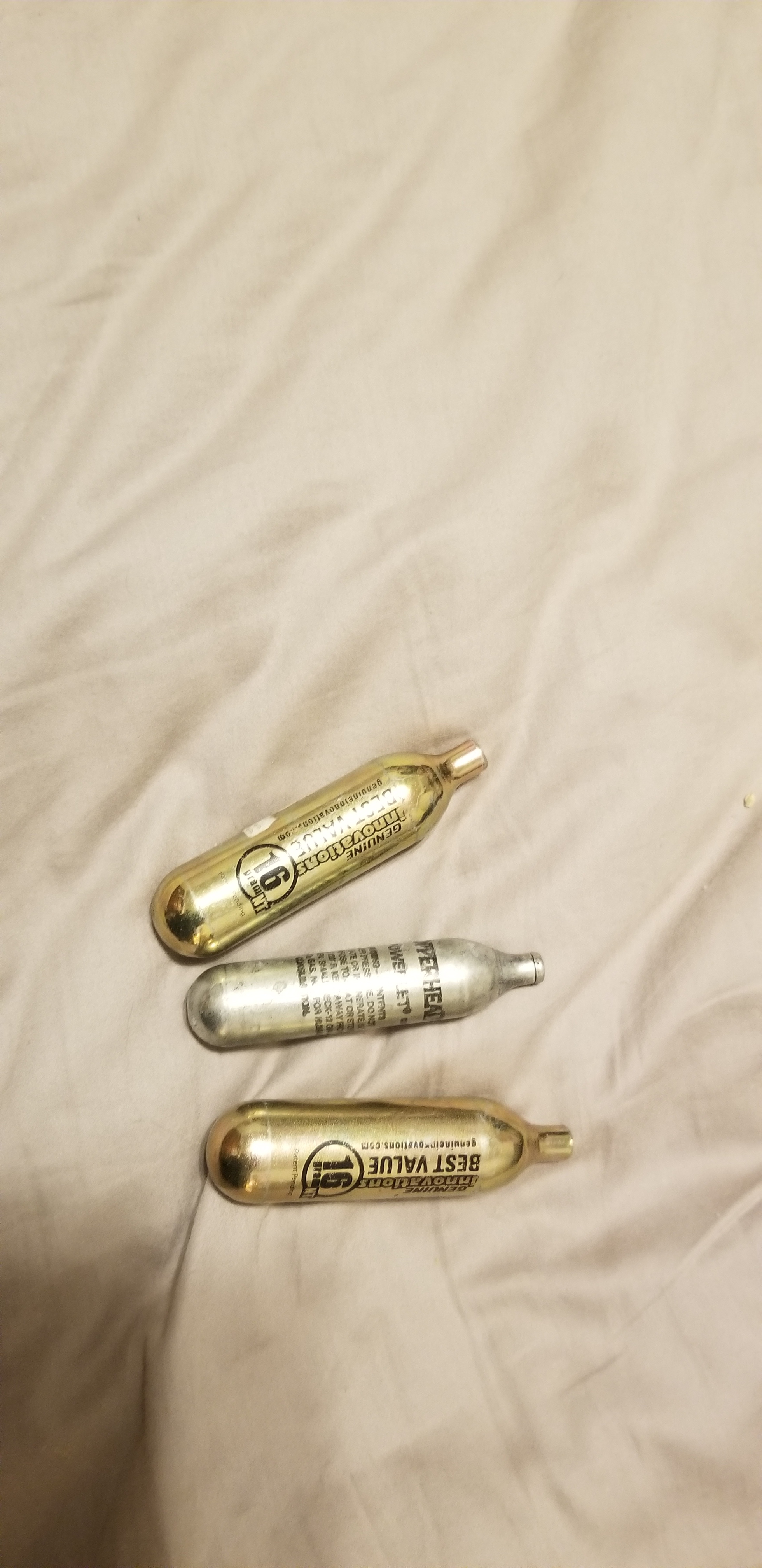

    So, recently I was given a collection of C02 cartridges by my parents, because they'd heard I'd gotten back into paintball and for some reason they knew that cartridges were used in the sport. Among them were some Crosman Powerlets (pictured), a couple of 8 gram soda fountain carts and these 16 gram monstrosities. I did not know these existed...so I did a bit of Google research and went down a loooong rabbit hole involving beer, bicycle-charging mechanisms, life-vest stuff etc.
    Apparently disposable C02 cartridges have a lot of applications I did not know about. Okay then.
    I'm curious...has anyone done a stock-class build with a 16-gram cartridge as the power behind it? Personally I'm kinda intrigued by them as they come in threaded and un-threaded versions and offer a measurably larger amount of C02. As the title says, has anyone on here messed with this?

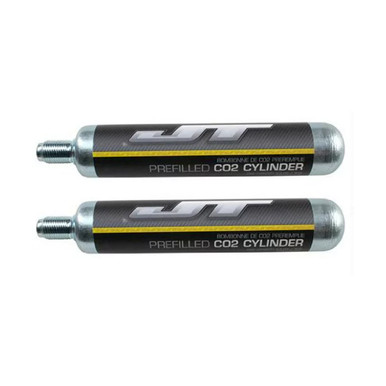

            there is always teh 90g JT tanks:
            https://badlandspaintball.com/jt-90g...nk-2-pack.html
            • Drunkscriblerian
              Drunkscriblerian commented
              Wow. At that point you are definitely into "just buy a refillable tank" territory. Those screw fittings also look mighty sus, if I was a field owner I wouldn't allow that.
