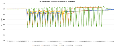

        Most tank regulators I’ve tested drop 100-175 psi before recharging. I agree if you’re at least 100 psi tank output higher than your HPR setting you’ll be fine, unless you’re looking to do extreme rates of fire.

          I always love some data. Is the x axis 1000ths of a second?
          It’s also interesting to see that you can actually see how some regs are slower responding like the green line HK there where it drops lower than anything else and then creeps over time.

          I was logging at a 1,000 hz, so yeah you’re correct. 1,000ths of a second.
