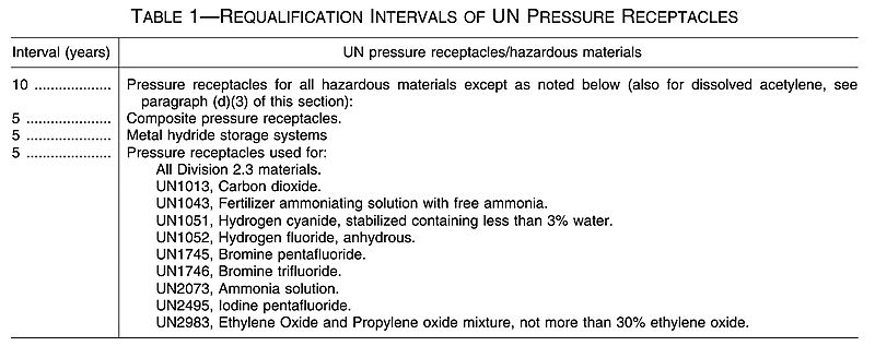

            It is not an ISO standard that they are actually referring to but an update to 49 CFR 180.207 Requirements for requalification of UN pressure receptacles. In the US we do not fall under UN pressure receptacle standards but the DOT regulations do reference them. As mentioned by SR_matt "Lifetime" = 38 years but the exemption no longer states "lifetime" and is clearly called out in 180.207 below as 15 years.
            Taking out of the latest version of the document on https://www.govinfo.gov/app/details/...0-209/context:
            §180.207 Requirements for requalification of UN pressure receptacles. (a) General. (1) Each UN pressure receptacle used for the transportation of hazardous materials must conform to the requirements prescribed in paragraphs (a), (b) and (d) in §180.205. (2) No pressure receptacle due for requalification may be filled with a hazardous material and offered for transportation in commerce unless that pressure receptacle has been successfully requalified and marked in accordance with this subpart. A pressure receptacle may be requalified at any time during or before the month and year that the requalification is due. However, a pressure receptacle filled before the requalification becomes due may remain in service until it is emptied. (3) No person may requalify a UN composite pressure receptacle for continued use beyond its 15-years authorized service life. A pressure receptacle with a specified service life may not be refilled and offered for transportation after its authorized service life has expired unless approval has been obtained in writing from the Associate Administrator. §180.207 tacle that is successfully requalified in accordance with the requirements specified in this section must be marked in accordance with §180.213. The requalification results must be recorded in accordance §180.215. (2) Each pressure receptacle that fails requalification must be rejected or condemned in accordance with the applicable ISO requalification standard. (b) Periodic requalification of UN pressure receptacles. (1) Each pressure recep(c) Requalification interval. Each UN pressure receptacle that becomes due for periodic requalification must be requalified at the interval specified in the following table:
