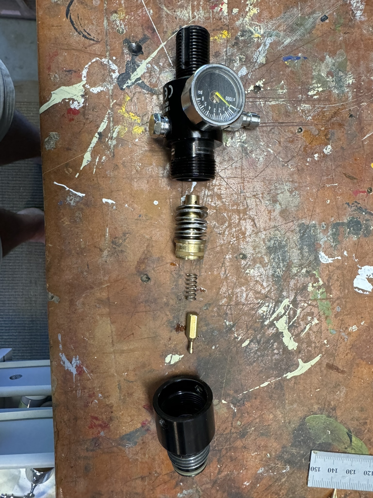

    no name reg adjustment
    I picked up a tank with what appears to be a generic reg for one of my kids guns - it was set to 800PSI. I'd like to dial it down for his new Mini GS - I know - it has an internal reg and does not care what you put on it, but I've never seen this no name reg and well..... if I can i will, curiosity killed the cat. what am i dealing with here? do i just take washer out and see what it does to lower pressure? don't touch it?

    Don't take one out, it will mess up the spacing too much. Try flipping one over and see what happens

      nice - Thanks Trbo that worked - flipped the top and bottom washers and got down to 550 from 800 - those were the obvius ones - suppose i could go further - but... it works and its better than 800, so i'll call it a win

        There are limits to that trick. If you go too far the piston no longer has room to move
