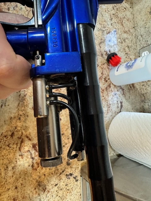

    Picked this autococker up from an auction and am unfamiliar with the pneumatics on it. Determining whether to rebuild or replace - anyone familiar with these?

    Palmers Micro Rock LPR (not sure on the knob), Palmers Quick Switch 3way, WGP STO Ram.
    Velcor will save us...
      Jordan commented
      Definitely a PPS Rock knob.

    Thanks for the fast replies! Definitely worth rebuilding these then.

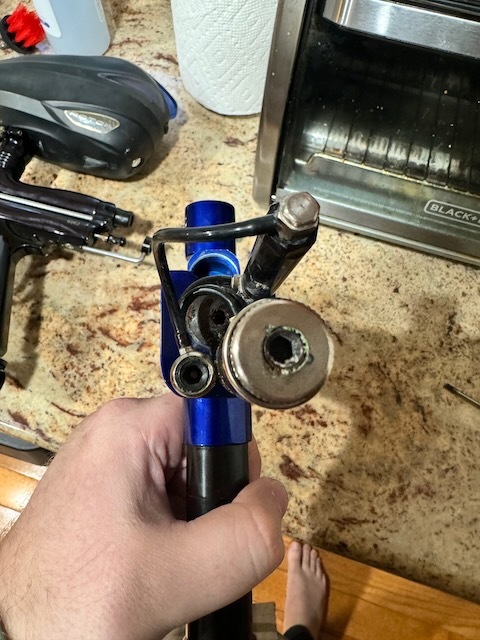

      can you show an image of the 3 way end?
      it could also be a kapp
      does that ram have wrench flats at the top?

        Ram body has hex wrench flats on top
        I've got a couple of rebuild kits coming this way, we'll see if I can get it running again.

          That looks more like an early CCM ram. The only wgp ram that has wrench flats is the karnivore MP4
