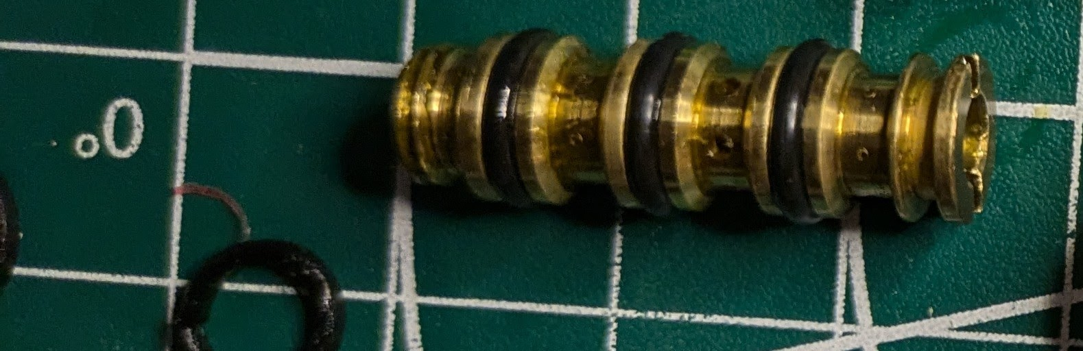

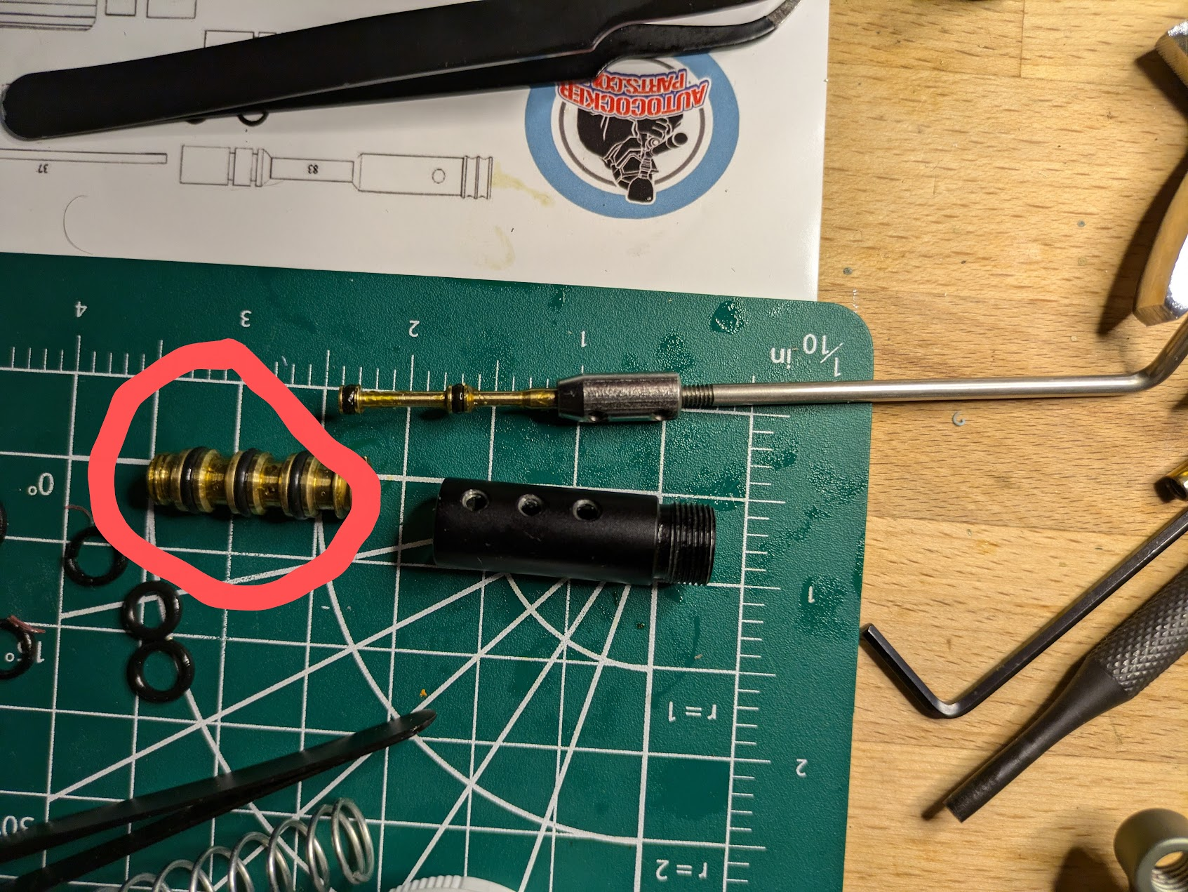

βI was hoping someone could confirm the size of the o-rings on the 3-way splitter valve thing that came off a 2K5 WGP Prostock. The old ones were just goop so I couldn't get a reliable measurement off them, 009's seem too tight a fit in the housing and 008's don't really fit on there easily. Just wanted to make sure it's not a weird metric size and cross section before chasing my tail. image.png
