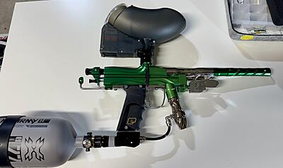

    Threw my eblade back on my orracle after running it mech for the season. The marker has had a full rebuild, but I’ve had the eblade stored untouched for a long time. Anything I should do to reduce future headaches? Replace solenoid gasket, etc? Solenoid and screen all work as they should. Thanks!

    I wouldn't touch the noid gasket if it is working as it should. I don't take my noid out of the housing unless I have some specific need to. I'm quite convinced that the most amount of wear and damage to those gaskets happens when people are taking out and putting in the noid all the time.
    The only real thing I can think of is make sure your lug has enough engagement on the sear

      What feedneck is that on that marker?

        Sconi
