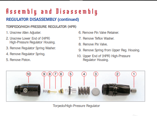

    Can anyone confirm what size seals i would need to rebuild one of these?
    Going to order some Orings to rebuild a 2k3 prostock and wanted to order this at the same time.

    The more critical thing is the urethane disc in the schrader valve... however Dirty works sells a drop in replacment that uses a more standard schrader valve.

      i found this rebuild kit

      image.png​
      Which part are you referring to Frmrspec ?
      Just to be sure, Thanks
      • tyronejk
        tyronejk commented
        I believe he's talking about #7 in that image. A leak there would cause reg creep.

      Ah, so that would be the small clear piece in the rebuild kit, right?

        Yup, I think so. That rebuild kit looks like it should have everything you need.
