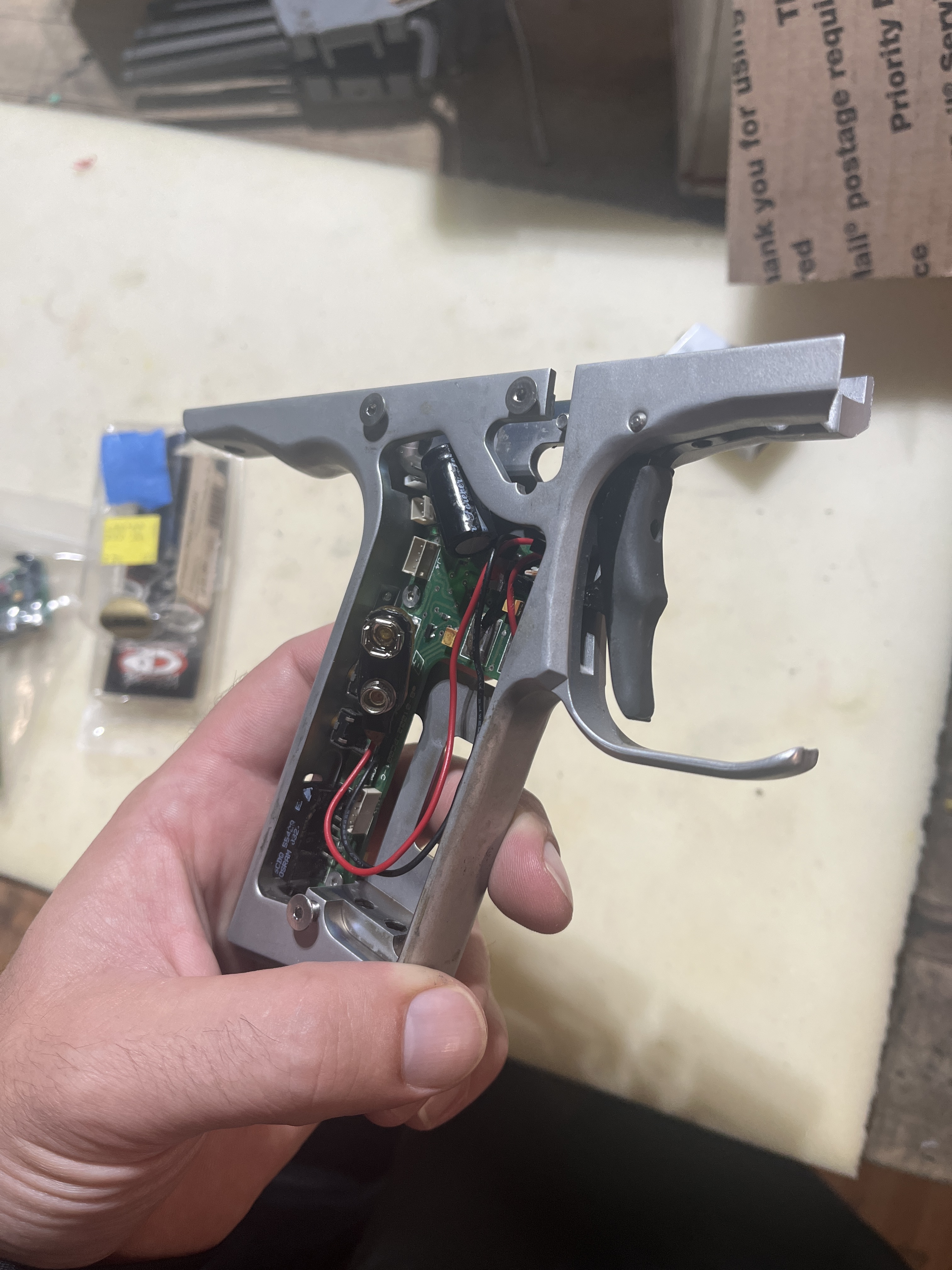

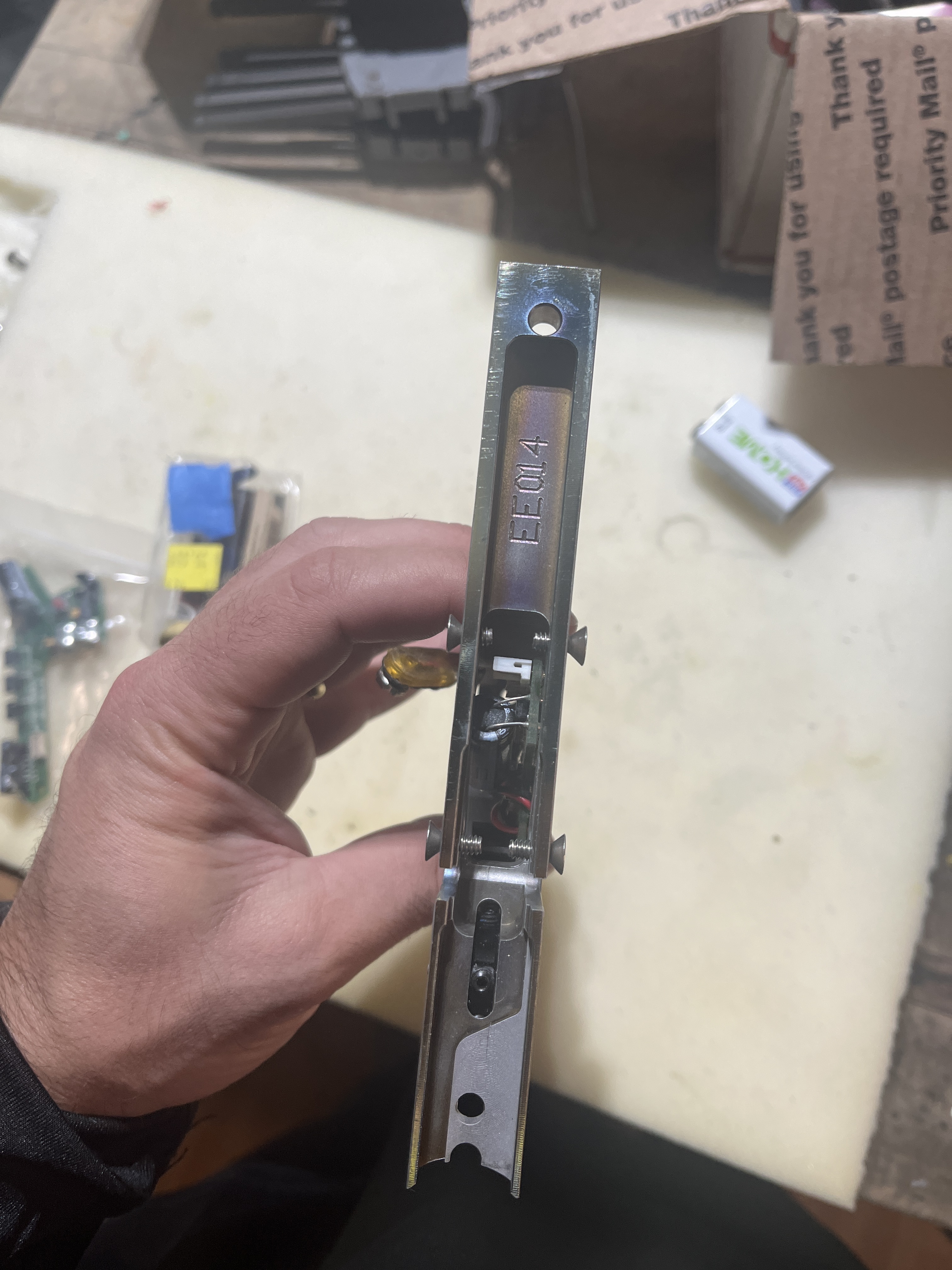

Does anyone know what this trigger frame goes to?
  • autococker04
    • 1879
    • Pittsburgh
    I got it in a box of cocker parts, so I assumed cocker. But there’s nowhere for a sear so now I’m thinking some sort of ego? When I turn it on it says 1.06 - which I think I remember being the same thing my e-cockers would say. Googling numbers on the board hasn’t turned up any usable results.

    Ego with an E1 board
    • DarkApollo
      DarkApollo commented
      It looks like an 05 ego frame that was cut.
    • Olsson
      Olsson commented
      Cut Ego 05 is correct.
      The Ego 05 and 06 frames were very popular for custom Automag builds, either as a Pneumag or Electropneumatic. Most probably the cut was made in order for it to fit behind the vert ASA and HPR for whatever marker it was intended for.
    • autococker04
      autococker04 commented
      Thanks for the info everyone. The cut really threw me off.
