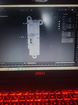

    Hey so I'm looking to make these tiny leaf springs for my at-85. (3rd pic)
    now how to cut the metal so it's straight and does not bend.
    Also more importantly how do I bend such small metal. I bought a small break from amazon but it seems not small enough to achieve the small 90 degrees bends that I need. How is this possible?

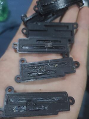

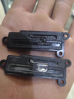

    So far I made one out of metal (first pic bottom one)with bending with pliers and hammer (lol) and to cut I spent hours with a tiny little file , it lasted over 500 rounds then was bent out of shape quite rather fast also seem like it needs to be made out of spring steel, so I heated the steal up red hot then diped in water...it was a failure...lol

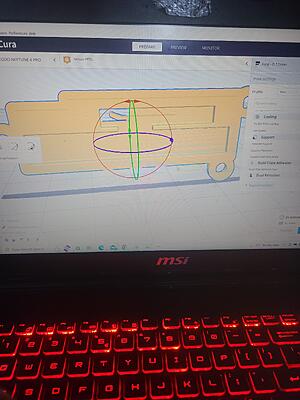

    I'm trying to 3d print them too...obviously with no luck...however I have a few more designs to try out with PETG

      The 3rd pic is what I need good sir. So yes lol how to make such small bends lol

      I don't want to admit it but I went through 7 guid plates this summer .... some by airing up the marker with the mag inside ( stupid on/off valve) and one by dry firing without the mag the others just broke by playing normally with the Marker....I have 4 original plates left ...
      Today I managed to print a workable guide plate out of petg... I dry fired and entire 45/68 tank...still works...I have DONE IT!!!!!!!!
