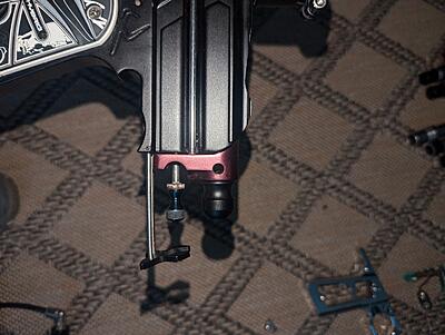

    Hey, just curious to get some insight, I just rebuilt an old System X Vengeance and man, the whole thing was mega loctited from the factory. I am always a little nervous about using heat to melt/burn the loctite but have never had any significant issues. *However*, this time the ano on the back block went from black to copper. It is uniform and actually looks kind of cool but obviously I am now afraid to heat anythng else 😂
    Has anyone else had this happen? Suggestions to avoid it in the future? I used a torch but do also have a heat gun. I feel like I have seen mention of using a soldering iron to heat a specific point? Also, long shot but any way to change it back, short of re-ano? I am assuming not and I kind of dig it but options are always good!

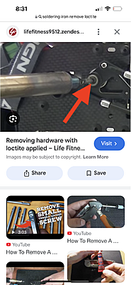

        As a previous poster mentioned.
        Use a soldering iron.
        Change the soldering iron tip from the skinny tip to the wide tip to ensure you are getting enough heat transfer.
        Only apply heat to the male side of the item ( the arms male threads). Using a torch, lighter or heat gun causes the entire combined item to be heated unnecessarily.
        I’m agg about someone using a heat gun on a back block instead of heating just the arm that had the male side of the threads and discolored the back block because it got so hot. It’s like turning on your house heater to max to try to warm up your cast iron skillet. Argh, it’s gonna be ok, it’s only a system x. I commend your efforts. Despite my personal grumbling. Now you know how if you get another one you care about.
        See in the picture, he’s putting the soldering iron tip into the male side screw, not blowtorching the female side of the item itself. In your case it would be on the end of the ram arm itself right before the treads start going into the back block.
        Please don’t take my explanation as criticism, I learned the wrong way. So I’ve totally done it your way also.
