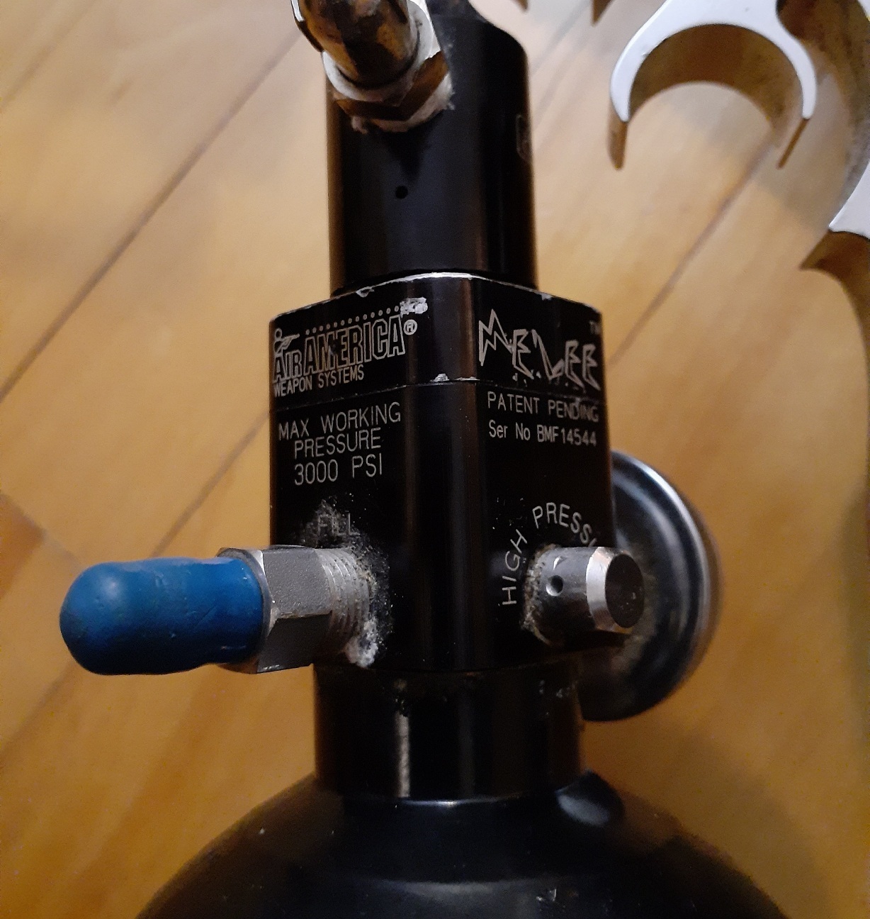

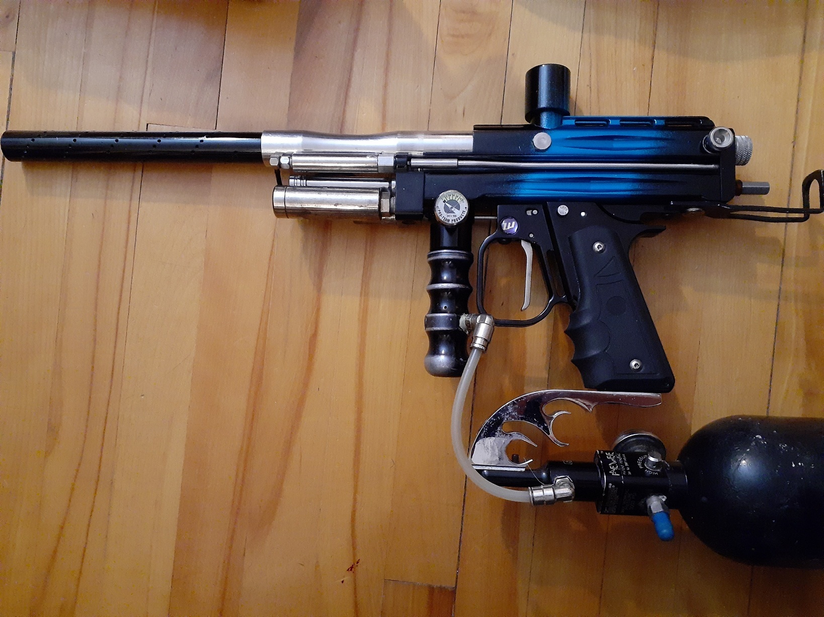

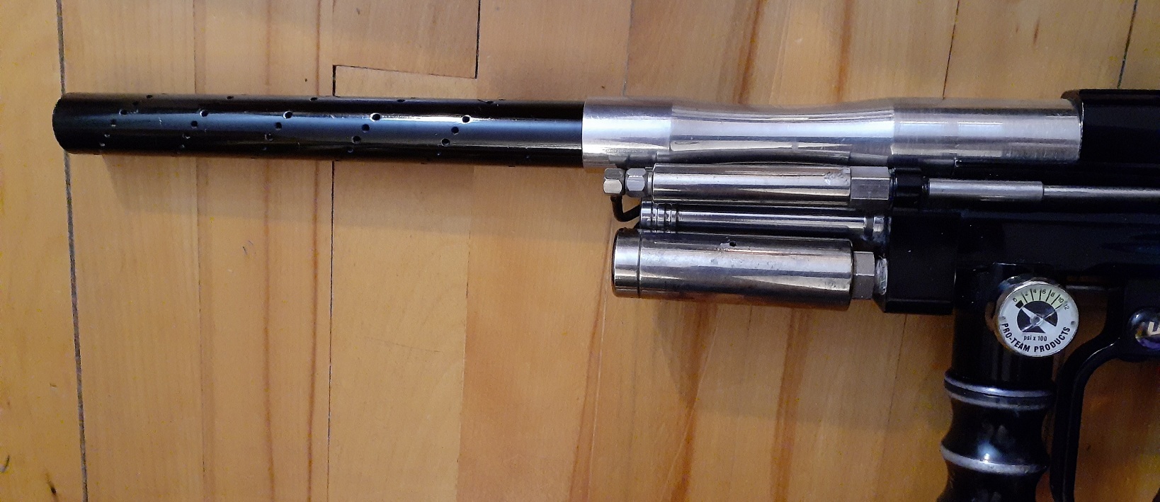

    Picked up this STO not long ago and it came with some interesting parts. Anyone have some info on this barrel and tank reg?
    Barrel look like a Smart part AA but never seen a glued one with a stainless back like this
    Tank reg is an Air America but never seen this model
    Any info, are they rare or worth something?

    Yup.... That's a stainless back all American. Probably around 40 to 50 the bores are going to be huge
    And that is an air America melee reg that unfortunately is not rebuildable easily so if it works awesome if not basically worthless.
      -Not rebuildable? It's not like it can't be disassembled, so I'm assuming you mean because seals are hard to find? I thought Immortal Air carried most AA-compatible seals... and if not, more than a few of us are recreating the old seals.
      It may not be worth throwing much money at it, but it's not worth throwing away. (In my pack-rat's opinion. )

        It came up on Facebook from someone who worked at air American. They were assembled under pressure and adjusted live.
      • Toestr
        Toestr commented
        Not an issue. I'd be happy to go to his house and make a live video yelling at him while he puts it together.

      The blue ansgear AGD seals work well. Only one issue using AA pin vs an AGD pin.
      https://ansgear.com/agd-automag-mini...at-blue-5-pack
      That reg is cool! Name is perfect. Take it apart!
