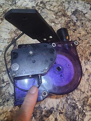

    Warp feed
    What is this wire for? A sensor?

    I think that goes to an intelliframe switch
    • k_obeastly
      • 450
      I think that goes to the shock sensor in the middle of that bracket, senses when the gun is fired and tells it to run. Can also be hooked to the intelliframe switch.

        The vibration/shock/shot sensor is completely enclosed, no external wires needed.

        As others have stated, the wire can be hooked to an intelliframe switch.
        I will point out that it can also be used to connect to any electropneumatic gun board that has a port/header for hopper activation. For example, my Ion has a Virtue OLED board that has a port labeled "RF". It was mean to support an RF transmitter board like this one. I found that if I simply wired up the correct connector to other end of the intellifeed wire, the OLED board reliably activates the Warp Feed.

          Can I connect this to a universal t board?
            I don't know enough about the universal T-board to say for sure or even how but, I suspect it is possible. The original RF link daughterboard I mentioned was designed to take the same signal/pulse as the solenoid or sear tripper.
