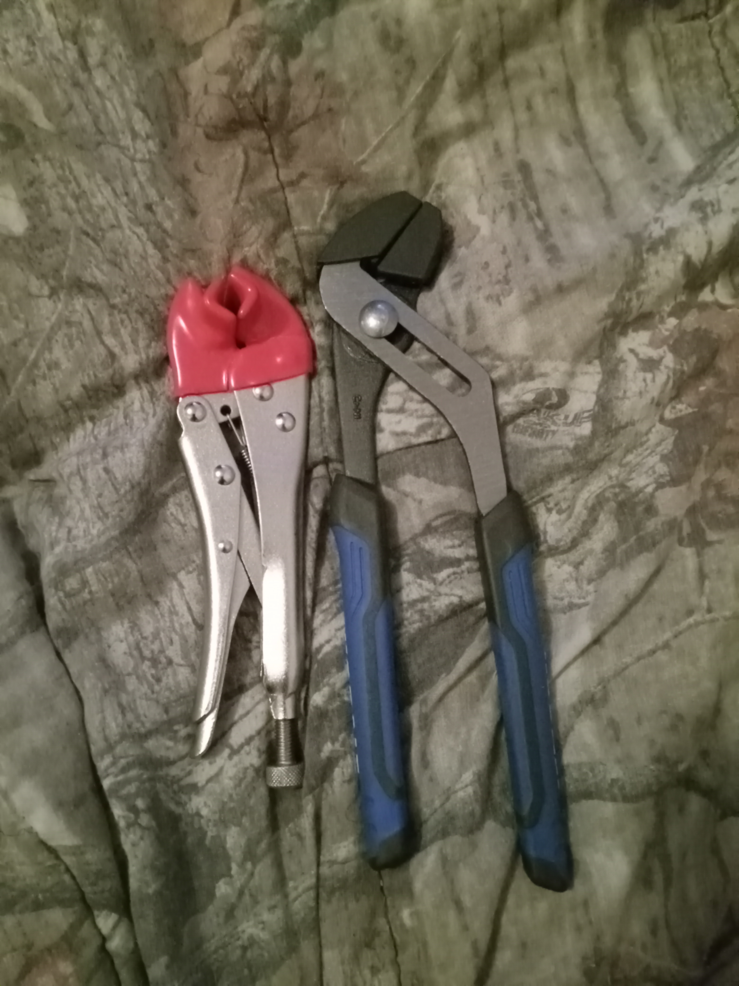

          • Psycho91
            • 1243
            • Lexington, SC
            I use these vice grips with the rubber covering on them
