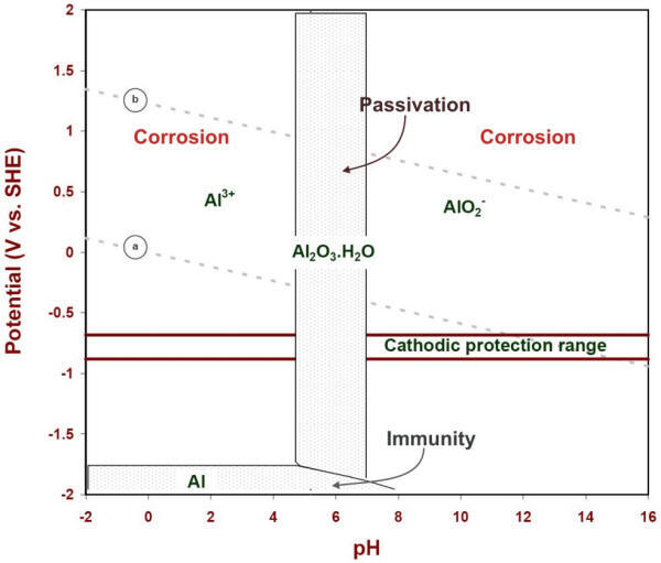

        I can really only aid with cautions based on knowledge of the corrosion reactions, which can be summed up as: Keep the pH at 6±1. The potential in your case is approximately zero, so just make sure your pH is 6±1 where the oxide layer passivates the part in aqueous solution...more on this in a minute). Simple Green has a pH of ~9±0.5 which will eventually corrode the aluminum oxide and the aluminum itself.
        For more info, try this random google result for 'aluminum pourbaix diagram'
        Now, even in the passivization region you can run into problems if the ultrasonic cleaner is breaking down the oxide layer. For example, if it's exposing the pits of dye that have been ever so slightly oxidized over then you'll get what looks like pitting corrosion.
