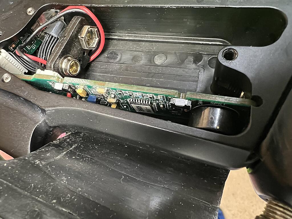

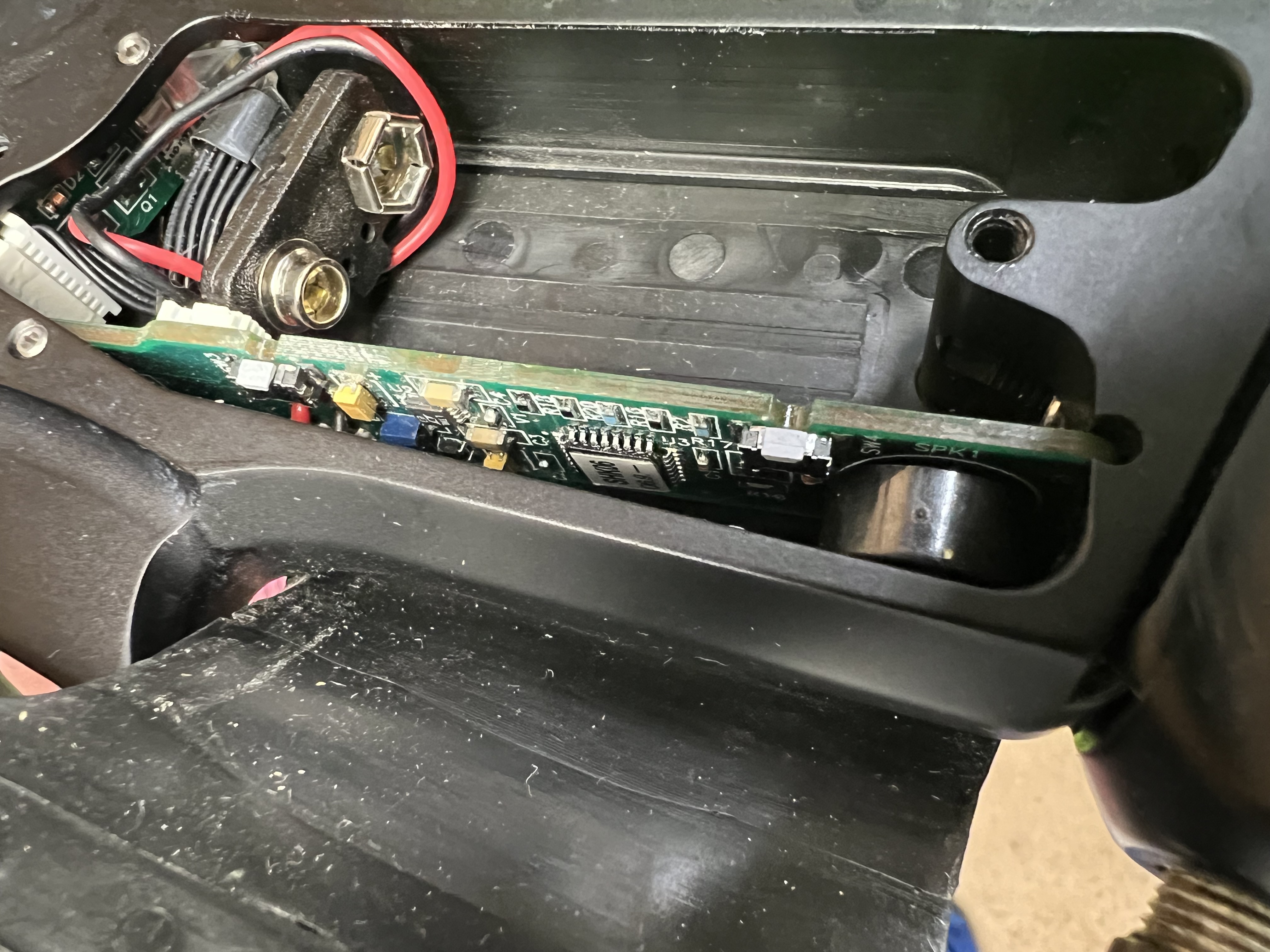

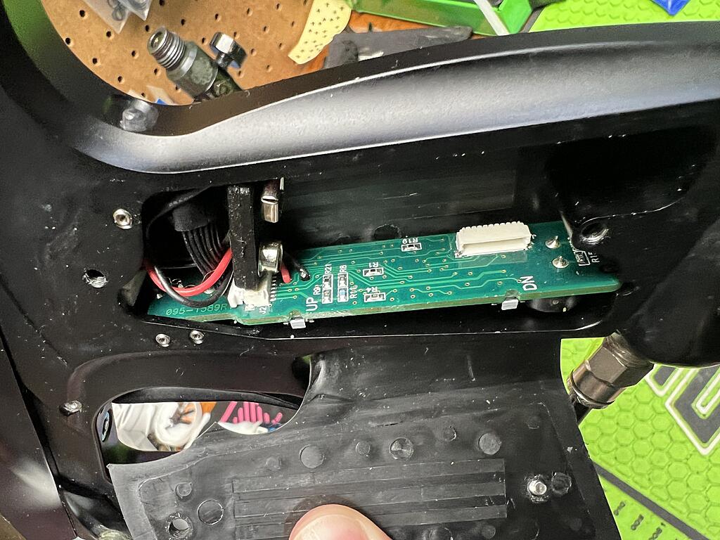

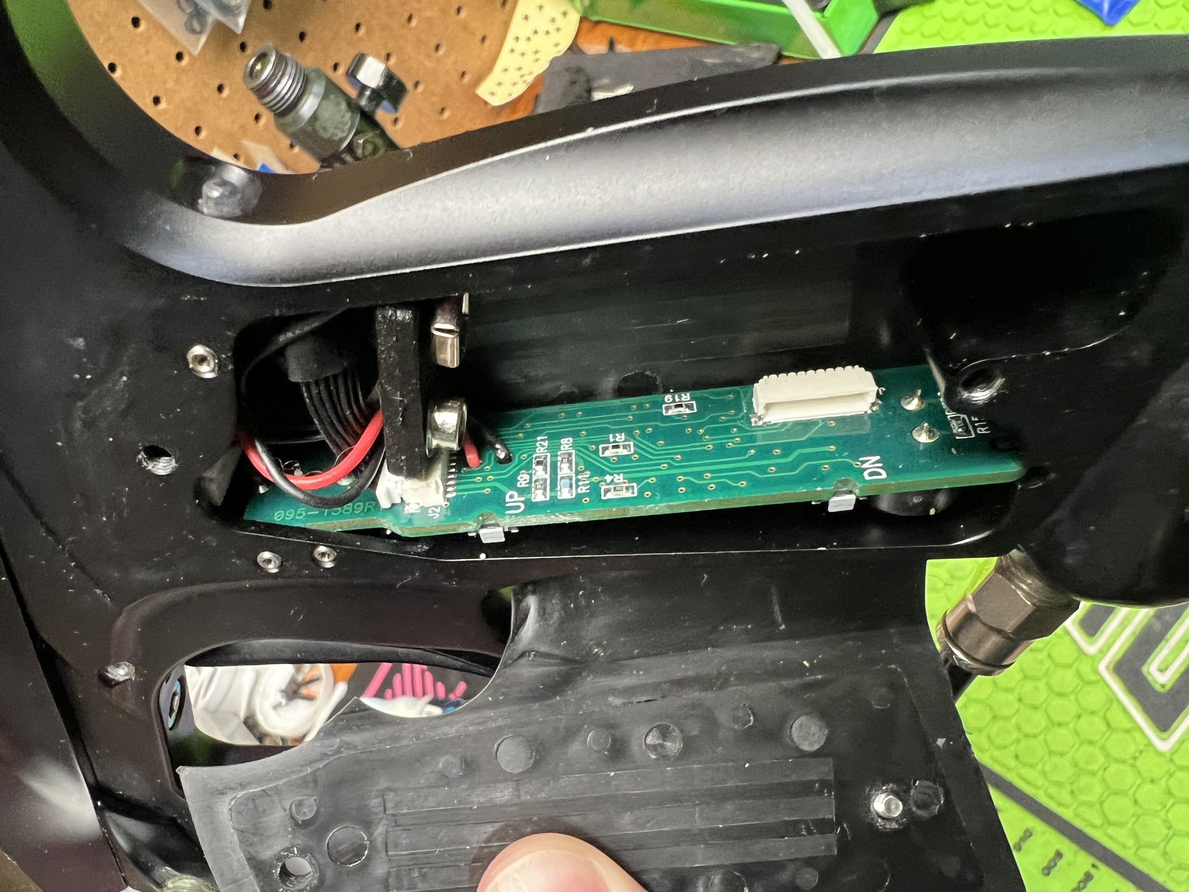

    Hello, I have a Shocker NXT with a board the says SHK06 0.6.9. I’ve been asked about the board I have and its firing modes.
    Looking at info available, it would assume I have a first gen board? And this board would not be comparable with the modern 10.1 bps limit?​

    If it's stock all it's going to have is "rebound" mode which is basically dumb ramping.

      That looks like a stock board. See zdspb.com for information either way.
      I recall the lowest rate of fire on rebound (ramp/turbo) is around 11.

        Thanks. That is what I expected but people
        mentioned there was a later stock board so wasn’t sure.

          The later stock boards have the option for break beam eyes. Early boards had reflective eye logic for SFT shockers. I might not be remembering correctly, but zdspb.com has comprehensive information.
