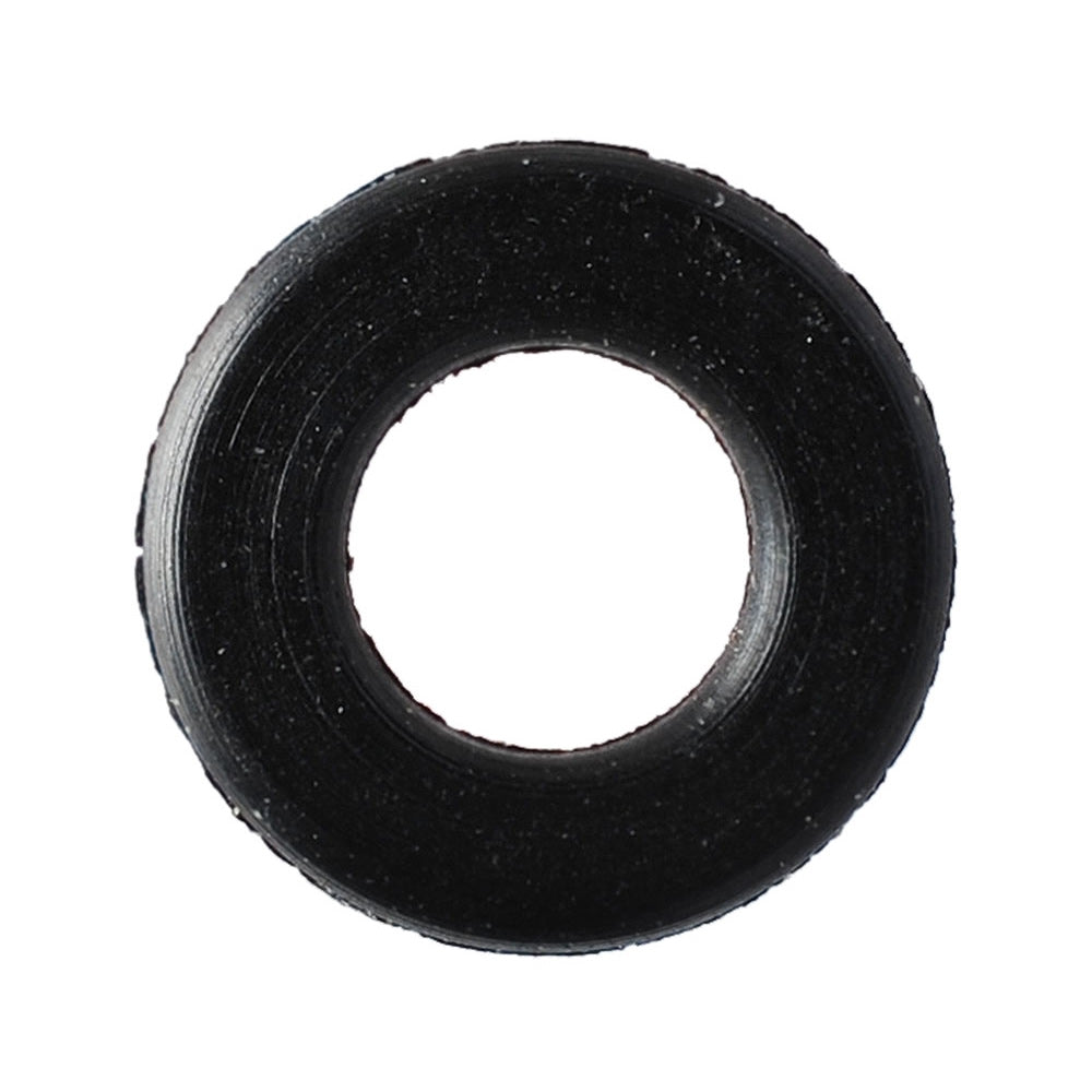

    Where can I get the orings that everyone is having to replace on the laz valve, I think it's some u cup oring, or if anyone has some they wanna sell I'd buy some off ya

    I believe the u-cup is actually unnecessary and you're better off running a 009 70D in its place. The really small O-ring on the opposite side isn't a standard size. Although, it is the same O-ring that Dye uses in their solenoid and autococker three way. I believe the middle O-ring is standard but cannot remember the size.

      If that's the one everyone has trouble with leaking, got a link to where I can purchase some, last thing I wanna have to do is tear this thing back apart for leaks

      Psycho91 That's the u-cup is the source of a leak down the barrel.
      This is the O-ring on the opposite side.
      https://www.paintballwizard.com/prod...h952IziG75KvBg

    Is that the same oring that everyone is replcing for the u cup seal

      No that boring is a standard 009 70D.
