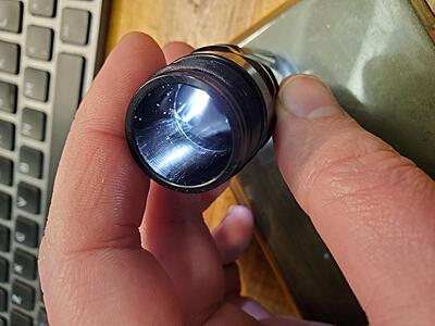

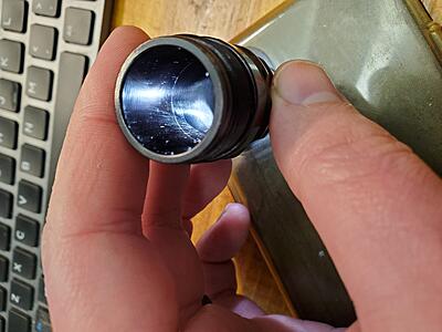

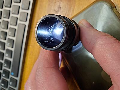

      This is the bore of my torpedo... I guess I know why it needs a vent
      This gallery has 4 photos.
      • RhoXi
        RhoXi commented
        Yep that's about how mine looks. It's a shame because the outside is a lot better shape.
