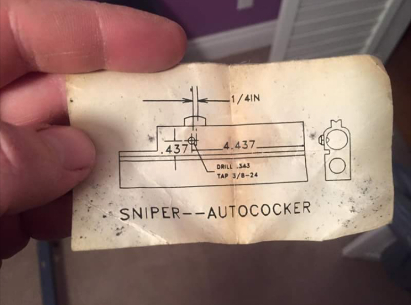

    I have this old picture but if anyone wants to confirm
      Jordan commented
      That should work, actually.
      I wanted to confirm I was in the ballpark before I drilled anything - looks like I'm in the right spot.
      Thanks!

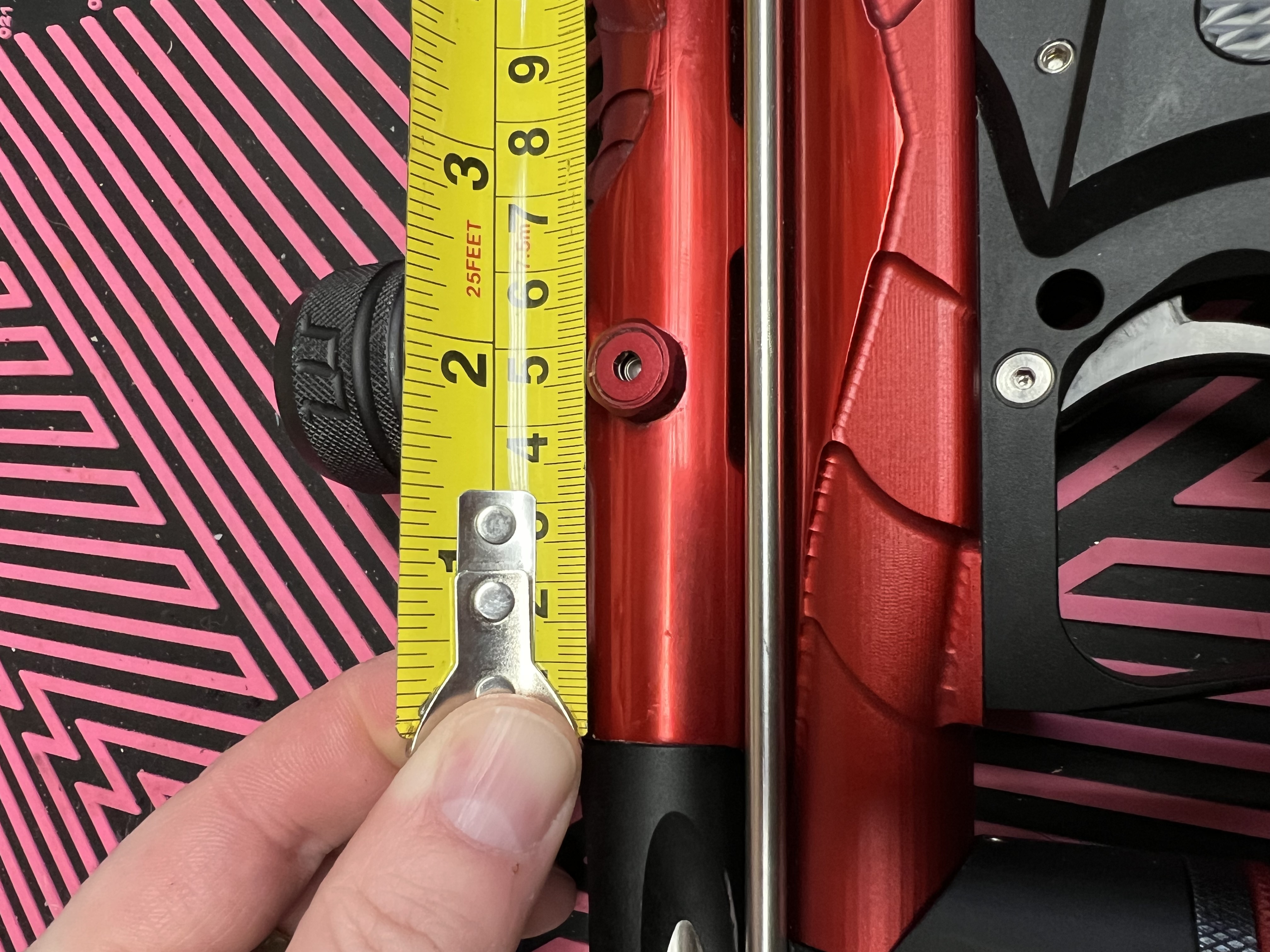

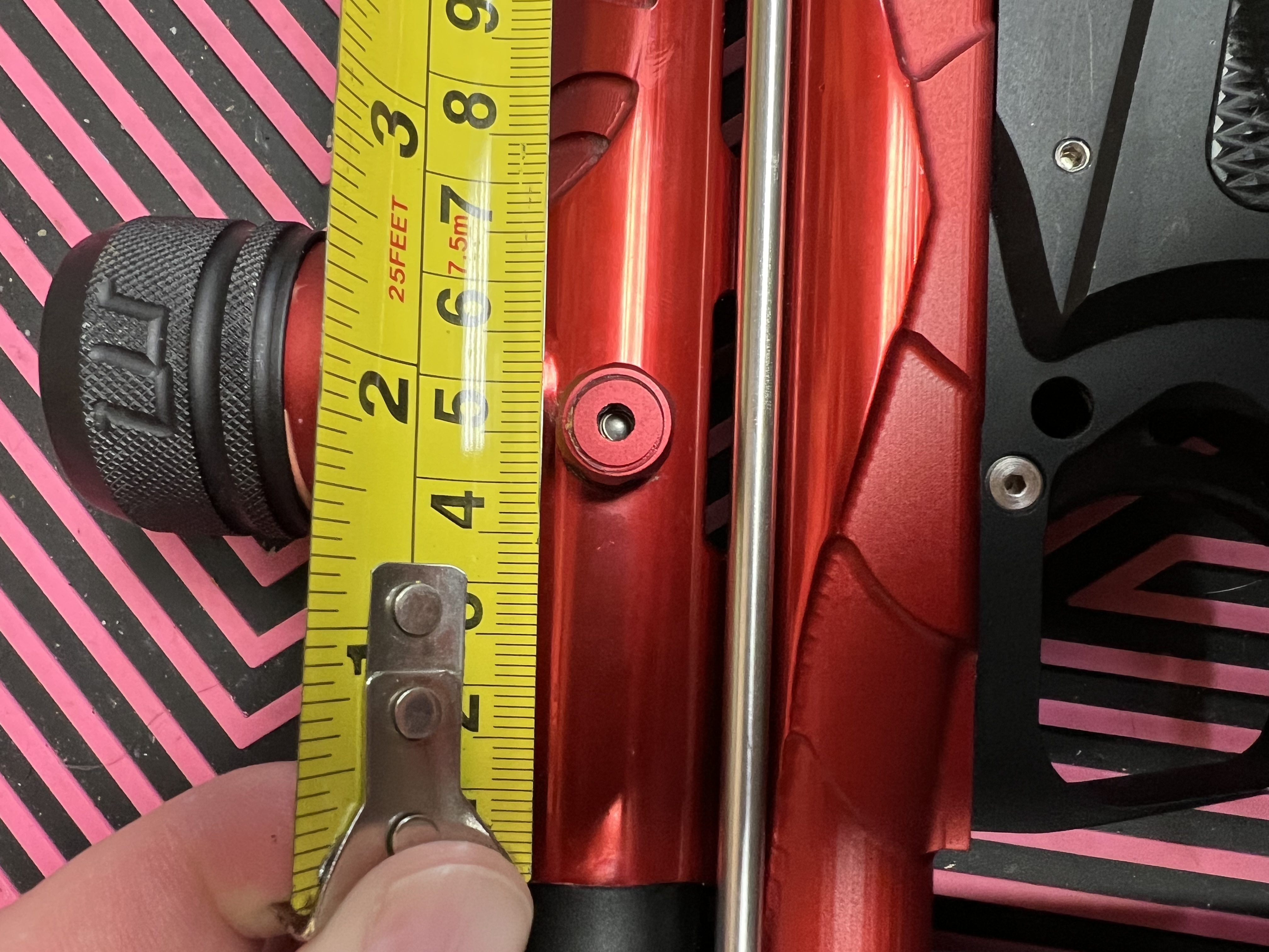

    Off a WGP Karni body:
ID:	656908 Click image for larger version

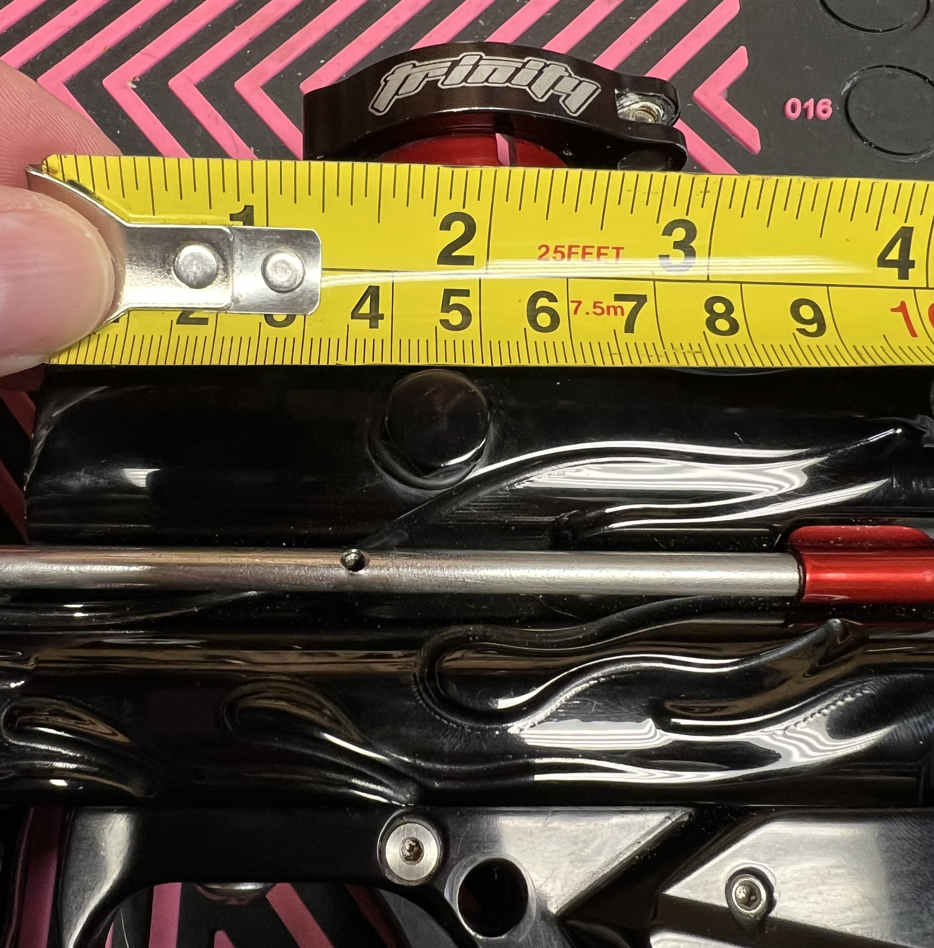

      • 4560
      Confirmed on a WGP half bock, same spacing
