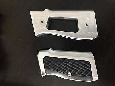

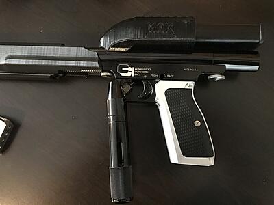

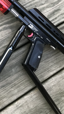

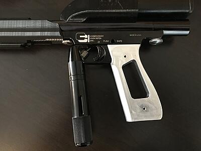

                      • 6377
                      I like the CCM 86* frame the best especially with the thumb relief aluminum panels.
                      This gallery has 4 photos.
                        • 6377
                        86* with the palm swell aluminum grips 👌🏼
