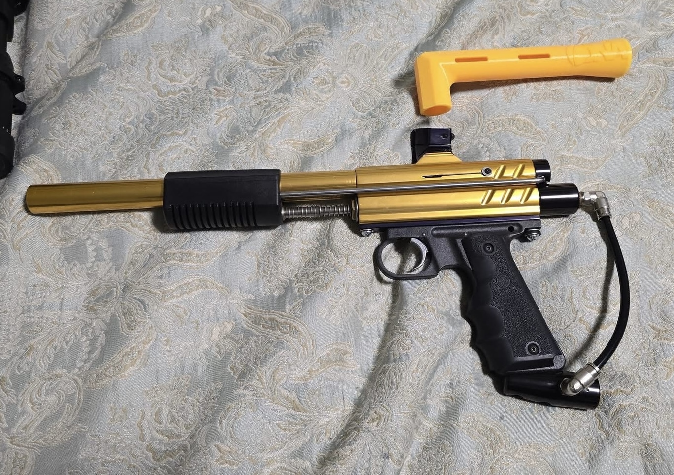

              Hellion360 commented
              If it is the gold one in the facebook group it is a good deal, but not the current version.
              Which has some advantages with the freak insert placement.
              I actually owned that gun before it got anodized and it was a good shooter. It has some milling done to it that isn't stock.
              The frame is a composite version. Or was anyway.

            • 4560
            This one. Does look like a composite frame.

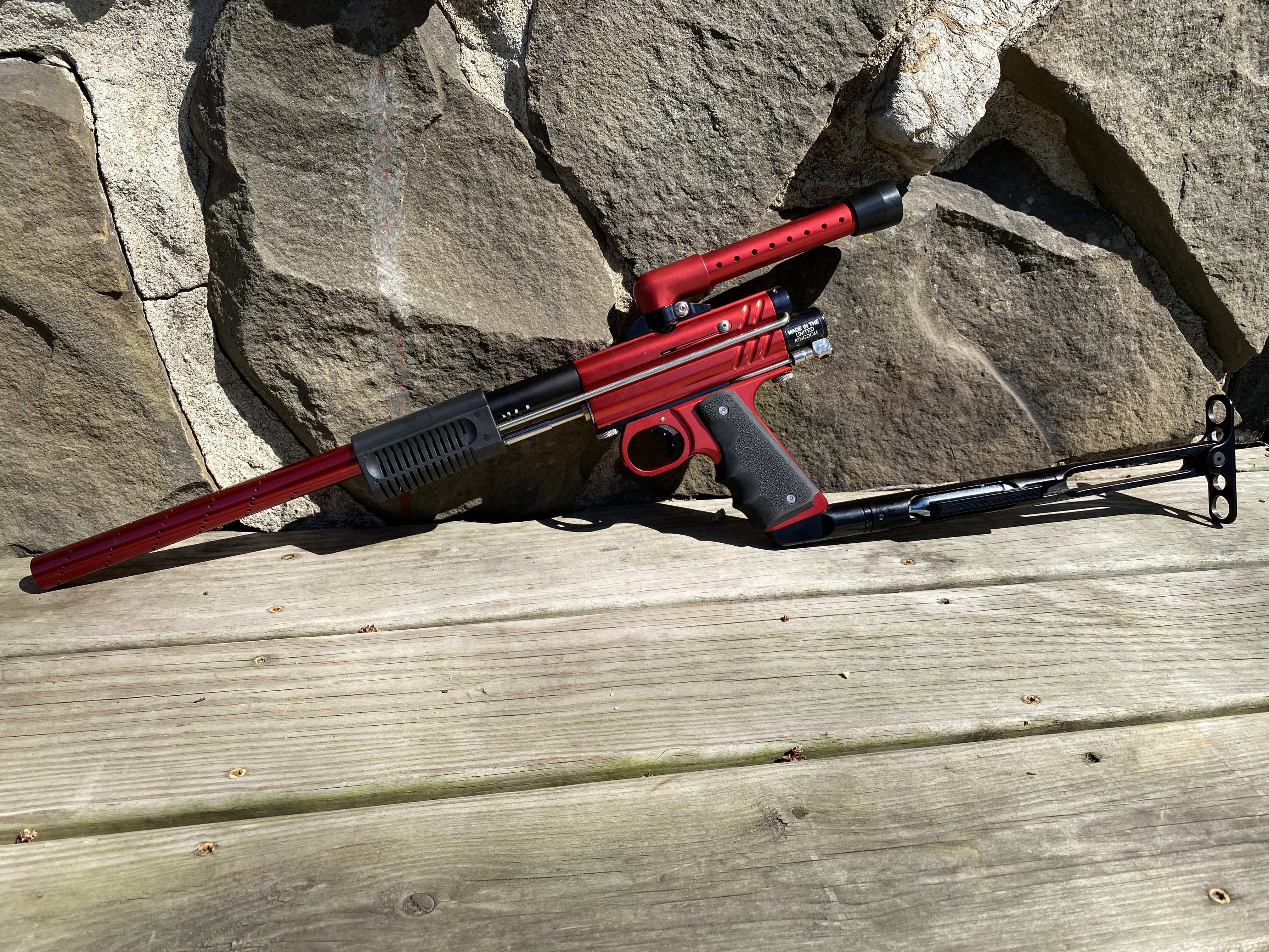

              I can't speak to the new ones, as I haven't had the opportunity to pick one up. But I do like the old ones:
