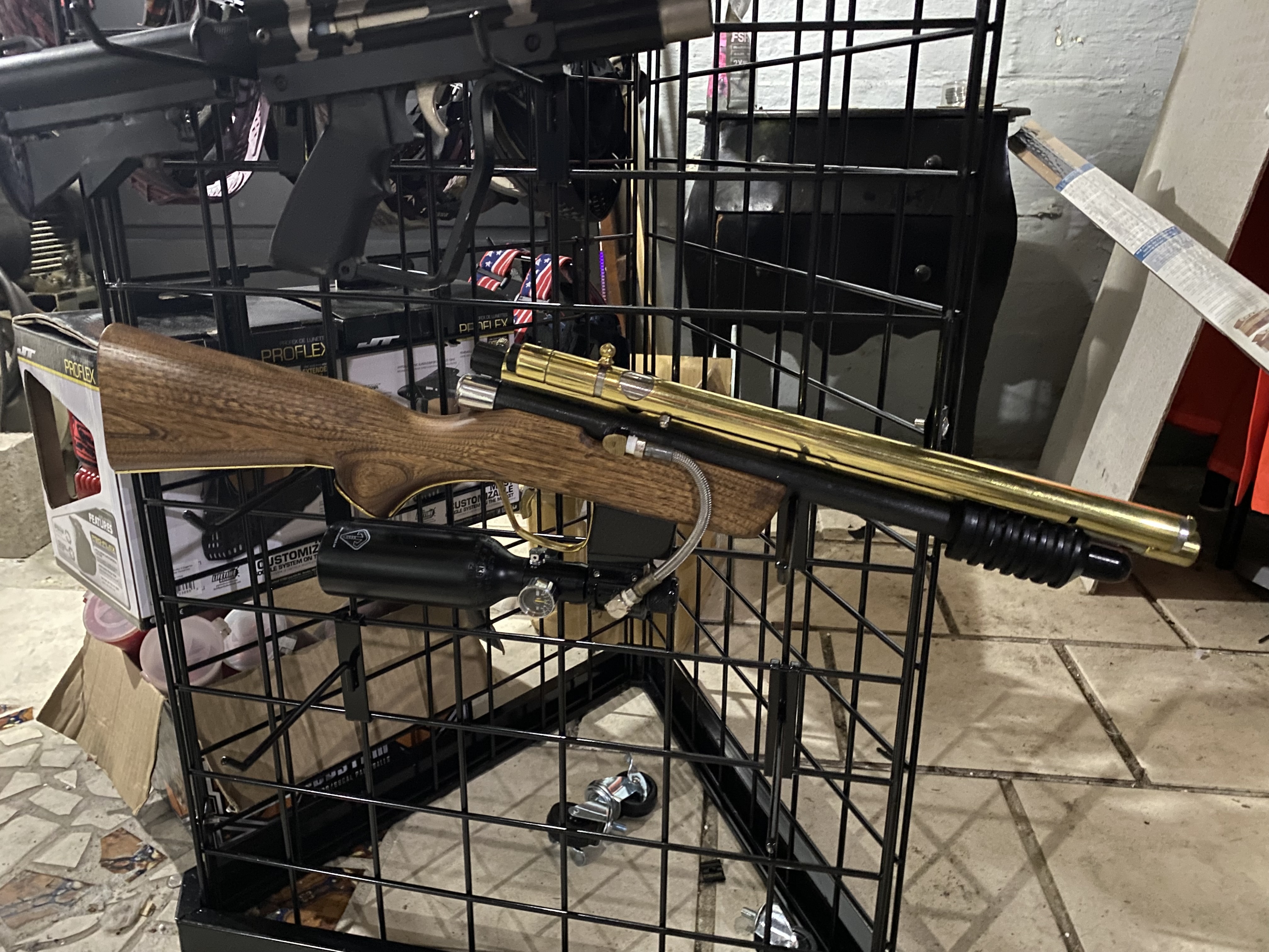

    I love the 9ci I run one on my VSC Phantom but mine put out 825psi I get 150shots on a hot 3k fill. It’s perfect for a stick fed Phantom. Perfect when it gets a lil to cold to make 12g play.
    You could probably get the pressure down by flipping a shim or removing one in the reg. 1k is a lil high pressure for most paintball markers. But the regs are simple shim stack regs so it’s easy to adjust.

      I have a Maxtact 8ci and it’s my go-to tank for my VSC and my Super Stocker. Will get 100-120 shots on the phantom and 90-100 on the Stocker

        They are definitely fun little tanks. They are great for small cap limited paint play.
        What are you planning on running it on?
        Providing what you were shooting is fairly efficient you can definitely get a decent shot count out of them. They are Also (2AL -and 2” round), so lifetime hydro exempt.
        This is a MaxTac one I payed a lot more for it than what they are selling those for on eBay. Tippman didn’t offer them at the time.

          I was planning on using it for pump automag.
          FredMnkyDad10 Feedback
            That’s a perfect tank for what you are looking for mags love High pressure. Probably won’t get 150 like I get on the Phantom but 100 ish is definitely possible. Perfect for a pump.
