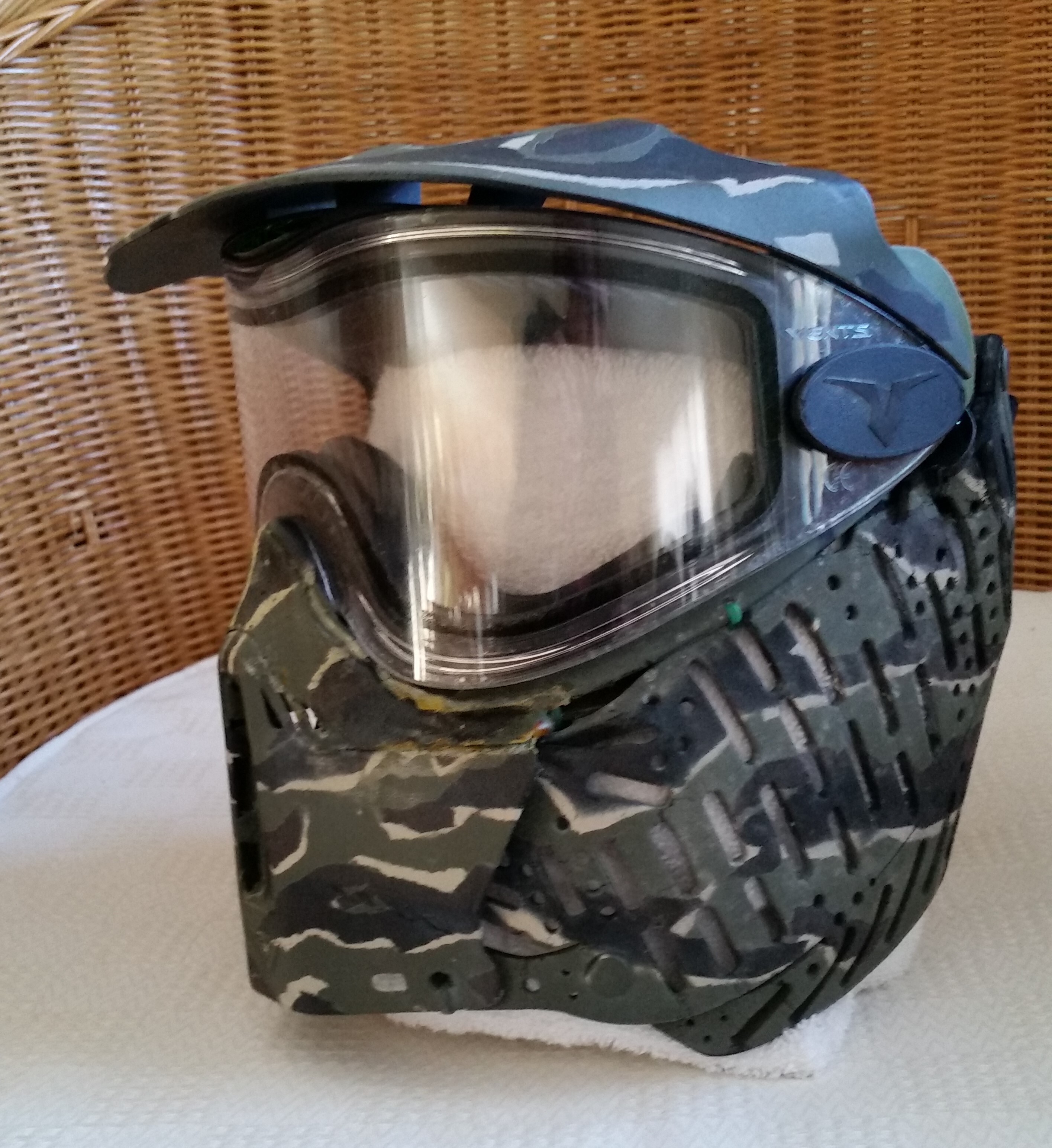

      I have used Krylon Fusion for plastics and Duracoat with reasonable success in the past but as stated the plastic used does not take paint well. I did some research on this a while ago and one of the best options I found was Cerakote and low temperature curing for longer periods of time but the expense was not worth it.
      This is after years of hard use and the paint is fine but some of the epoxy I used is discoloring and separating from merging Old School Vents mask to Empire Vents Googles. This one is Krylon Fusion the Duracoat ones were no better and considerably more expensive.

          Yup using an adhesion promoter definitely helps especially something that is going to flex. I used the Krylon branded promoter when I did mine on the plastic/epoxy parts. Was not needed for the foam ear/cheek pieces they soaked the paint up quite well . Cleaned everything with denatured alcohol then sanded IIRC most likely 220 grit then cleaned up again before spraying with adhesion promoter. Prep work is key with light coats and patients. I've been tempted to put new lenses in this mask and wear this weekend. It still is in pretty good shape I just stopped using it because some fields would give me crap about using a modified set of goggles.
