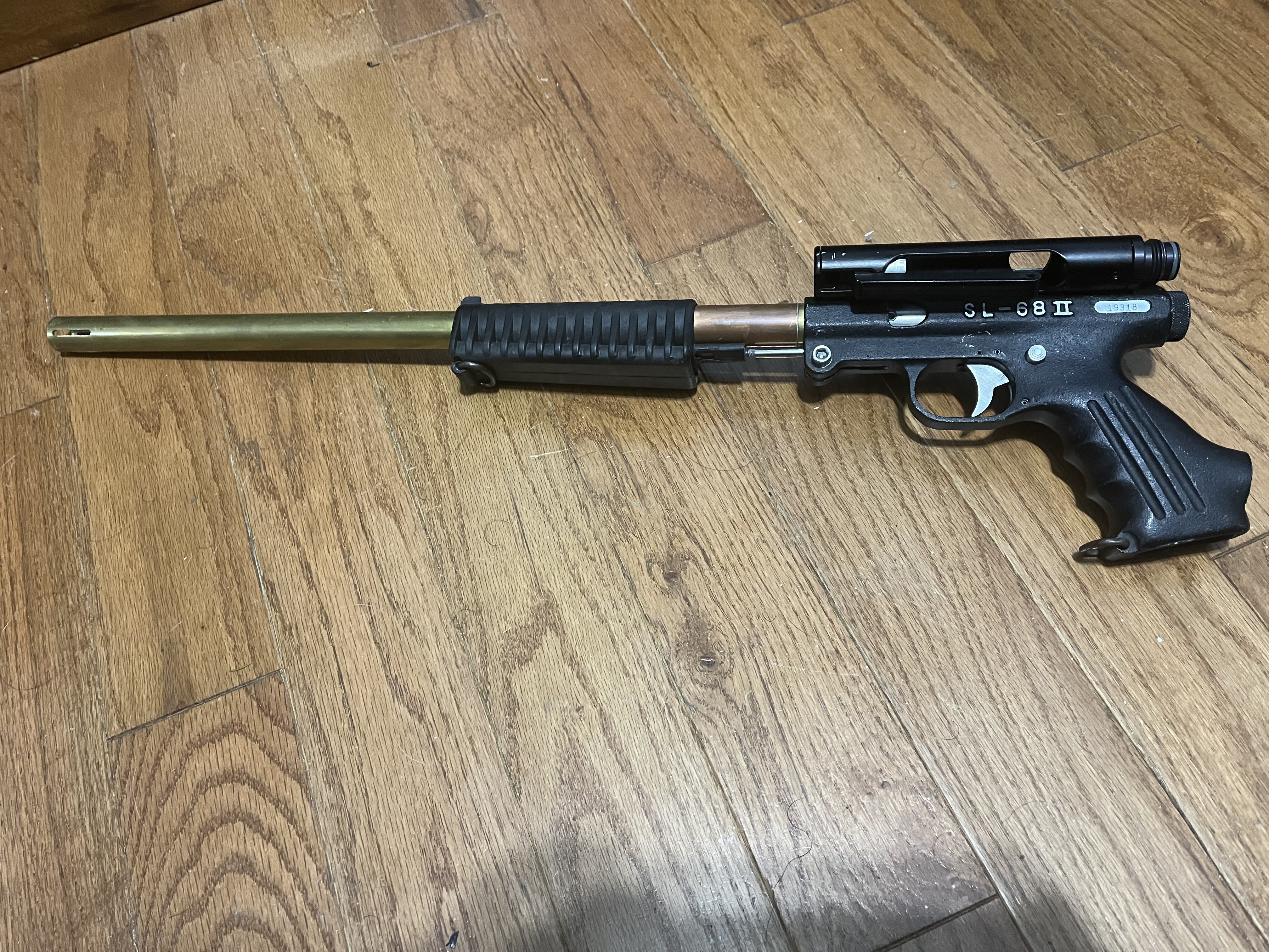

    I got this sweet tippmann sl68-II from facebook market place with the big 16.5” brass barrel and I’m going to modify it for stock class. Pretty simple, I can just attach my lever changer or bucket on the tank asa and 3D print a simple feed tube or make it out of brass. Anyways, the one accessory I would like to put on it is a side saddle so I could attach a shoulder stock. I modded a phantom rear asa piece for it but obviously it won’t work for this. I was thinking of getting something that screws into the tank asa and then can attach to a macroline or steel braided line to give it the tippman 98 aesthetic. Would anyone be able to recommend the correct pieces to achieve this? I’ll mount the lever changer with the rail on top and then run something that screws into the icd lever changer, but I don’t know the easiest way to do this or where to source the correct part. Any help would be appreciated, thanks!

    There is a stock attachment for that lever. I would just get that and a stick feed. They are gas hogs tho. Don’t expect many shots on a 12g. Deadly winds use to modify there freak barrels for thoes I had one made a while ago but you have to email them. Or Doc was making a bunch of freak backs he could definitely make you one.

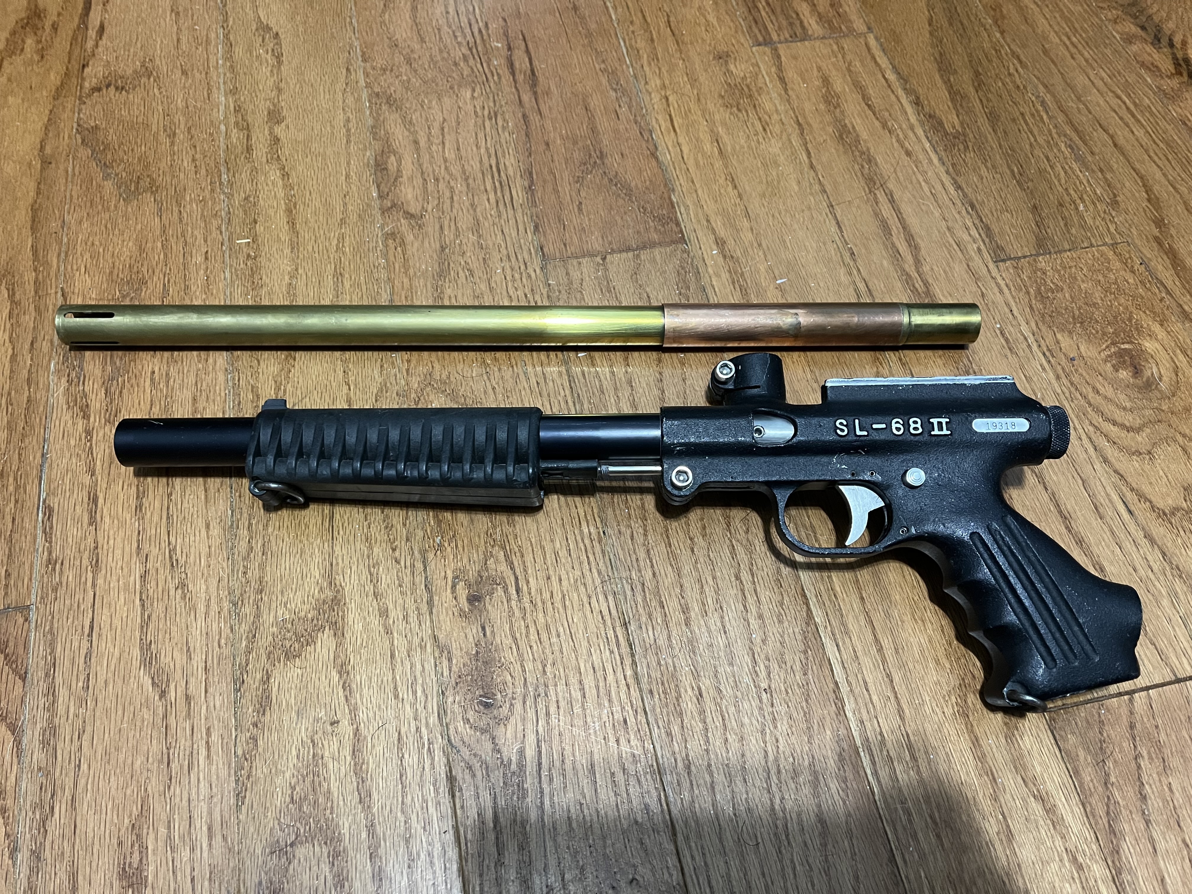

    or maybe You can get that cool brass one bored for inserts that would be cool!
      • 3414
      The brass barrel is an old J&J barrel. Mine is straight rifled. I highly doubt it's got enough meat to bore.

        Not sure if that barrel can be bored,however if you get one of those old stock Kingman Hammer/Spyder barrels with the brass lining you can make a Freak ready barrel for it......turn/grind/file the threads down flush with the OD of the barrel and heat the barrel up then push the brass lining out,then cut the brass lining than reinstall the remaining brass with 2 part epoxy and leave space for a Freak insert ,then you'll have yourself a Freak ready barrel for cheap

          Install wedgits (strategically placed dents pioneered by palmers pursuit shop) in that barrel you have.
          Remember that when the gun is cocked with a ball loaded you want the ball sitting wedged in the dents, hence the name "wedge it" wedgits.
          Do not put the dents in front of the ball like a ball detent. This results in inconsistency from the variable position of the resting ball, and often ball breakage when the ball accelerates into the dent upon firing.
          Good luck! There are DIY discussions on wedgits. Id try!
