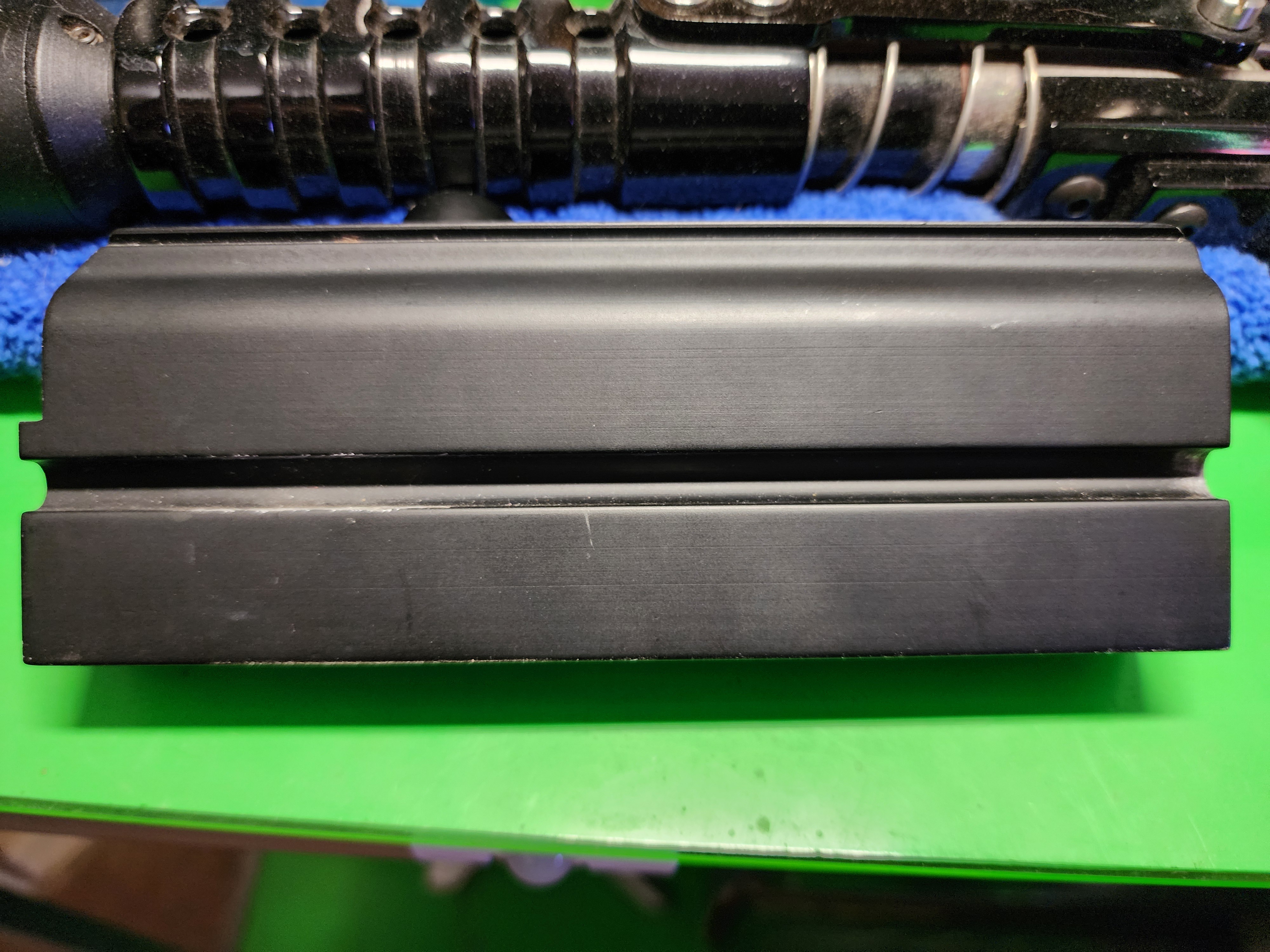

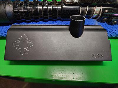

        • paintballedbackin88
          Still Uncanny...
          • 133
          • Glendale, AZ
          Yes, not having an externally adjustable hammer is inconvenient if you're building a mech, but not that big of a deal if you're running a pre2k mini pump.
          Less volume was desired by those of us seeking higher 12gram efficiency, and a pre2k mini body checks those boxes off. I actually have an old slab side right feed mini cocker in pieces that's been sitting for a LONG time if you're still looking.
            Still Uncanny...
            • 133
            • Glendale, AZ
            Discover the magic of the internet at Imgur, a community powered entertainment destination. Lift your spirits with funny jokes, trending memes, entertaining gifs, inspiring stories, viral videos, and so much more from users.
              Still Uncanny...
              • 133
              • Glendale, AZ
              Other side
                Still Uncanny...
                • 133
                • Glendale, AZ
                Other side. I do have the back block, mini front block with vasa, original internals, and pre2k bolt as well. Also have a period correct stainless air america hpr if interested. It weighs more than the body.
