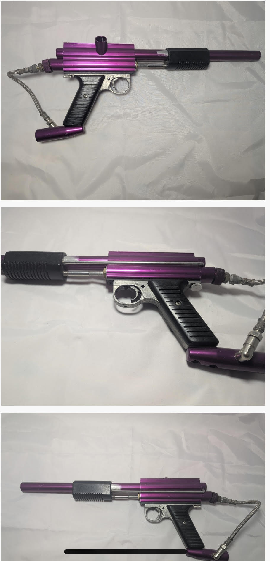

    Hello there. I'd like to replace the orings on this sterling pump I got a while ago, but it seems none of the captain o-ring orings fit. I didn't see anything on bacci like an oring kit. Any suggestions? Thanks!

    $35 dollary doos from Australia. I’m not sure of anywhere else to find them. Also not sure of those o-ring sizes in Home Depot sizes LOL

      That year, you'll need some -016 for the valve body, a -012 or -013 for the valve face, and some -112 for the bolt.
      Unlikely any of them are bad, honestly. I've meant to check if cocker cup seals work. My new sterling cup seal went bad in a year, and i put a 20 year old one in to fix it.

        I inspected them and some are torn a little here and there, it has a slight leak so I’d like to patch it completely. I ordered the oring kit from Australia mentioned above so that should hopefully work. If not I guess it can have a small leak for now
