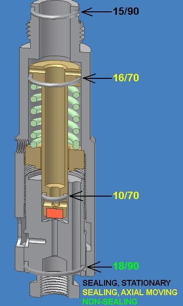

      Its an Ion reg that I want to bump from 200. i measured the factory spring and came up with something in the 220lb/in range. I found a similar size spring in the 560in/lb range

        In theory, not a bad approach. Might need to go for a harder elastomer, too, though. Piston o-rings might extrude, and seats might get "punched". A90 might be a good durometer to switch to for the typical A70 o-rings if you notice issues.
        Century Spring and a few others also let you measure a spring (diameter, wire size, pitch) to calculate spring rate, which might be a little more accurate; then you can select one with a higher rate. Interestingly, almost all steel spring materials have very similar rates, even though some last much longer, so physical measurements can be very handy ways to spec a spring.
        Can't hurt too bad to try. If it were Belleville stacks, it would be a much more complicated proposition.

          Credit: zdspb.com
          ion regulator

            Yup! I've looked at that website more than once! I had not considered uppting the durometer on sealing o-rings though

              I don't think the reg seat should not see any different forces at different pressures. I agree higher durometer orings may be needed to avoid extrusion. I would take some measurements and find some reference info online on that though. I think it's possible you'll be ok with the stock orings.
              Friction should not matter and doubling the spring rate to double the output pressure should work, though I'd double check the minimum compressed length of your new spring to make sure it has enough travel for the reg seat to actually seal when the spring is compressed.
