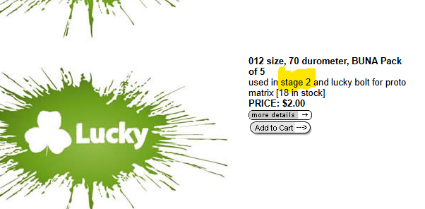

        Well I have good news and bad news. This is a screenshot from wayback machine, and good news is you're using the right size. The bad news is, your dilemma may persist. I'm reading this as an o-ring for both the stage 2, and separately also for their proto matrix bolt.
        • Ramfaux
          Ramfaux commented
          Cool, I didn't think of checking wayback machine. Sucks that that's what is supposed to be used though, might have to change the can out for a stock one.
