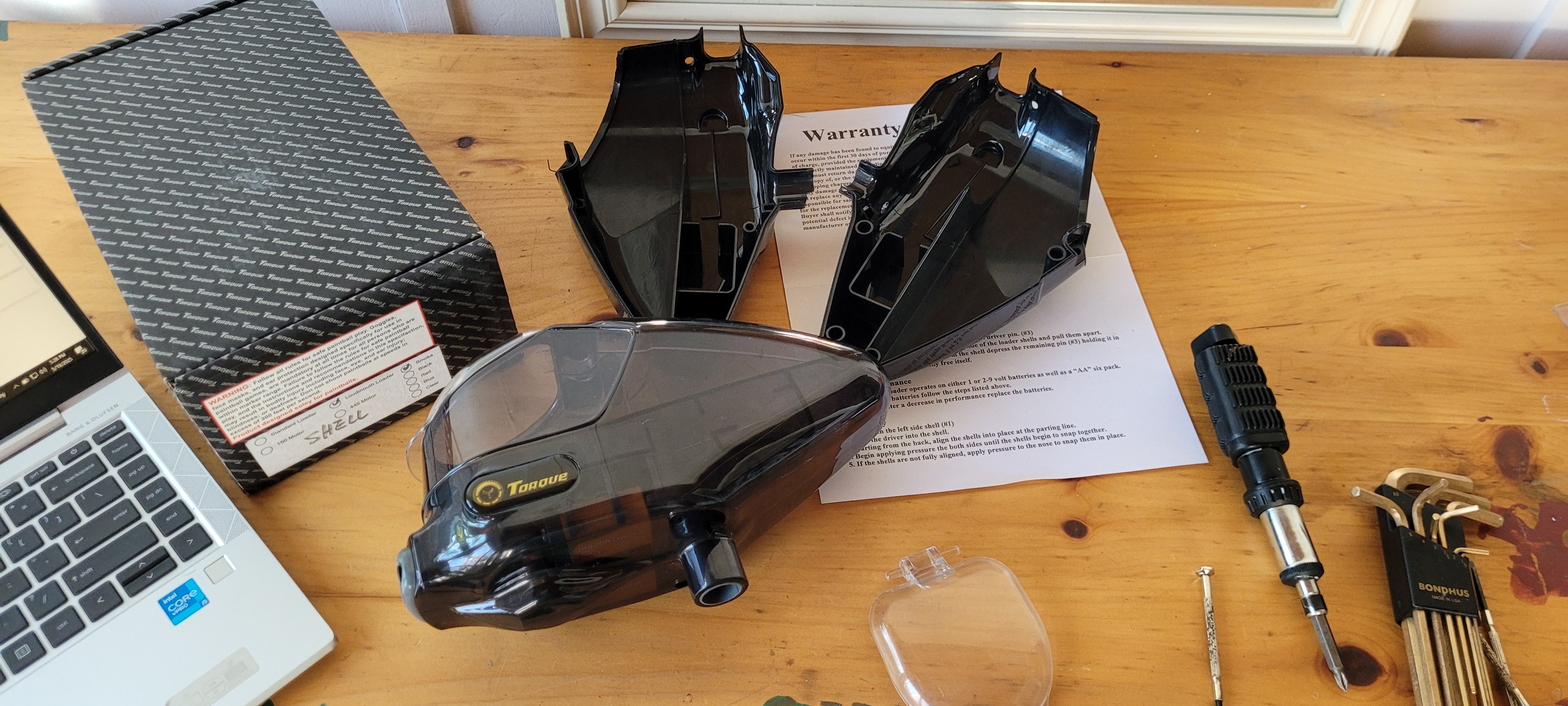

    Wondering if anyone ever had a nice solution to fit a speedfeed on one of the Torque loaders?
    I just got a new smoke shell and rebuilt my old Loudmouth. Still works great

    Love these loaders but even when new there was never a speed feed made for them, the constant spinning killed them
    You can magnet mod them and it will hold the drive cone in place when the stack is full, idk if it would burn the motor out though, I didn't have mine long after I modded it

      Yeah, I saw some people used a Vlocity speedfeed, but you need a rubberband for it to stay down. I dont really like having a rubberband so I might just leave it as-is.
      I might try to get this Prophecy speedfeed to fit. Not bad for $3....https://ansgear.com/gen-x-global-lig...ed-feed-olive/

    Just a little update on the speedfeed progress.....and there is none Prophecy, Vlocity, Vlocity Jr, and Vlocity smallmouth; all dont fit.
    I do have an extra lid that I might try to cut up and get something mounted on.

      Where did you find a new shell? Mine is cracking at the base.
      • otar
        otar commented
        Currently paintballgear.ca has some stock!

      If anyone is interested in modding one of these just take the drive cone apart and flip every other magnet in it, 2 of them will face the same though as there is an odd number of them in there but it will still hold it in place when the stack is full, I do not know how long the motor will last though so do this at your own risk, but it doesn't constantly spin after that also be sure to switch it off if your not using it
