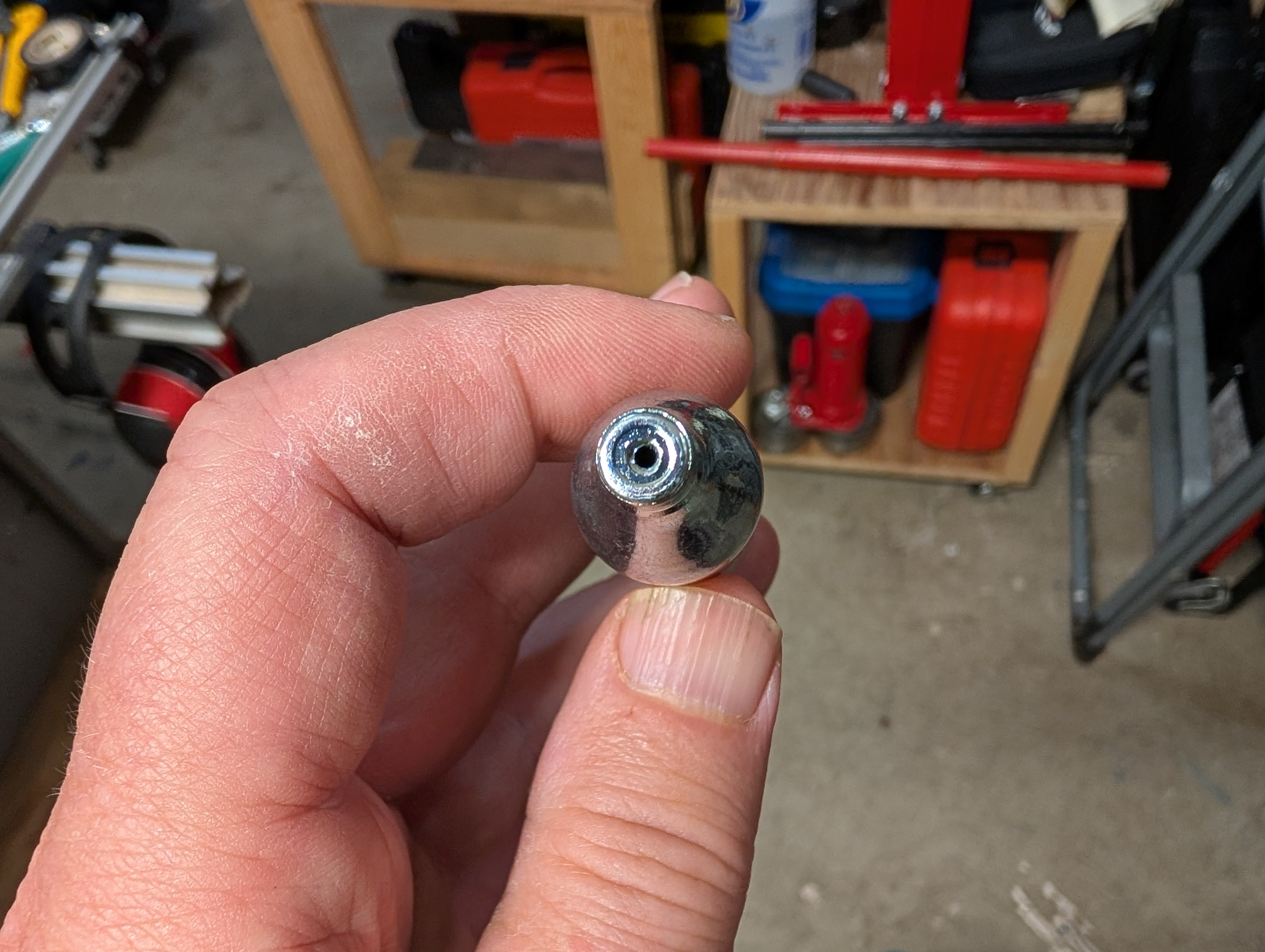

    Post a picture of the pierce on your 12gram. A shallow pierce can do weird things.

      Depends on the 12gram, too...Crosmans are chronically underfilled, my best shot count has been with Mosa 12grams (or Ico, you should be able to get those on the West Coast pretty easy).

          Like JeepDVLZ45 mentionned check a spent 12g puncture hole size. It should be a small needle size round hole.
            My P68sc does this. Is there a way to fix a shallow pierce? The pin barely will pop the 12g seal and it takes a half dozen dry fires to get it.
              JeepDVLZ45 commented
              There are a few things that could cause it.
              You might need a longer pierce pin, (or to sharpen your current one) but you can swap in a stiffer hammer spring or softer valve spring as well (depends on what you have available). It’s a lot of swap, test, swap test (it can be arduous)
              I had one that needed a “thinner” face seal as well.
              My shallow pierce would work OK in warmer weather, but it would freeze up if it was under 50*. (I’ll play with 12g most of the way through the winter)

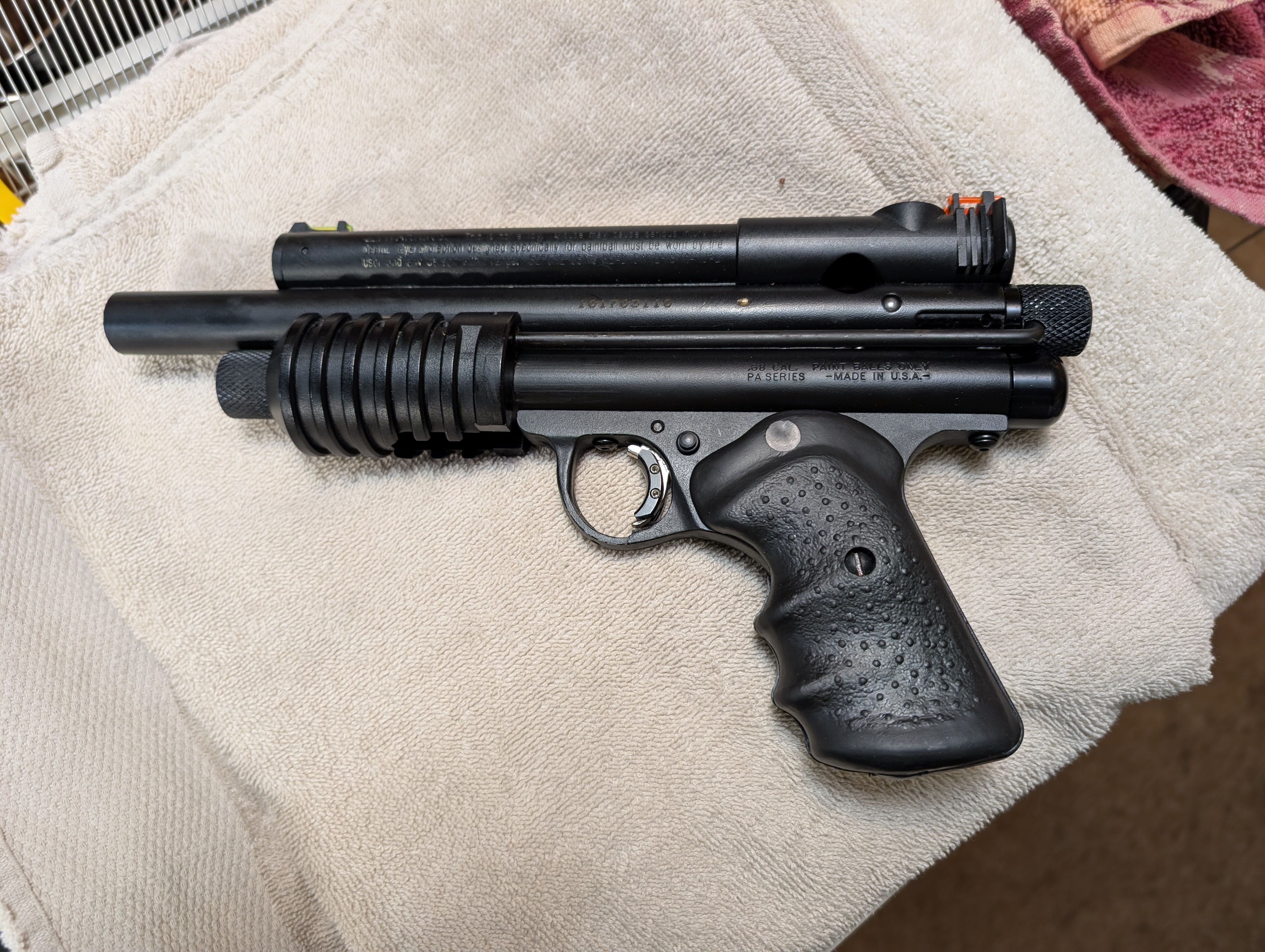

            By popular demand, here's a pic of the gun and the pierce. The pierce looks ok, but maybe too big? I'll try the other 12gram cartridges for sure, but I suspect something else is going on due to the steady drop in velocity after 3 or 4 shots. I'm going to order some face seals and a pierce pin from PGP junkies to see if that will make a difference.
              • 6401
              I would give it a good cleaning and Oil it. That thing looks super clean I bet it wasn’t used much. It might just need a lil break in time and a good cleaning.
              At 50* you will see a reduction in shot count but you should get better numbers and higher velocity. It’s likely that lower tube needs a good cleaning. Like others have said try different 12g too. Shooting slower helps the faster you shoot the less time co2 has to expand.
