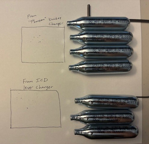

          I got some testers yesterday, 3/4/26, and...more metal shavings (picture below). I opened multiple cartridges, some with my Phantom bucket changer and some with an ICD lever changer just to make sure the problem wasn't from equipment. Leland is giving me a refund (did so with no hassle, so again, good customer service), but I guess I'll find another supplier.

            Unfortunately with co2 being an industrial gas this will occur....we have to order specifically bulk "food grade" co2 for our applications to avoid contaminants

              Have you tried any other marker? Long shot but maybe the shavings are coming from some other part of your system?
              Are the shavings magnetic?
              • SPSheep
                SPSheep commented
                The lever changer was never attached to the phantom at any point, so I'm pretty sure it's not from equipment. I'll try opening a few more and seeing if the shavings are magnetic.
