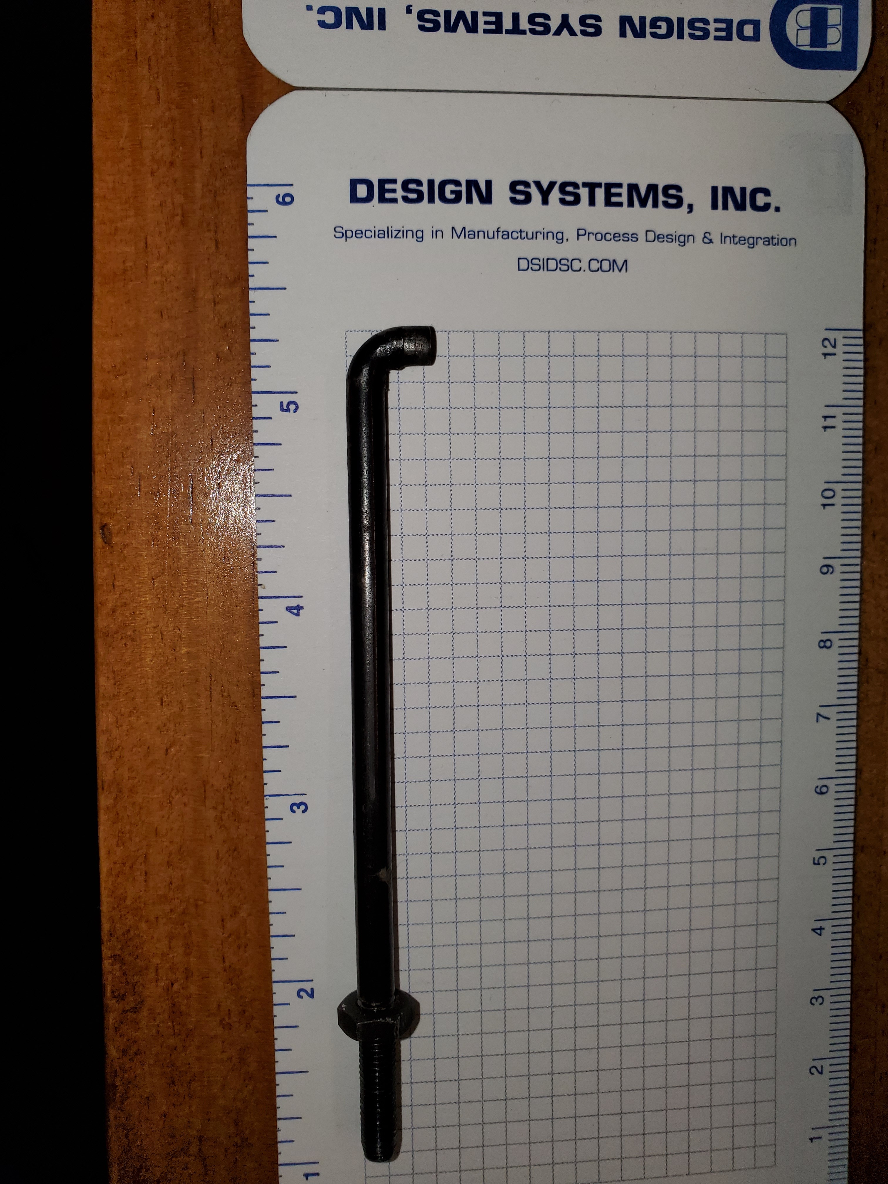

    In need of a pump rod, is there any reason this can't be made from a steel rod and than threaded?
  • flyweightnate
    • 1931
    • Dallas, TX

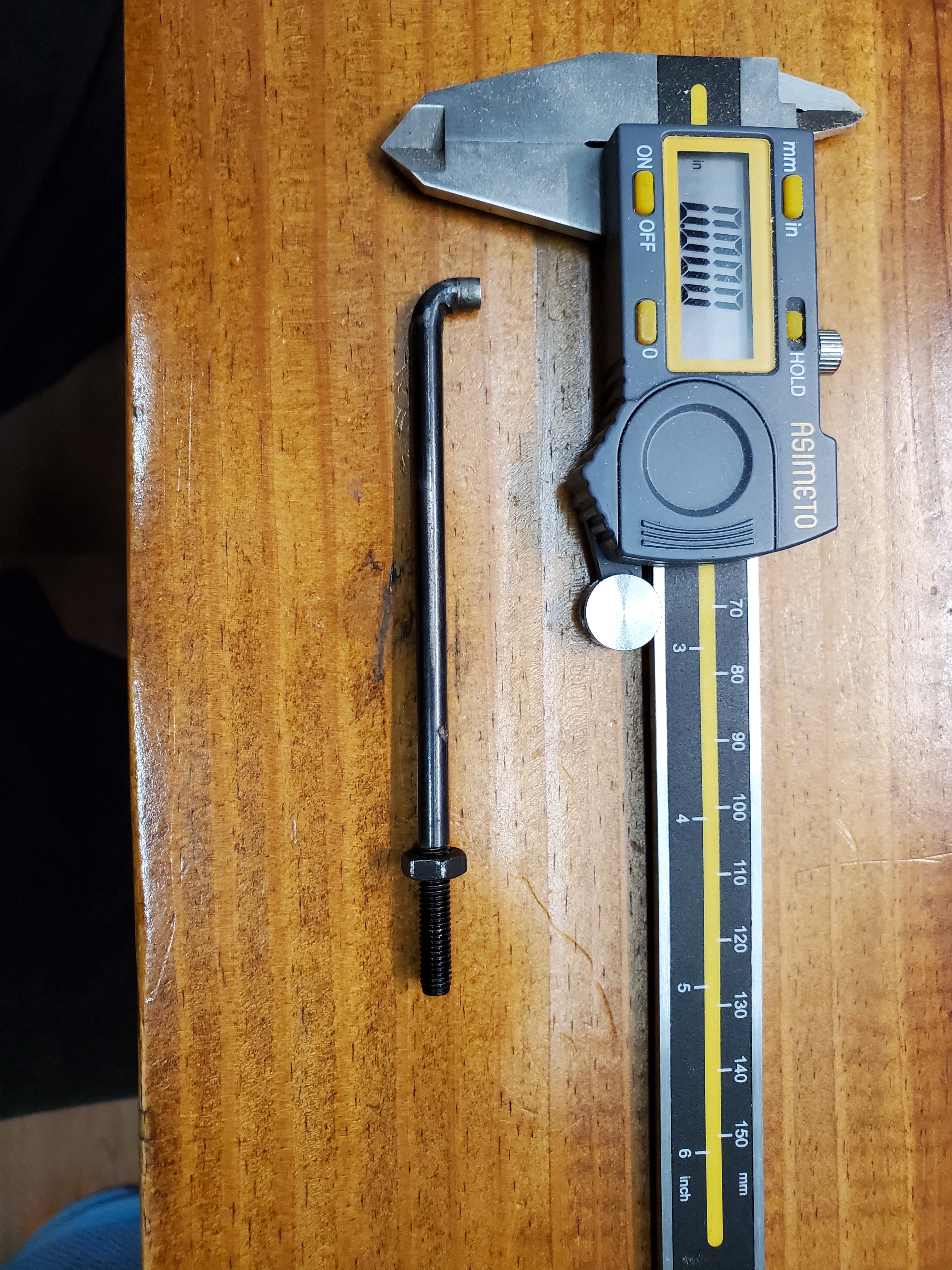

    Seems possible.
    Stock pump rod is .186 diameter, threaded 10-32 x .861" long, 4.15" overall length, .41" overall height. It's a "coined" bend (0 radius on the tight side).
    • Cal440
      Cal440 commented
      Thanks for the pictures and the extra effort of the measurements. I picked up a couple of phantom parts lot and am trying to piece it back together. Being this is my first phantom I am trying to figure it out what is all missing. Thanks again.
