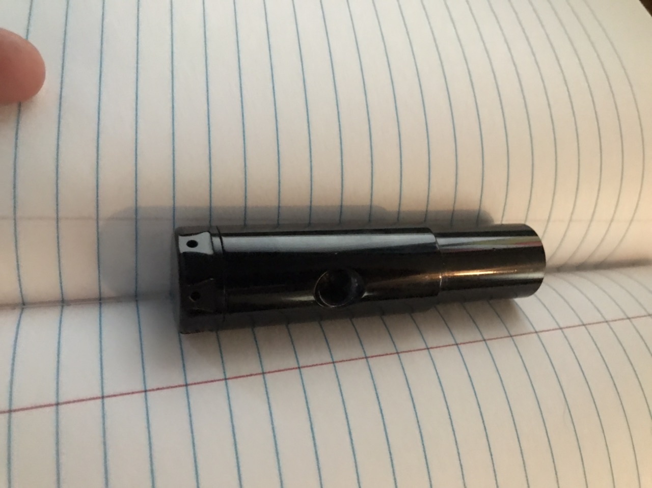

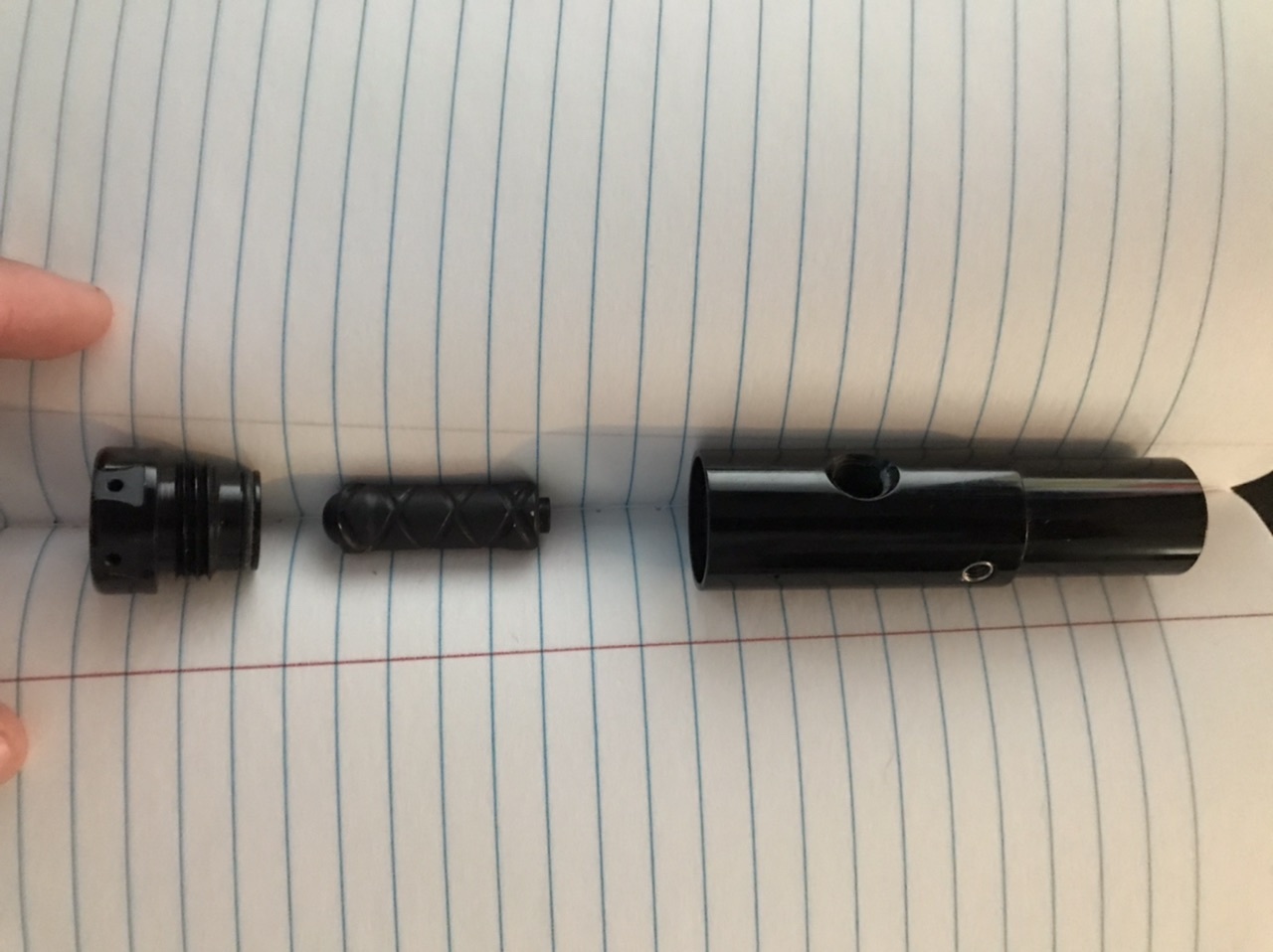

            • 6273
            I have a Gargoyle valve body just laying around I payed $85 its gloss black. Its got the devolumizzing piece as well that holds the spring. if you remove that it would increase the volume on the back side of the valve, you would just need to re spring the valve with a longer spring.
