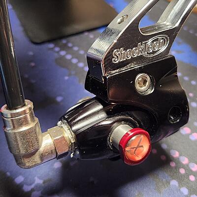

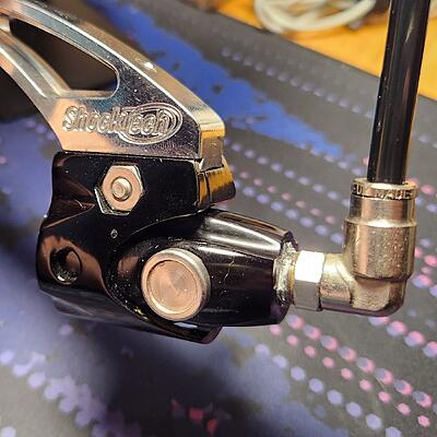

    Would someone mind helping me identify this On/Off ASA, please? I have been searching the internet but have not had any luck. The only marking on it is the one jewel with the "X" logo in it (assuming that is what it is, that might be leading my astray). It has a dovetail style mount. It discharges when the slide is moved to the off position.

    IMG_1429.png Definitely System X.. produced near the end of the company.. it’s a copy of the hybrid push button ASA, notorious for shredding orings

      The similarity is because System x and hybrid were designed by the same person.
    • 4288
    Agreed. System X.

      The logo in the jewel is definitely the System X logo. Thanks! I am doing more digging now.
