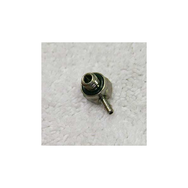

    Hello All,
    What is the oring size and durometer for a 90 Degree 10-32 1/16 barbed fitting (pneumadyne ELB10 i think is the actual part#) as pictured below:

    Oh man. I just ran into this like 2 weeks ago
    I want to say I used a 005 or maybe 007.
    Something in there worked anyway. Don't know if it was the "correct" one or not

      I use 1.5x3mm orings, same as on Ion banjo fittings.
      Tubing, depending on barb size:
      https://www.mcmaster.com/product/50315K68
      https://www.mcmaster.com/product/5648K67

        Definatly a 70 durometer. These are not normally holding high pressure
