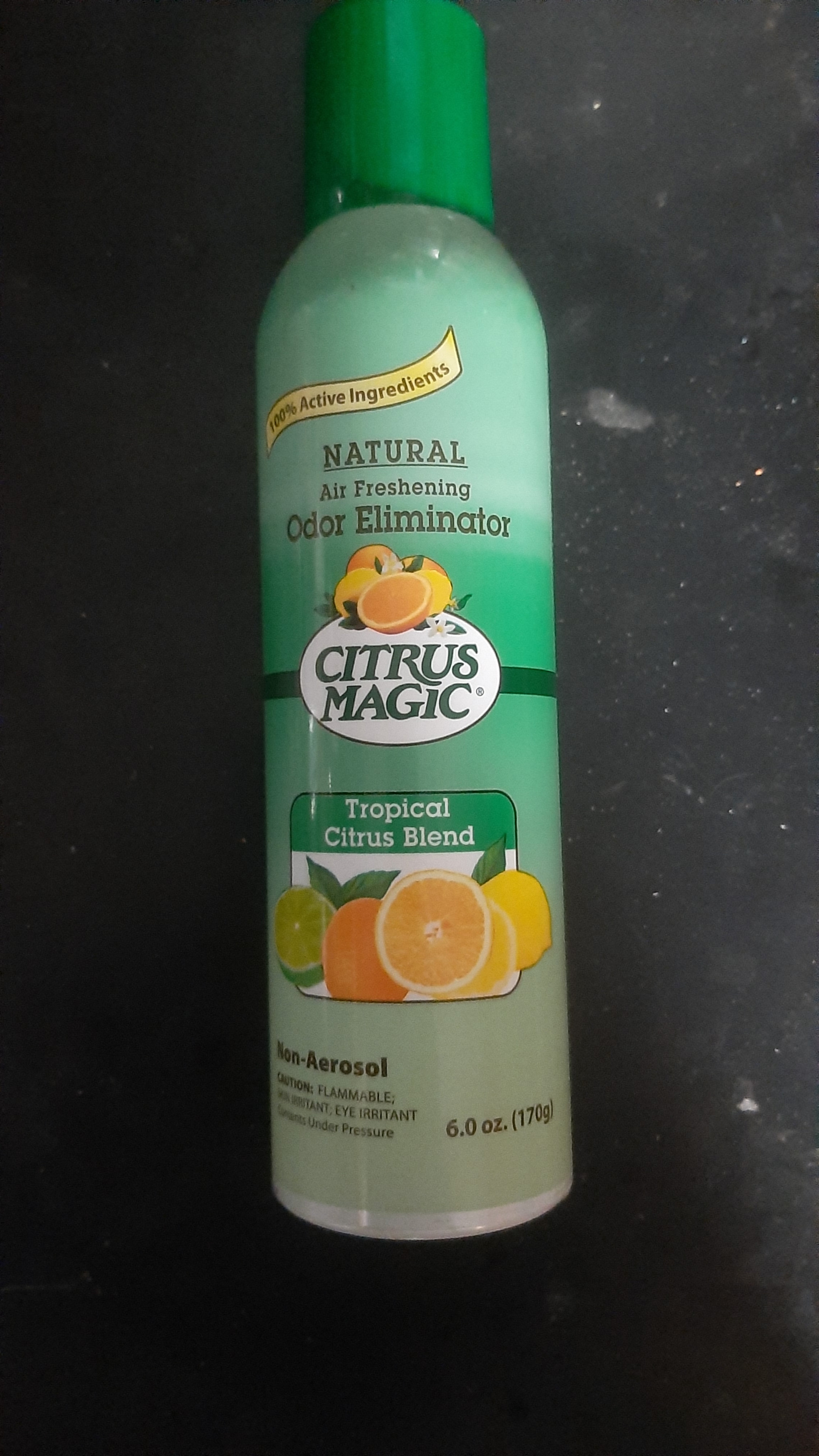

      Alwaya had the best luck with this, but i wouldnt be against some fine steel wool on a stick
