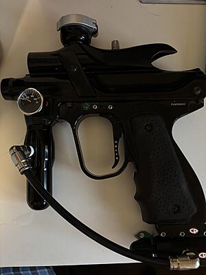

    ICD promaster reg seal
    I have what I believe to be an ICD bushmaster (but please correct me if I'm wrong) ( I was wrong looks like its a promaster?) with what I believe to be are all original components (minus the CP asa).
    The reg seal on both the hpr and lpr was just absolutely disentegrated. A manual I found online called these part no 952032. (This doesn't matter because it's the manual for the wrong gun, which explains why things looked a little different...)
    I found this Bob long ICD bushmaster reg seal but it looks pretty different from what we could piece together the originals were. Mostly the difference being that the ones coming from the gun seemed more hollow, with a wider center, than these. Does anyone know if the items on this link work for my regulators? If these don't, is there anywhere I could look for the part I'm looking for?

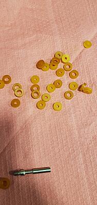

    I made some reg seats and cup seals a few years ago, if you need any
    • tygersrule
      tygersrule commented
      Yes, thatd be awesome! Did you 3d print them? I think, based on what the tech I was working with said, I need two reg seals and the cup seal. I dont think I can PM yet but if you message me, I'd love to set this up!
    • Araphel
      Araphel commented
      They're laser cut urethane.
