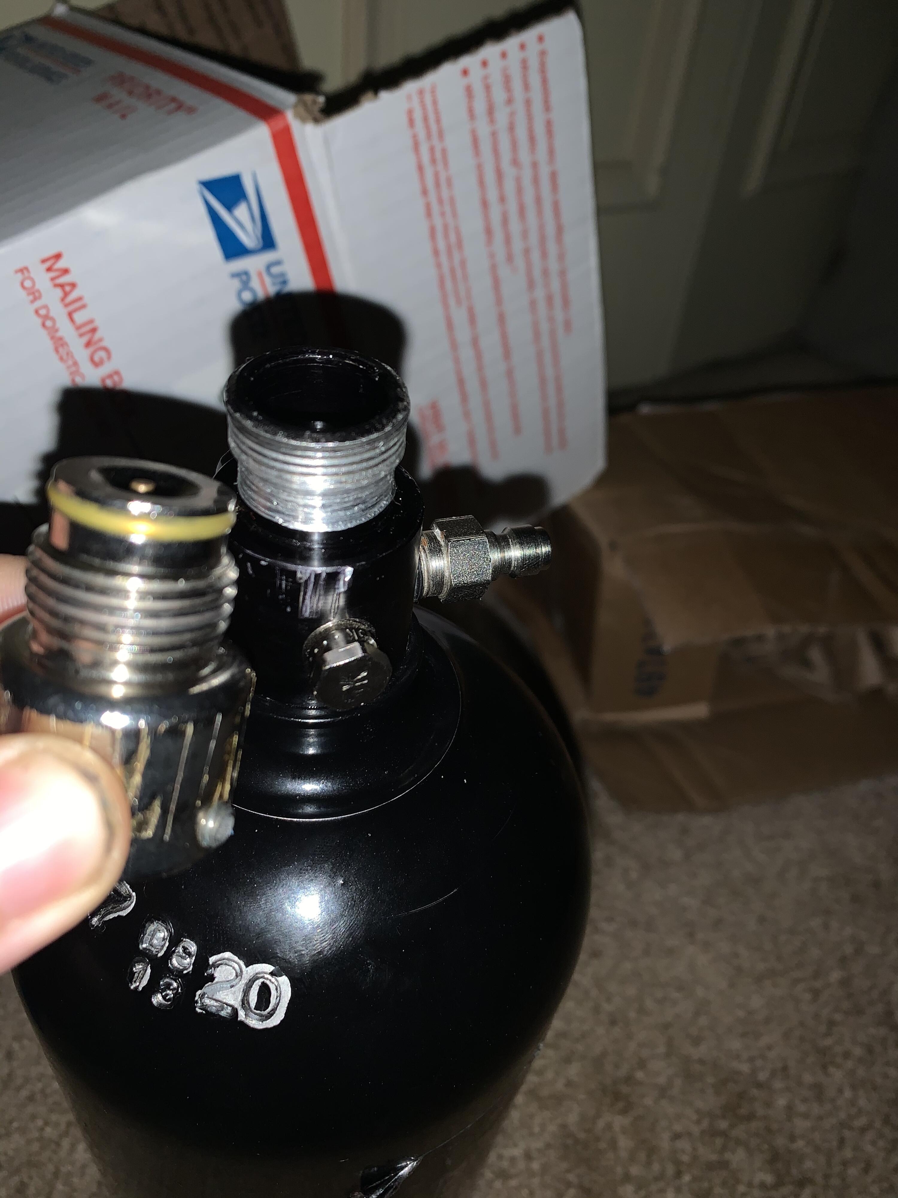

Reg stuck in tank help
  • MrKittyCatMeowFace
    • 2378
    Would of pulled the bench and vice over if we pulled any harder. The guys on the discord think they put a thread locker or super glue on it. Really want to save the bottle. Was my walzmas gift from nobbie333

    Heat is your friend

      Originally posted by Bulldogr6
      Heat is your friend
      Sent from my E6910 using Tapatalk
      Wont it ruin the annealing of the aluminum?

        At this point pipe wrench that sucker off.
          Yeah i guess. If its not siezed, it should break loose. And if it is siezed than the bottle is dead. .

            Heat it a lil bit and crank it off. It will break loose or rip the threads out of the tank. It’s probably Red locktite the Devils sauce...

              Don't go crazy with the heat , just enough to soften the loc tite

                Put it in a tub of hot water for 10 minutes then strap wrench. Worked for me on a few tanks.

                  "Heat" like a heat gun or a good hair dryer on high. I've used a propane torch before, but I paid close attention that I wasn't overheating the tank.
                  Pipe wrench isn't a bad idea if the reg is already ruined (remove the burst disc, gauge and fill nipple first, of course) but keep in mind that if you can't physically remove the reg (IE, loosen the loctite first) it's all to easy to just shear the threads off the reg, leaving them stuck in the bottle.
                  I have managed to save a couple bottles so plugged, but it's usually not worth the time and effort.

                    red loctite comes off at 500F according to their website.
                    Heat, and patience. keep working at it and take your time.
