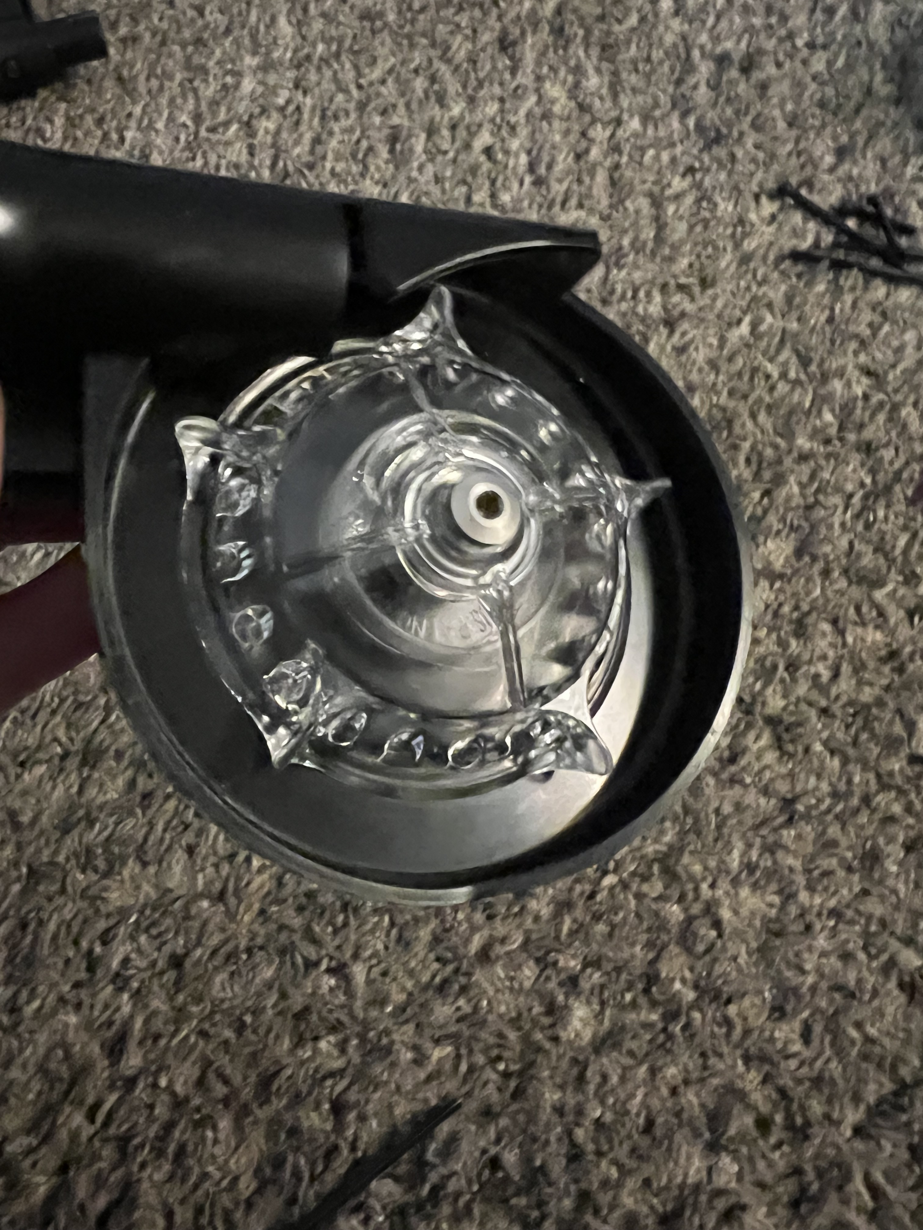

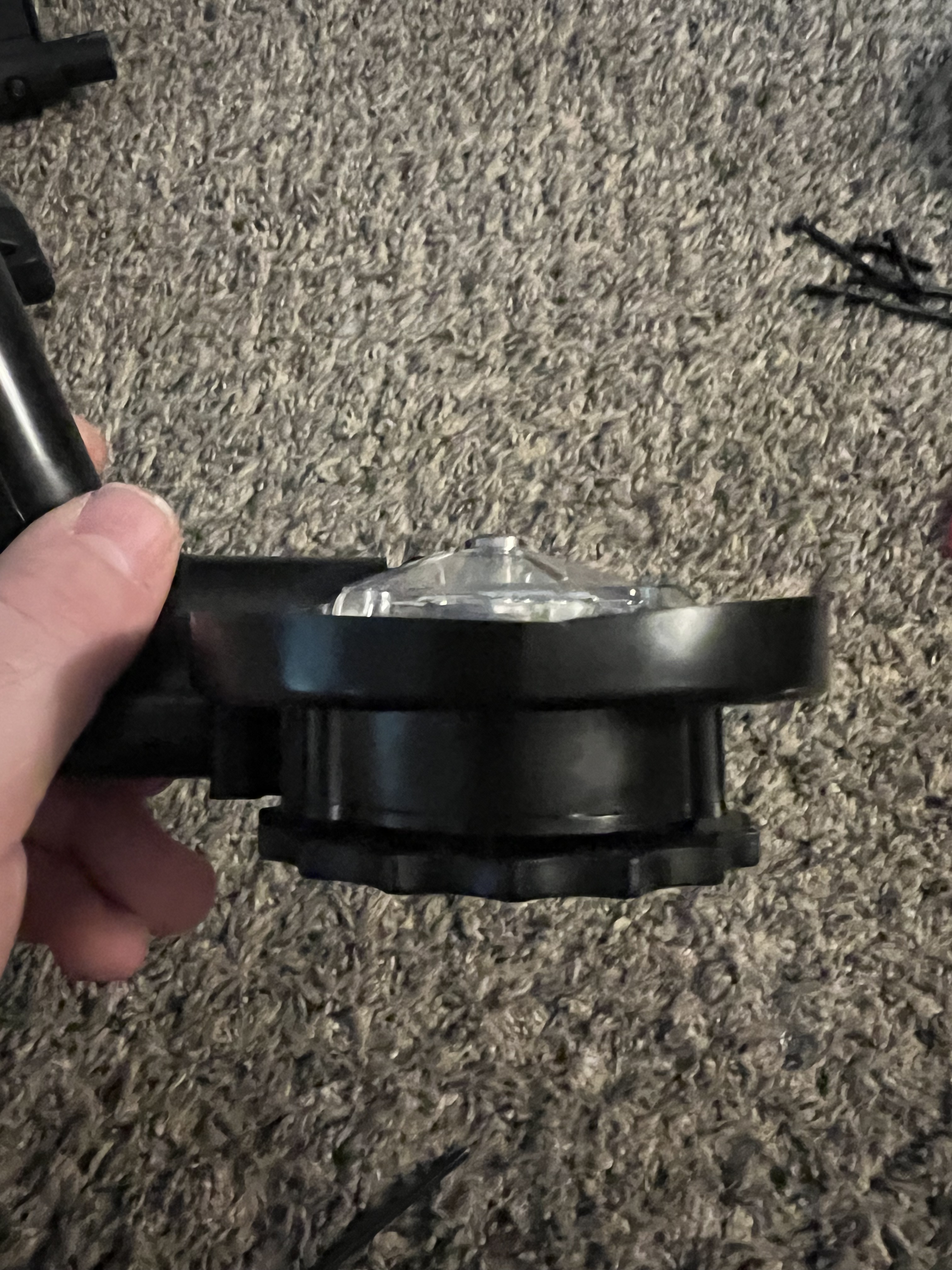

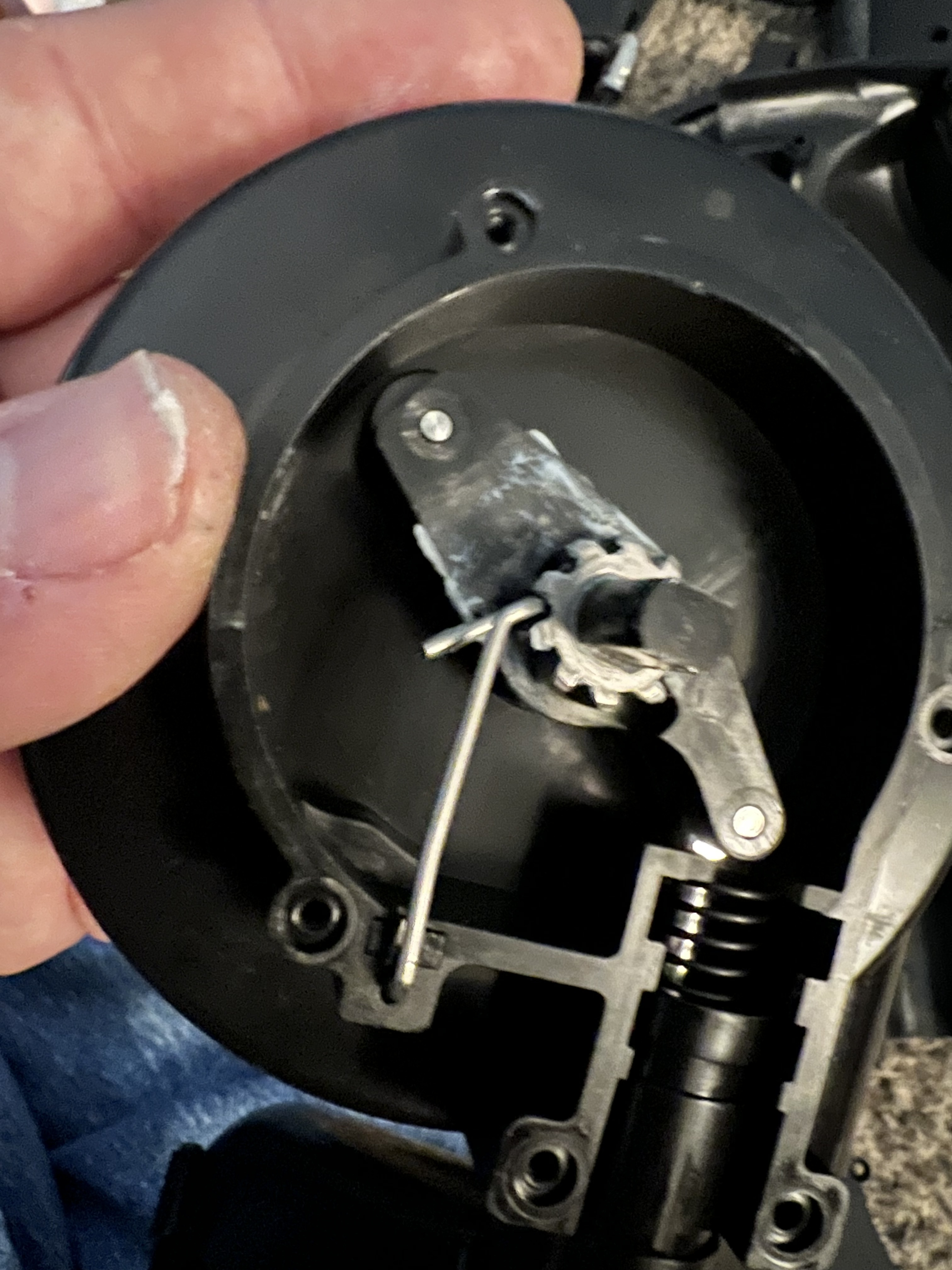

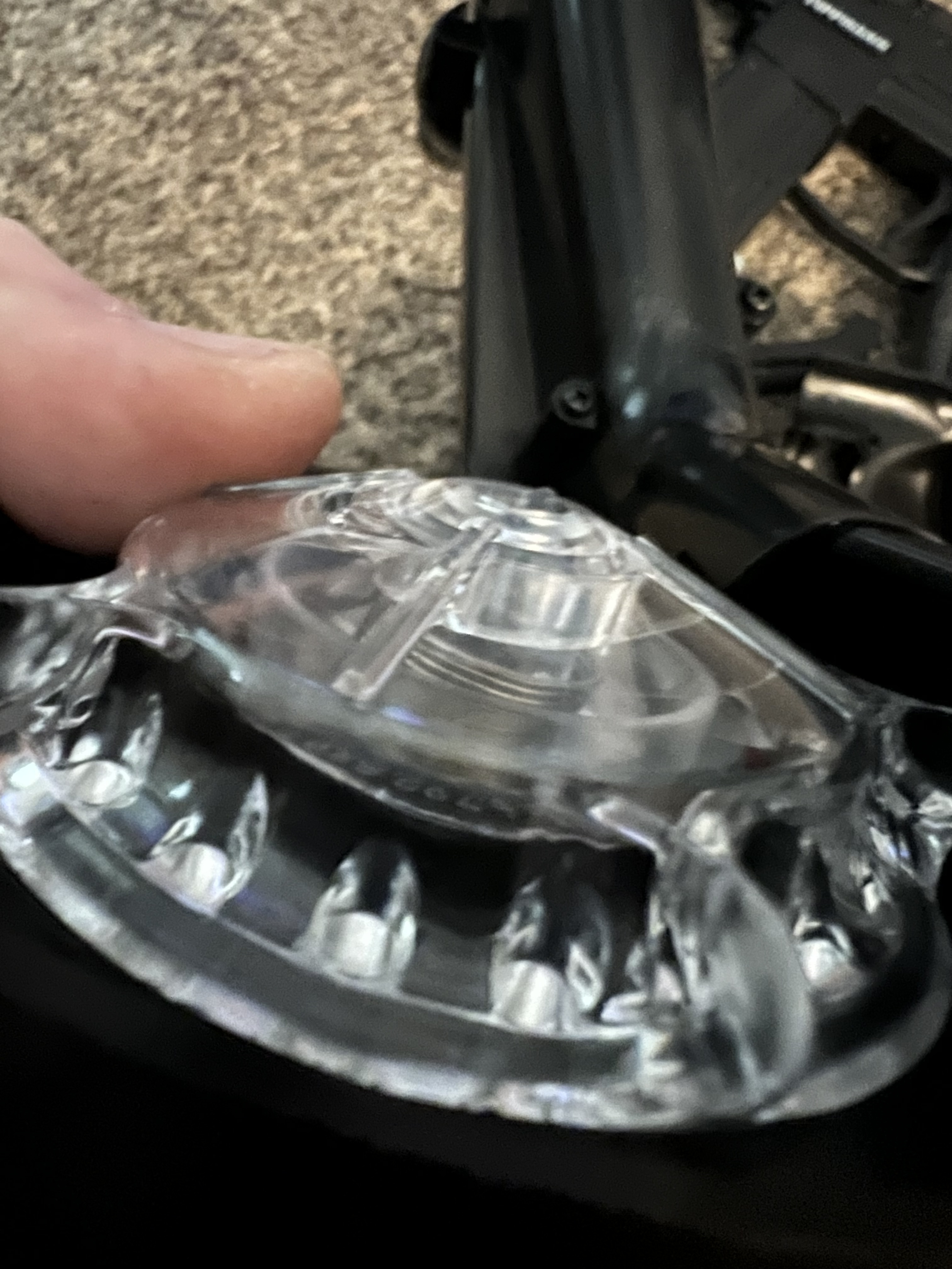

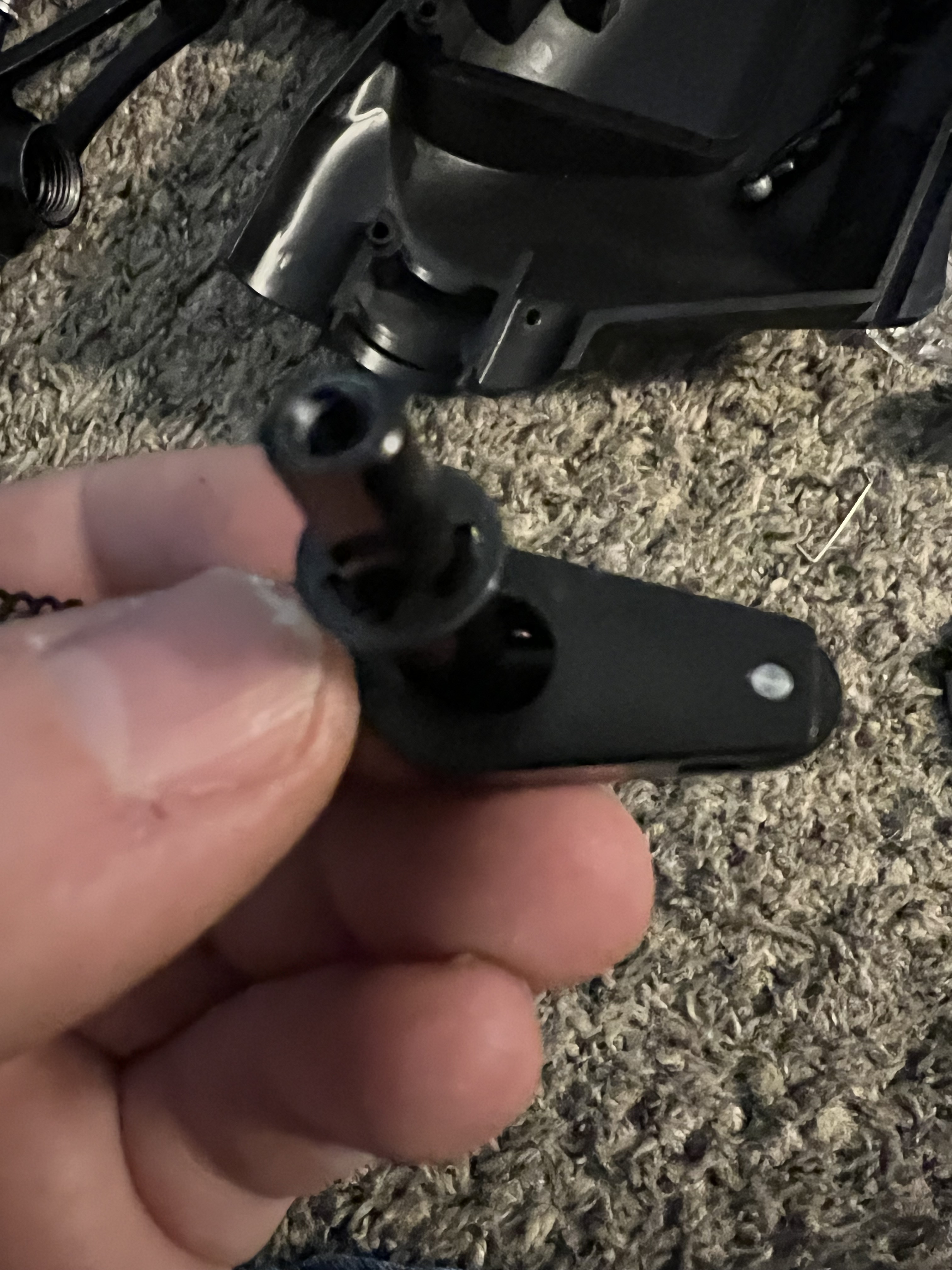

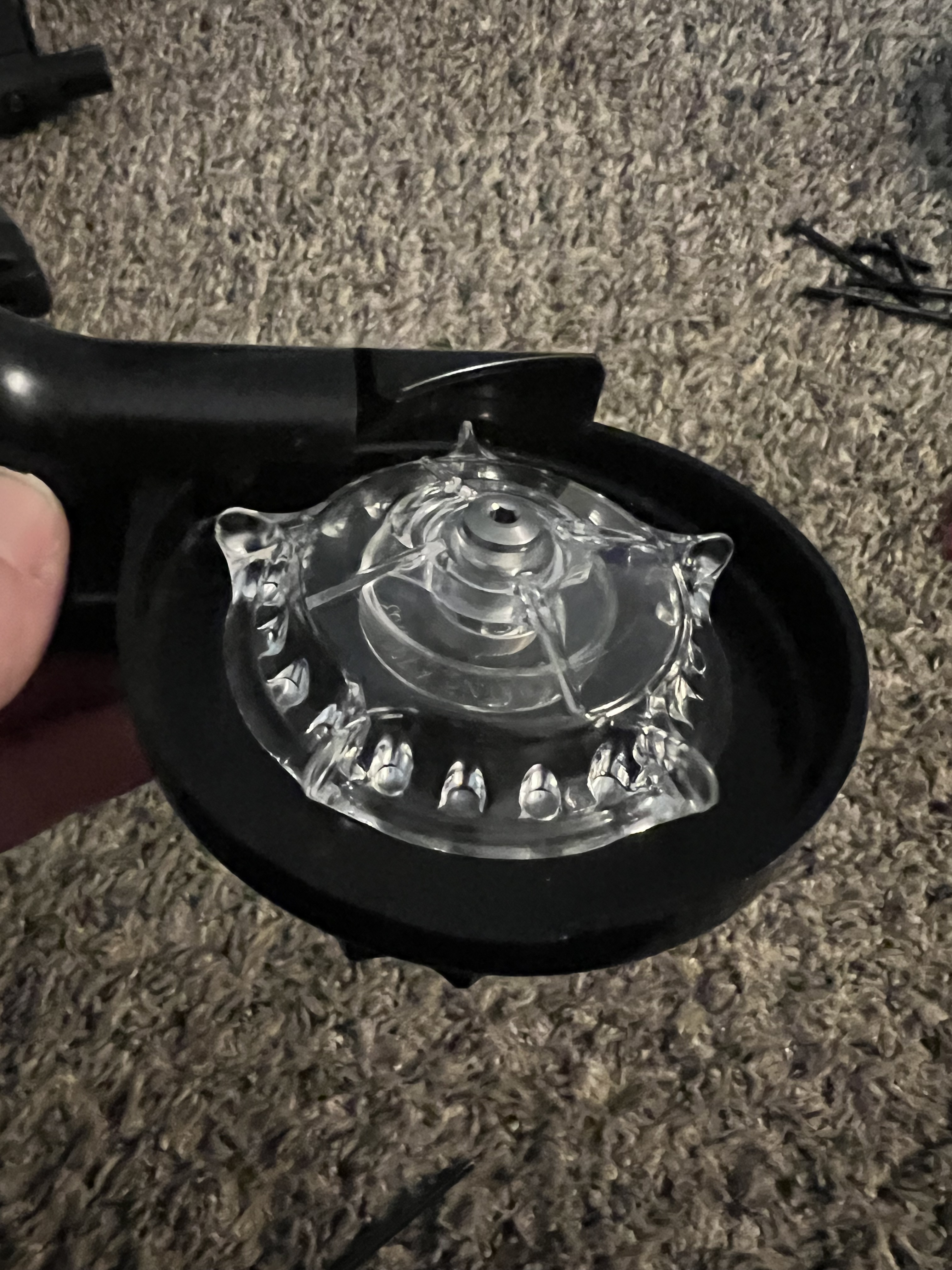

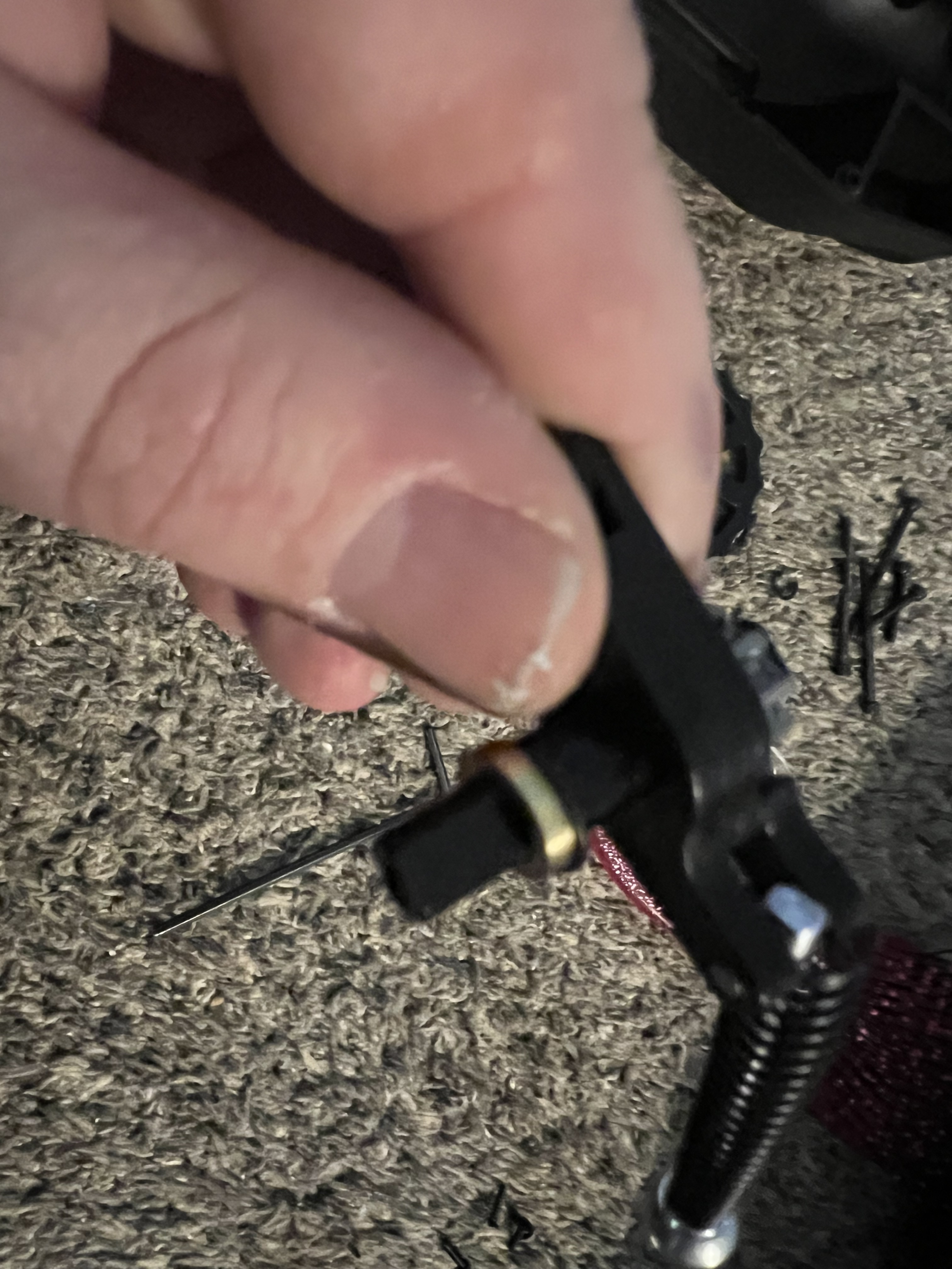

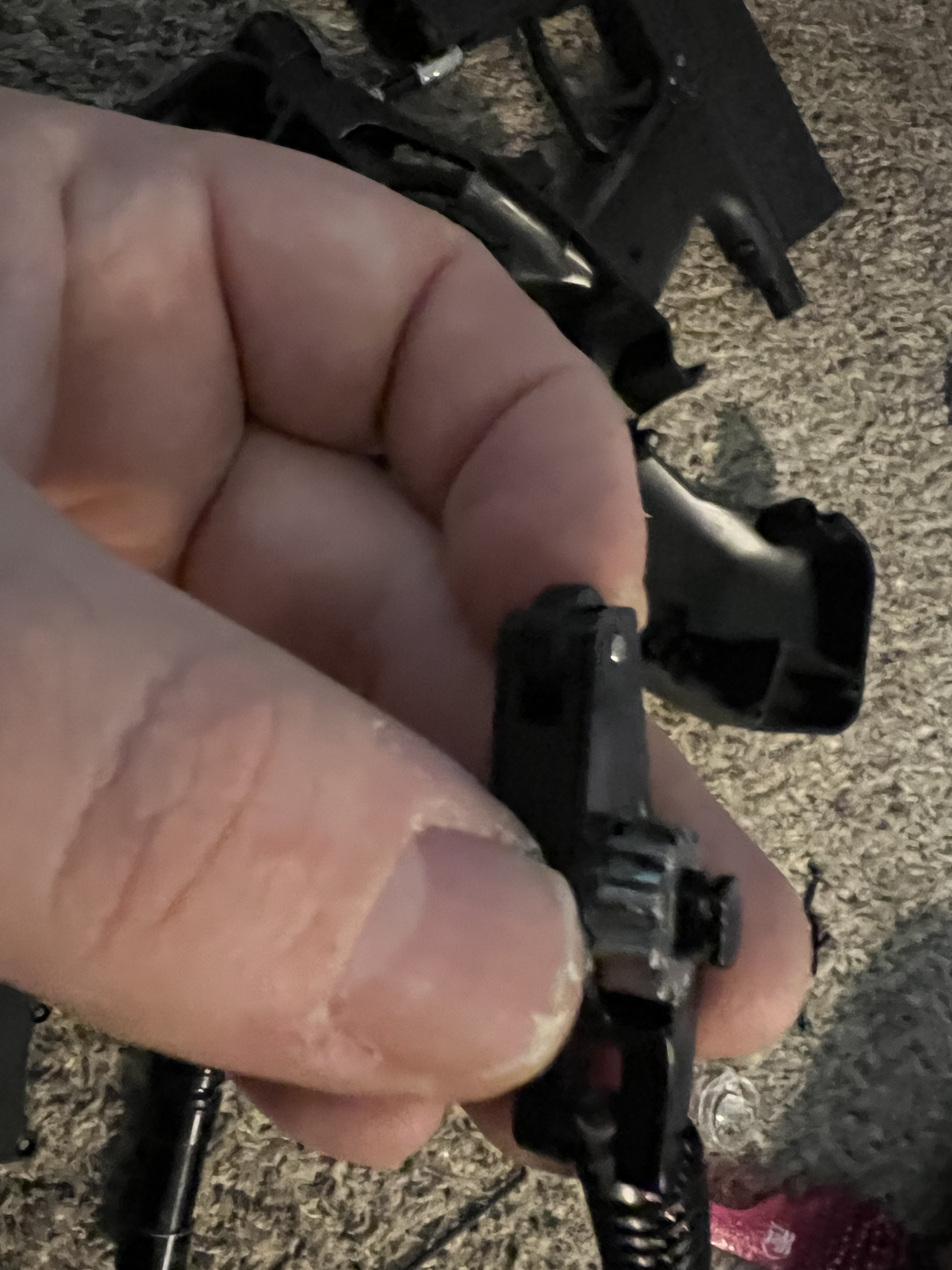

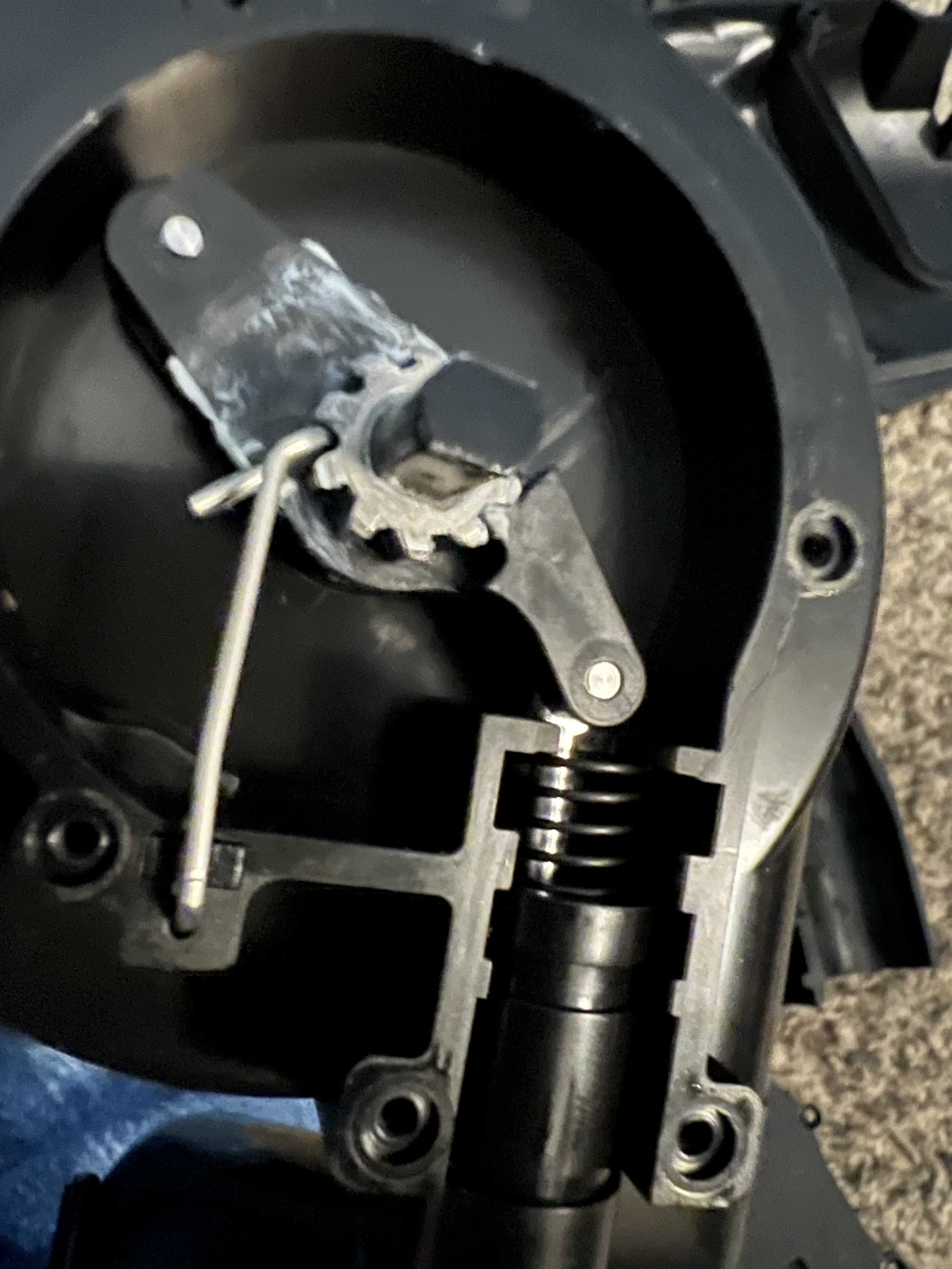

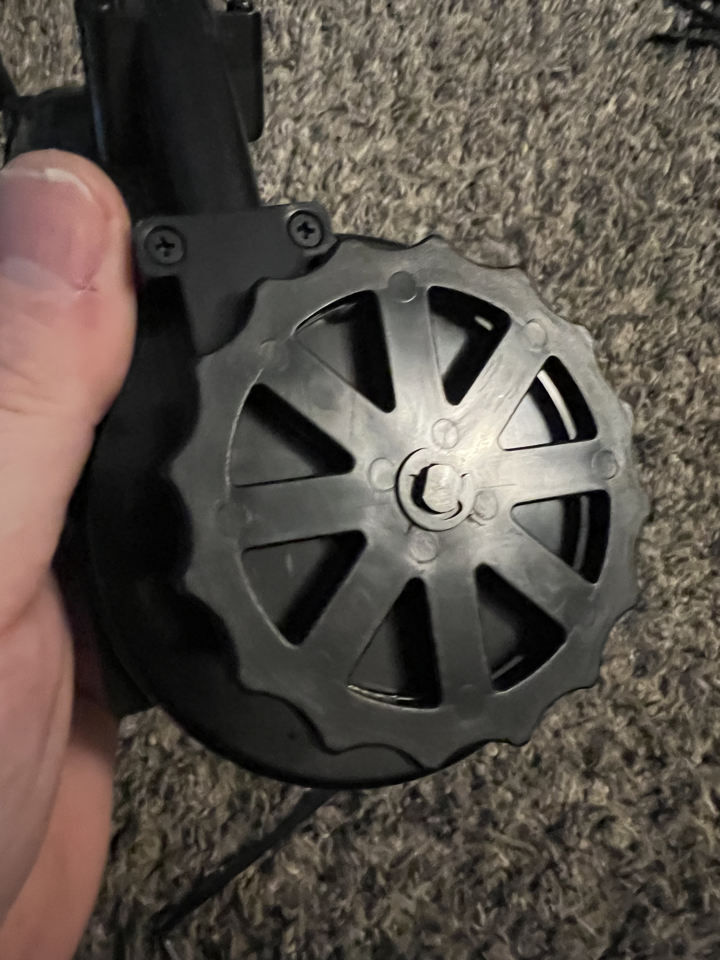

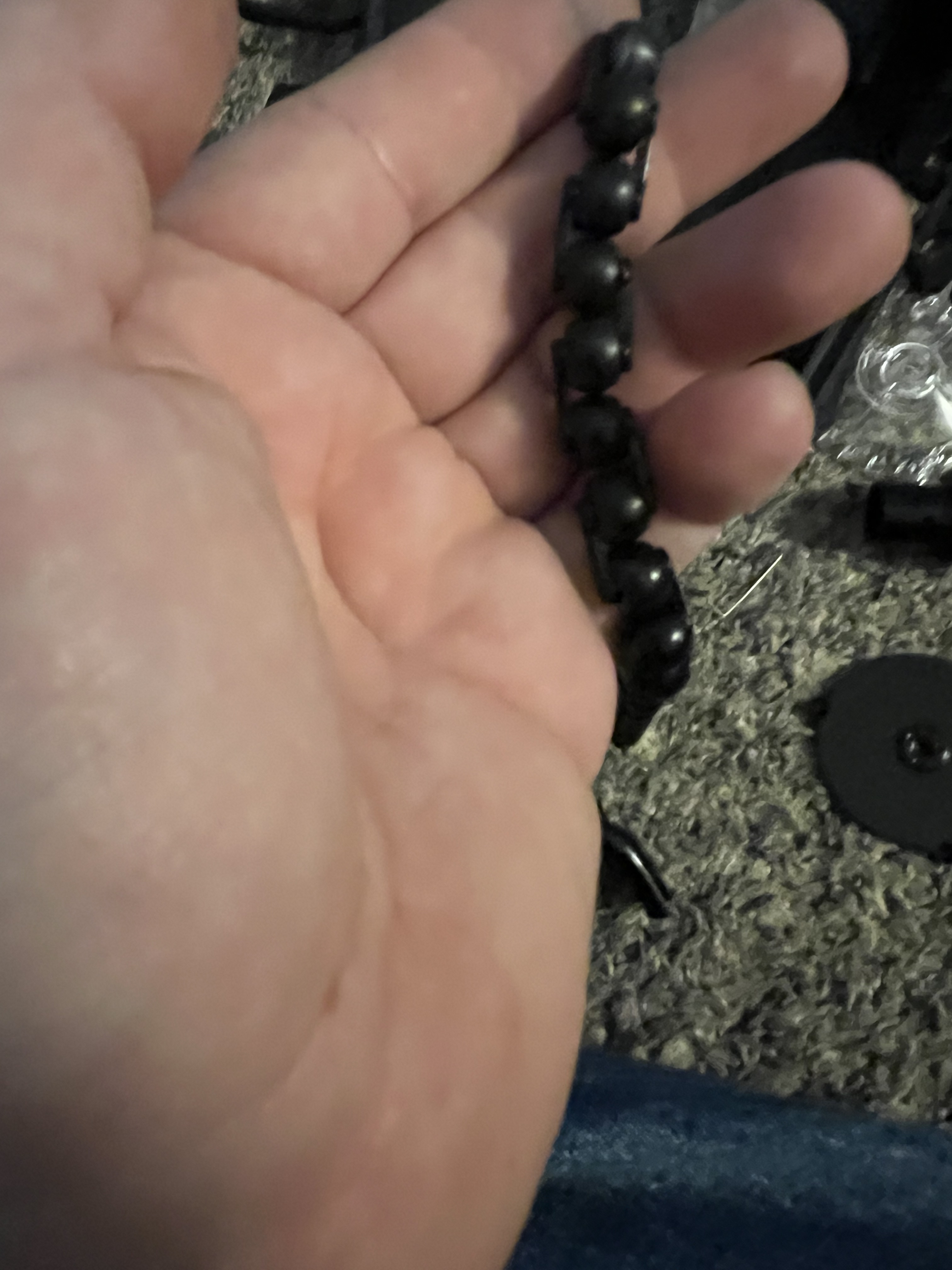

    Finishing up some other projects so I’m starting to work on this again. I realized I had never inspected the internals of the hopper. It looks like a Halo B/Cyclone hybrid. Figured I share if anyone was interested.

    It’s also got me thinking….. if the Halo B and Cyclone can obviously be combined what’s stopping me from doing this to a standard Cyclone on a A5 or 98….
    Replace the paddles with a cone and place beads in the piston housing that are magnetized to the feed piston instead of using a spring. I know the beads are being actuated by the bolt on the Raider but wouldn’t the burst of blowback gases be enough to actuate it on a A5? It would need a a transfer tube, I think, inside the housing. That way the air is directly placed and dispersed at the beads. Just thinking out loud though. I’m still trying to figure it out
