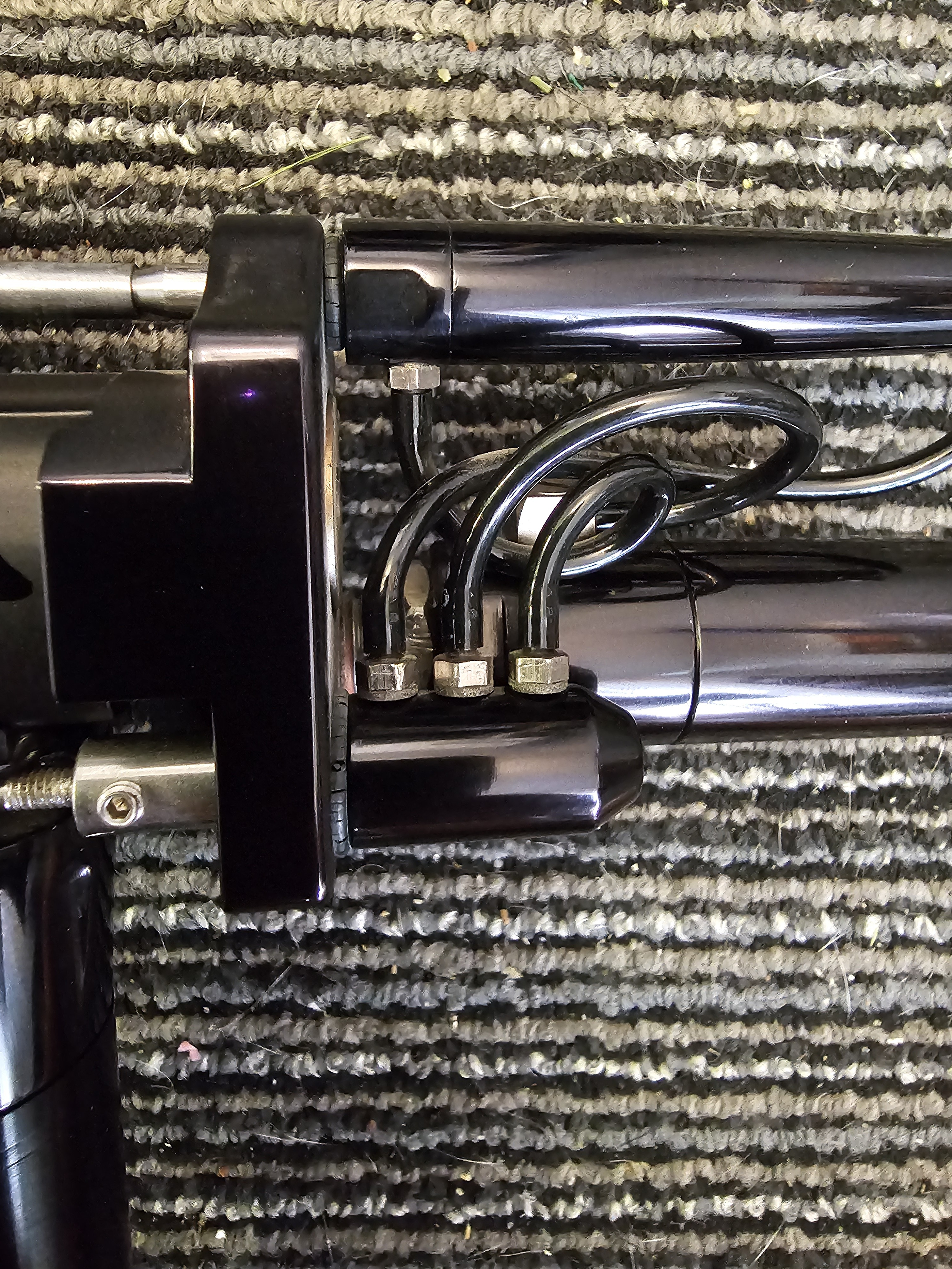

    Im after a good 3way (shhh you heathens)
    I picked up a deuce and its got a 3 way leak, the current i believe is a ccm. I cant find a reference as to what size rings they take so I was considering buying something thats still supported or info for oring ID. What would be a good replacement or should I keep the current on-board unit?

    keep the current unit. looking at the shape of the orings on the outside my guess is a top to bottom re-build. 3 way leaks, I learned the very hard and frustrating way, are not always an issue with the 3 way itself. they are often bad seals in the RAM, or related to LPR pressure. I had to completely re-build my "brand new" inception front end before my 3 way leak finally got resolved. no reason to screw with that sexy set-up. get your tools,o-ring kit and bucket of lube - its 3 way time!

      as a test the 3way still sounds leaky when the LPR is turned way down.

    CCM 3-way uses 003 70 durometer, basically the standard for WGP style 3-ways.
    CCM are sometimes leaky, especially at lower pressures.

      That's a good 3 way (giggity) just swap the orings out

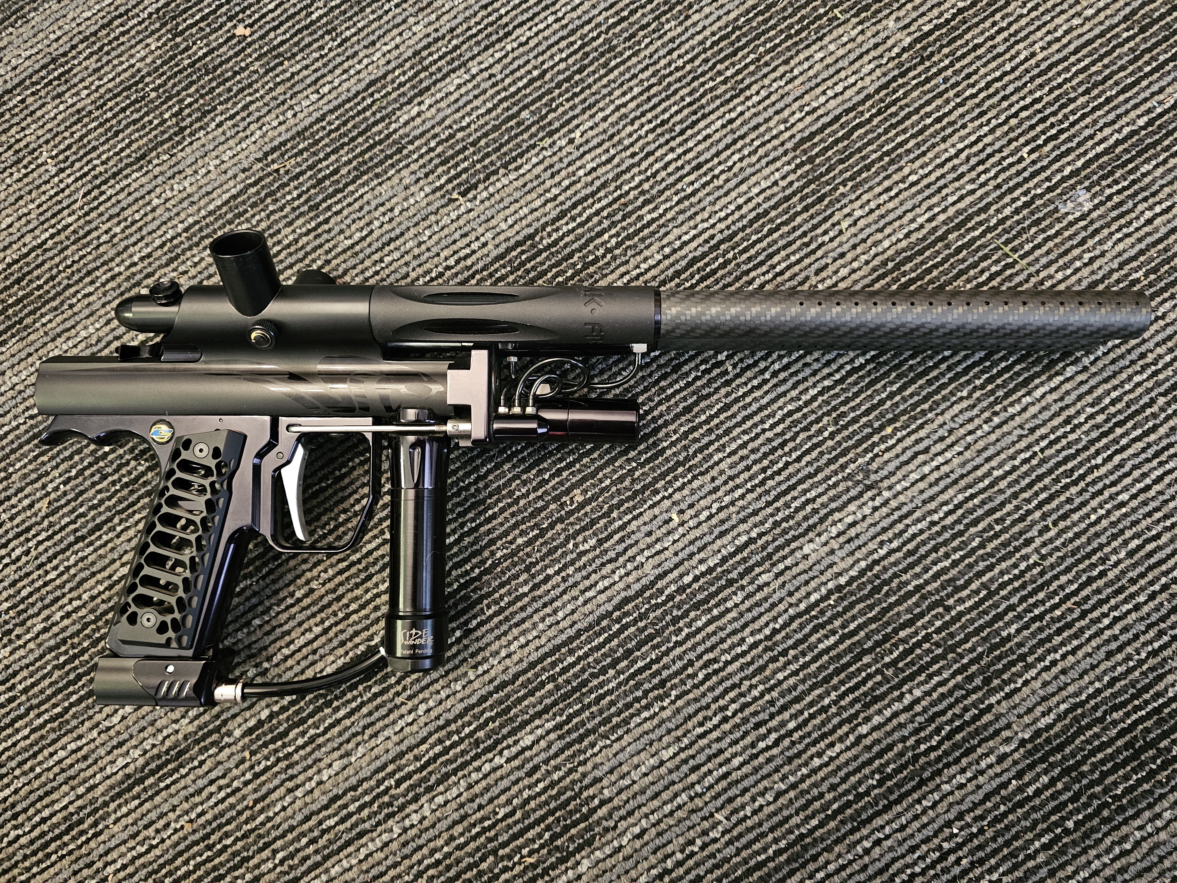

          It was listed earlier in the summer as well. I jad watched it hoping that someone would snatch it up.
          After it was relisted i kept watching knowing i really shouldnt keep watching it. Anyway, here we are.
          this feels like it weighs half of what my Vee Twin does. I really ought to weigh them. And also I was unsure abount the cobra detail but it fits and feels at place. Ken made a masterpiece with this.
