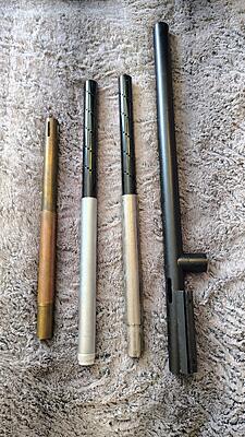

ID pump body and AA barrels and brass barrel
  • muyosn
    • 33
    2 AA barrels and a brassy, Brassy might be an old lapco, not sure. looking for ID of threads, and ofcourse the lack of
    Pump body no marks looking for ID

    My hunches are...
    AA barrel with teflon tape on the threads could be for VM68 and Bruizer.
    Pump body could be a TASO/AGS (adventure game supply) single handle. The luster is flat/matte finish which is different from the semi-gloss found on nelson clones (such as Outlaws) that came out afterwards. I don't see threaded holes in the back, for attachment to the air source body, which are often found later nelson clones. I think only Outlaws and TASO/AGS produced single body, fixed barrel, single arm. And the height of the 3/8" dovetail looks like an TASO/AGS product, as Outlaws were a bit lower.
    AA barrel and brass (looks like J&J) might be for F2 Illustrator or TASO Typhoon pump. Do you see any markings, such as screw indentation, along the non-threaded section?

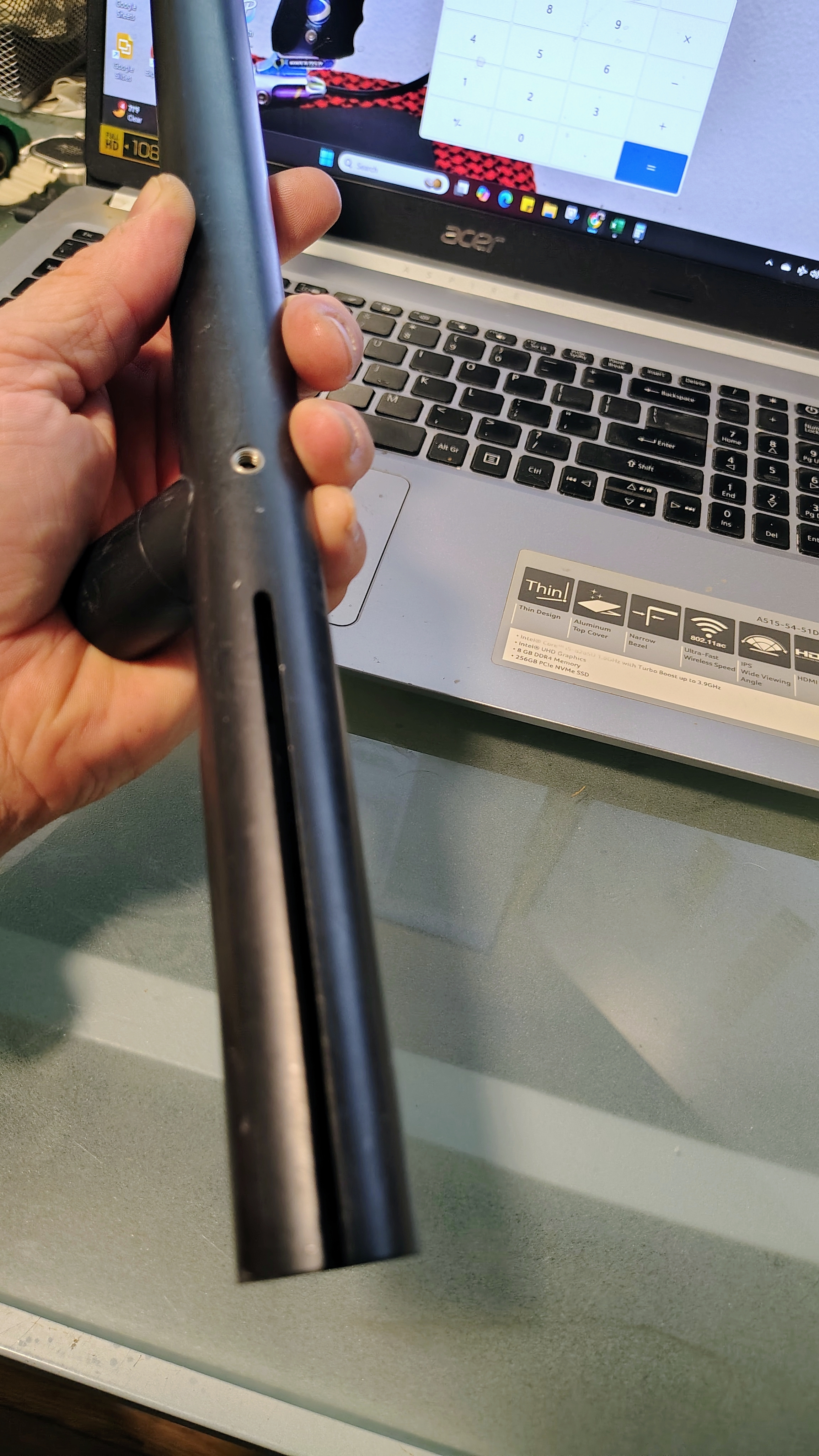

      added a pic of the bottom

    That brassy barrel is an old J&J sl68 barrel if I had to guess. I've got one. It should have 4x straight rifled flutes in it. They are a huge bore.
    • muyosn
      muyosn commented
      its smooth actually, but i do have a straight rifle Jnj for a cocker
    • 4408
    Lapco never made brass barrels.
    That's a J&j
    • muyosn
      muyosn commented
      AH, yup you be right, its been a while. I have another jnj for my cocker not that i think about it. Straight rifled too lol

    hey, I've got one of those AA barrels but with red anodizing instead of black

      IMG_20250902_202204827_HDR_AE.jpg Under view of the pump body
